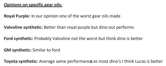

    ^ the Toyota LSD calls for dino oil. I also run Lucas in mine.
    Somebody posted some test results that didn't go well for royal purple (or Lucas Synthetic) but I don't know how much those tests relate to real world use. Those tests favored Valvoline and Mobil did okay.

    I ran Royal Purple in my front Diff and T Case for a few years without issue but they specifically called it out as the worst.

    I've never been a fan of them, mostly because I think the purple is a gimmick, but to be fair I never used it either.
    Not the same results posted before, this is data from Amsoil so possibly biased. I guess I'm confusing valvoline for Castrol, but Royal and Lucas did pretty bad here. Again, not sure how much this data relates to real use.

    @CodyP I'm sure running R.P won't hurt anything for a while. I would just make a point to use something else next time. They said the best approach is to just change the fluids regularly.
