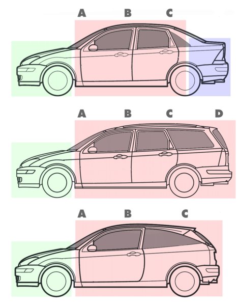

    What is a B-pillar?

    I am not sure if you are giving me a hard time... but I'll bite.
    The B-pillar is the vertical structure at the end of the front door and what the rear door hinges mount to.

    Not giving you a hard time, never heard the term before honestly, I just called it the door jam , yes, those numbers listed are what, like 30 in front 33 in rear? IDK, My logic leads me to believe I will get better mileage with more air in tires, so I bumped up to 42, who knows..

    And here's a picture!

    A, B, C & D pillars are the official Toyota names front to back. You may get more mileage but you'll wear out the center on the tire out faster.
