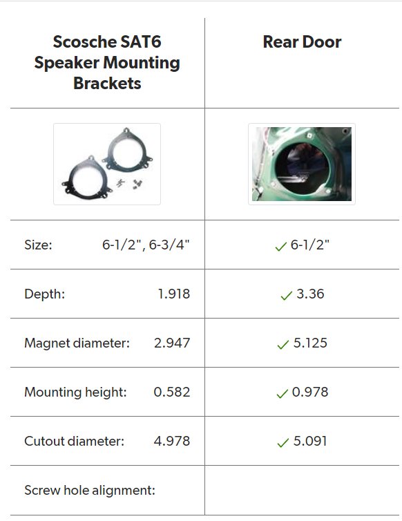

    Using 3 ohm or 4 ohm speakers will not hurt your amplifier at all. Depending on the sensitivity of the OEM speakers compared to aftermarket, you might not notice much of a volume difference using 3 or 4 ohm speakers. Generally speaking however, using speakers of a higher impedance will result in quieter output from them. As an example, let's say your current speakers draw 100 watts at 2 ohms. If you replace them with a speaker that has the same sensitivity rating, but is 3 ohms, your amp will probably only supply ~75 watts of power to them. With a 4 ohm speaker, your amp will only supply ~50 watts. Going from a 2 to 4 ohm speaker will likely make them sound half as loud. Going from 2 ohms to 3 ohms will make them sound ~75% as loud and you probably won't notice a difference, especially since they are your rear speakers. Like Shifty said above, Crutchfield has a number or 3 ohm options. 2 ohm options however are few and far between unless you're looking to drop some serious coin. I did take a peek on Sonic Electronix and they have a couple of 2 ohm options not offered by Crutchfield (although they are out of stock at the moment). According to them, the "JBL GX628" are a 6 1/2" coaxial pair that will fit in your rear doors. Amazon has a seller listing them for the same price as Sonic Electronix ($75 a pair). I'll link them below with everything else.
    Only downside to ordering these is that you'd have to spend a little extra to get the appropriate speaker mounting rings and speaker wire harness adapters that Crutchfield includes with theirs for free. On that note, for whatever reason speakers like the Infinity Primus 603F and the JBL Concert 621F don't show up when searching by your vehicle. The JBL's are $70 and the Infinity's are $80. Looking at their mounting specs etc. it looks like both pairs should fit, not sure why they don't show up when searching by your vehicle, and as a result, if you add them to your cart they won't have the free mounting rings and wire harness adapters. I would chat with a Crutchfield agent and see what they can do as one of those pairs would be your cheapest option, although both pairs operate at 3 ohms so again, you'd be getting ~75% volume out of them as opposed to the pair I linked above which are 2 ohm, but would require you to purchase the mounting rings and wire harness adapters separately which would add an additional ~$25. If you chat with an agent you might be able to finaggle ordering one of the 3 ohm JBL or Infinity pairs and get them to include the speaker adapter brackets and the wire harness adapters for free.
    Links to everything:
    2 Ohm JBL $75 (need to buy speaker adapter brackets and wire harness adapters separately if ordering these ones): Amazon.com: JBL GX628 GX Series 6.5" 180W Peak Power 2-Way Coaxial Car Loudspeakers (Pair) : Everything Else
    Rear Door Adapter Brackets $15 (per Crutchfield): Amazon.com: Scosche Compatible with Select 2010 to 2012 Lexus, 2004 to 2016 Scion, 2013 to 2018 Subaru & 2000 to 2019 Toyota Vehicles 5.25" - 6.5" Speaker Adapters (1 Pair) SAT6 : Electronics
    Wire Harness Adapters $10 (per Crutchfield): Amazon.com: Metra 72-8104 Speaker Connector for Select Toyota Vehicles, MULTI COLOR : Everything Else
    3 Ohm JBL 2-way $70 (would include adapter brackets and wire harnesses for free from Crutchfield if agent can do it): JBL 621F Concert Series 6-1/2" 2-way car speakers at Crutchfield
    3 Ohm Infinity 2-way $80 (would include adapter brackets and wire harnesses for free from Crutchfield if agent can do it): Infinity Primus 603F Primus Series 6-1/2" 2-way car speakers at Crutchfield
    3 Ohm JBL 3-way $80 (would include adapter brackets and wire harnesses for free from Crutchfield if agent can do it): JBL 631 Concert Series 6-1/2" 3-way car speakers at Crutchfield

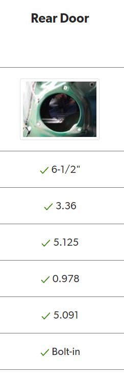

    All things totaled if you can get a Crutchfield agent to review why their system says the 3 3 ohm options won't fit (they should based on me looking at dimensions of your door openings and the speaker dimensions), and then include the speaker adapter brackets and wire harnesses for free, the above pairs would be your cheapest option, and of those, the 3-way JBL would probably sound the "best" due to it being 3-way, e.g. has 3 speakers as opposed to 2 in all the other pairs. If for whatever reason Crutchfield says they won't fit, or if you don't want to potentially lose any volume and can afford the extra $20-$30 then I'd recommend going with the top 2 ohm option and building the "kit" yourself. Using the adapter brackets and wire harness adapters will mean you shouldn't have to drill any holes or cut any wires.

    Tagging off of @Snert here, it's interesting on the "won't fit" claim because I got their "will fit" option and it was too small, had to use the adapter brackets. I'd have preferred a direct fit, which it seems like a slightly larger driver would've offered, and I'd have preferred a larger driver too!

    Hmm that's weird. I pulled up the 6-1"/2 JBL 2 way set from above and it looks like Crutchfield says everything will fit except the "screw hole alignment". Not sure how that could since the brackets line up with the screw holes regardless of what speakers you're using.

    That was the beef, in fact. Driver was 6.5, but truck will fit 6.75. And if you really wanted, on the access cabs you can stuff a 6x9 in the rear doors, which I'm still tempted to do. But I'd need to do some mods to the plastic door card or you just have all that sound rattling around inside the door.
