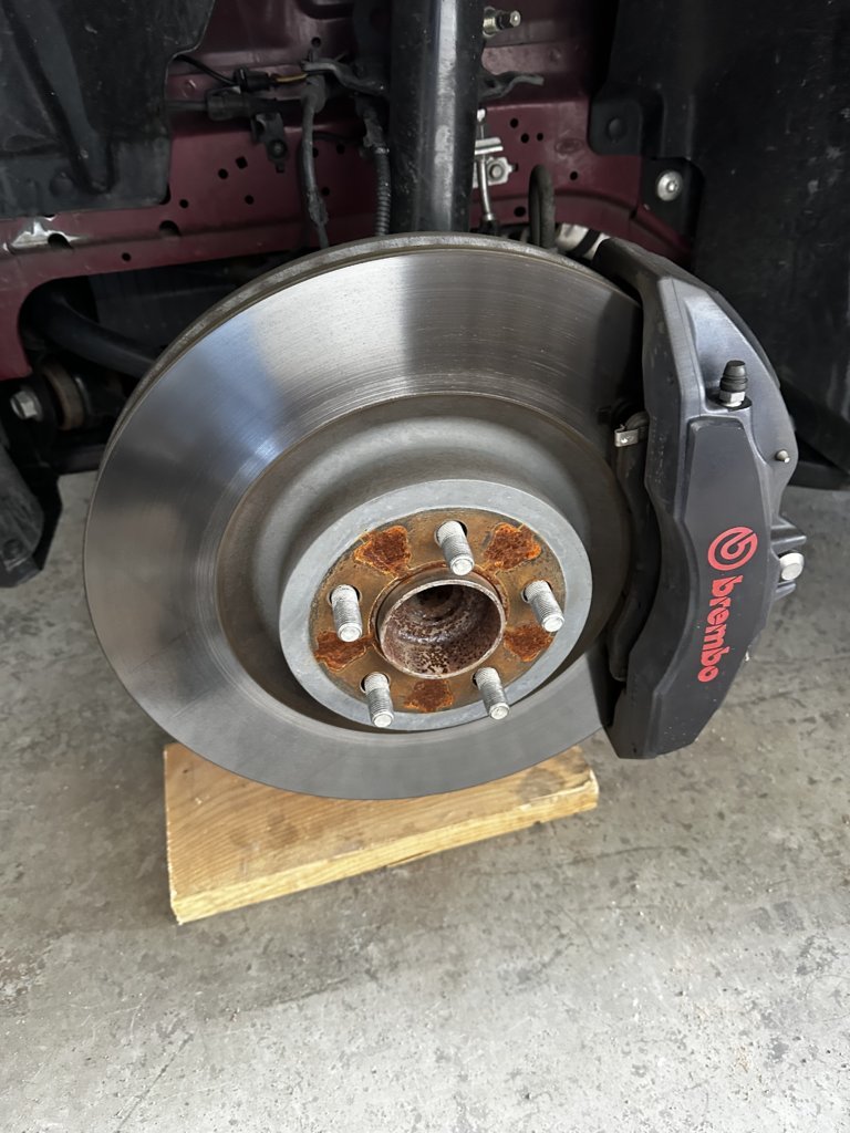

    Just go nuts. 6 piston brembo's FTW.
    These have 6400 miles and look new.
