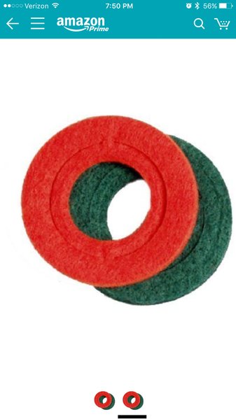

    You did say you're Scottish? lol My Grandfather was a Scott (Mc Laren) and a machinist for Rolls Royce. He used Vaseline on battery terminals.
    I like these:[​IMG]
    Law323 and 15whtrd like this.

    I purchased some of this not long ago. Might go this route then.
