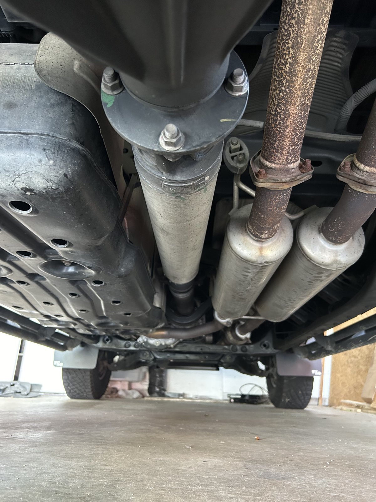

    2021 4x4 long bed here.
    Shaft is most definitely not in-line, fades 1.5-2 inches(edited) to the right rear side after the U joint(looking at it from where the rear tire sits of course)
    Truck was definitely in an accident. Drives great since.
    Trying to figure out if there is an offset from factory...apparently not.
    Thanks for any input.

    To better explain...the two individual parts of the shaft actually appear straight themselves, but the driveshaft as a whole is "kinked" for lack of a better term. The two part shaft is not exactly in-line, which is evident due to the slight angle of the U Joint.

    Oh maybe I'm misunderstanding. If the shaft itself is straight and the diff is just offset, then that's fine. I thought you meant you got under the truck and spun the driveshaft and if you put your finger on the shaft it would touch your finger then move 2" away then come back so the shaft itself was curved.
    If the differential is just offset from the tcase then there shouldn't be any issues. If you can't feel a vibration then I wouldn't be worried. What's happening is no different from the axle cycling up and down when driving, except it's offset to one side.

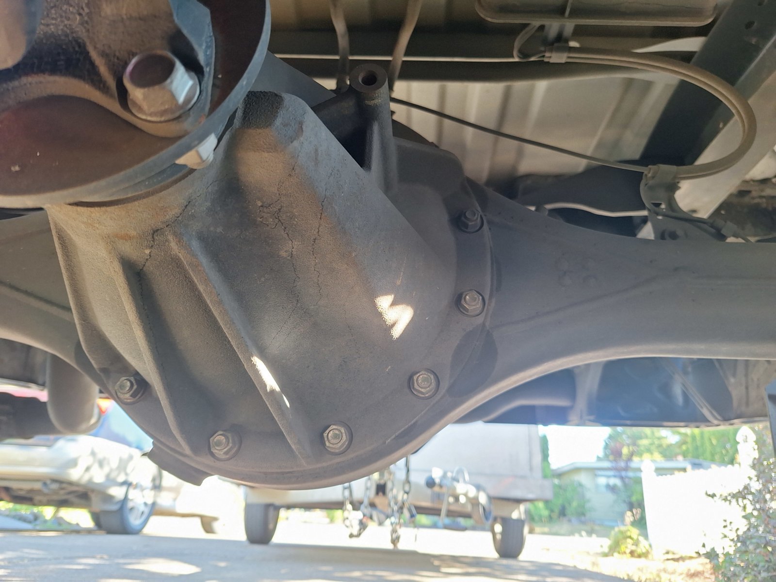

    What about this weeping/seeping on the Rear Diff seal? Normal or not?
    You can also see the 2 inch offset in one of the images below that the Toyota tech talks about in that video posted above.

    You'd know if the u-joints aren't canceling. There would be some seriously annoying vibrations going on. Tacomas are famous for it, at least they were on the 2nd gens. Move the center bearing over 1/16" and it shakes at different vehicle speeds.
    It's also a reason for the massive rubber ring around the center bearing. The axle can move up and down and rotate with torque so it is always screwing up the quest for a perfect angle cancellation.

    If it were me I'd not mess with that slight weep other than to snug up the bolts on the off chance that takes care of it unless or until there is a solid reason to open things up, or you get really bored one day. Unless it is leaking a lot more than it looks like it is (and that can be easily determined with a fluid level check) that itty bity weep falls solidly under my "Don't fix what ain't broke" rule which avoids the potential for self induced headaches for little to no gain.

    Yeah, another vote for leave it alone if it isn't dripping.

    If the offset of the rear diff is not stock, such that the axle is off to one side, then the tires will not track properly. The front alignment could be adjusted to compensate, such that all four wheels are pointing in the same direction, but the rear wheels will be offset to one side. You can see this if you drive straight on a dirt road. The tire tracks from the rear tires will not align with the tracks from the front tires, they will be off to one side. The body of the truck will not be perfectly parallel with the road when driving. A frame shop should be able to check if the frame is bent without spending a lot.

    I wouldn't touch the bolts until it has a drip.
    OP, thats a nothing burger.

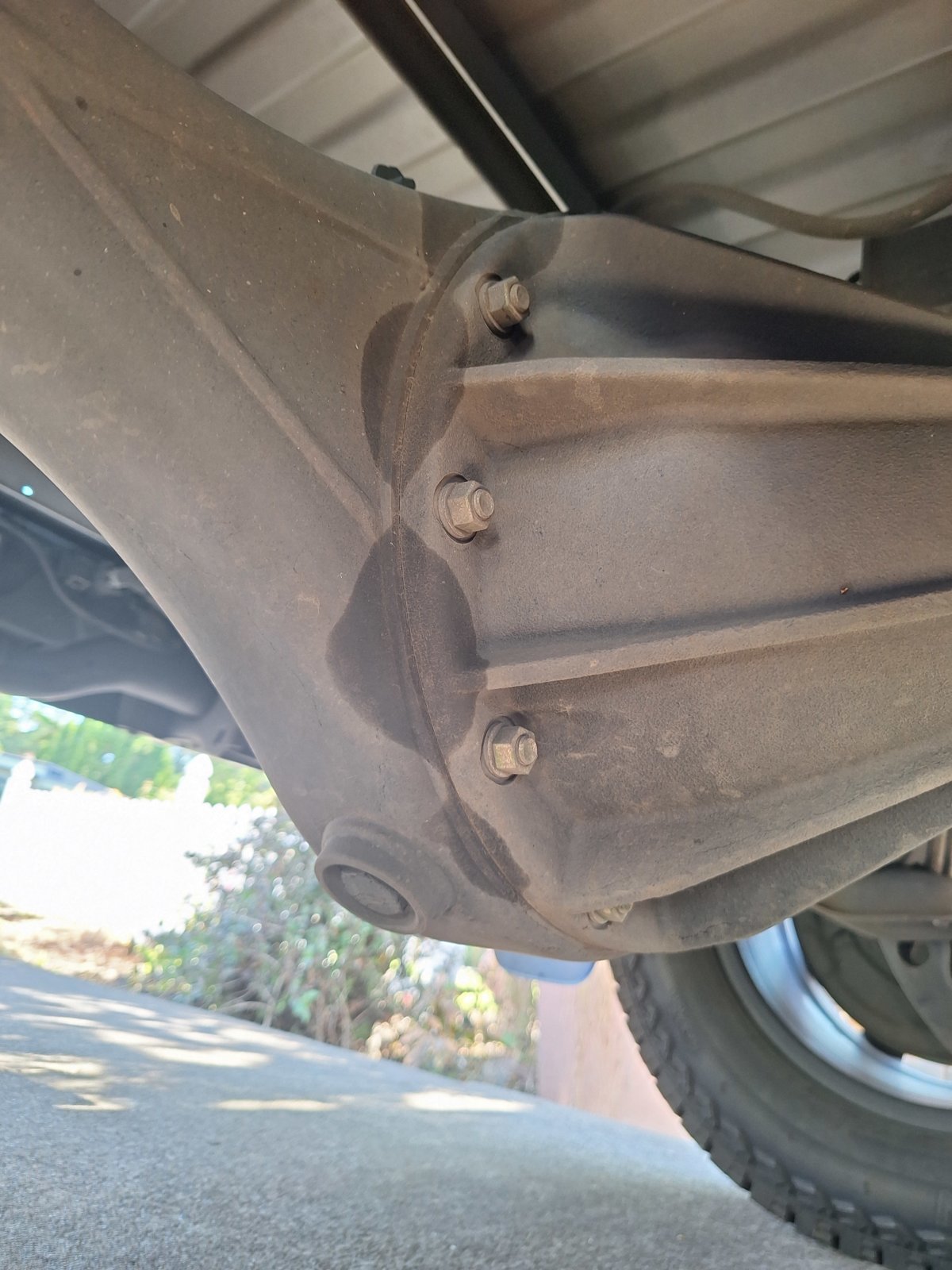

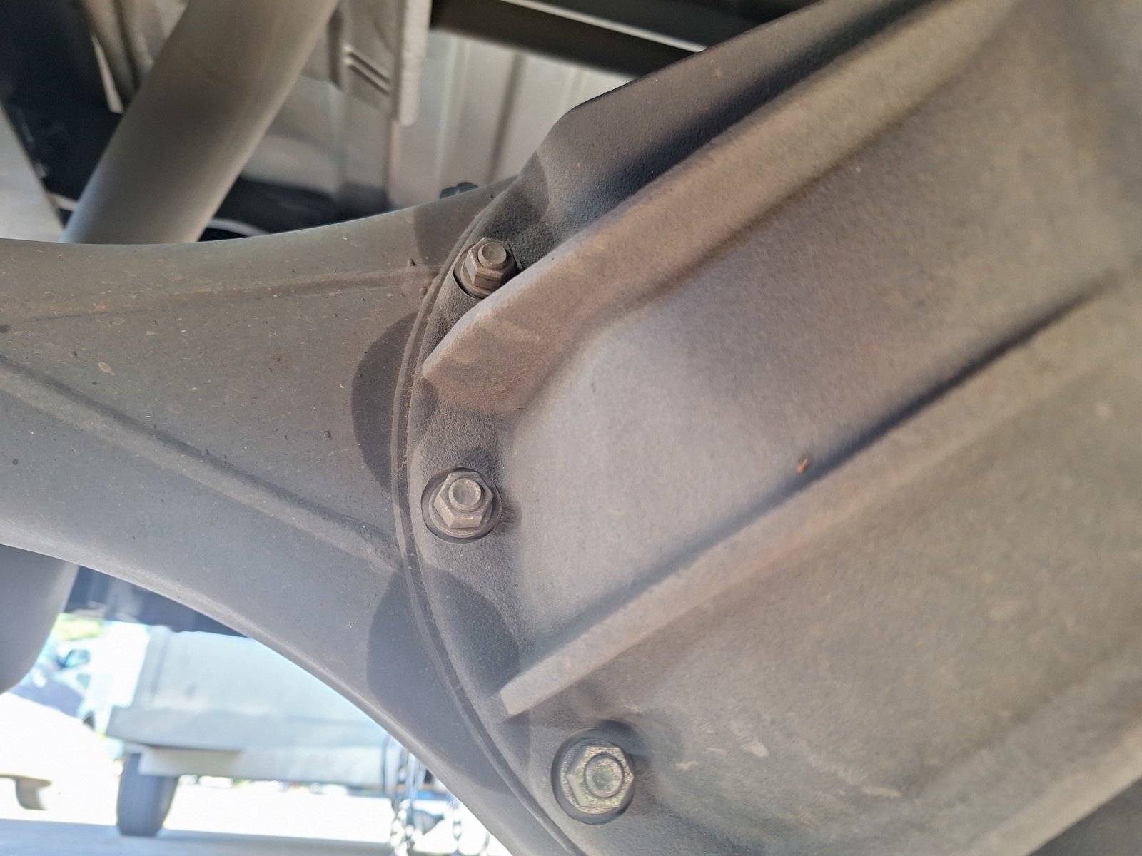

    I did a fluid level check today. I could reach the fluid with my pinky finger(only finger that fit) barely into the fill hole. So not really low at all.
    Decided to drain and fill at 21K miles.
    I put this stuff in, from Walmart. Toyota dealer didn't have factory Diff Oil because..."it is too expensive so we use a generic"...lol
    Torqued the nuts to 50 ft/lbs, and the drain and fill plugs to 36 ft/lbs.
    Cleaned the weep/seep with brake cleaner and will monitor for further seep/weep.
    Dealer said any service was still under warranty but I couldn't wait 3 weeks so I just did it myself. Not sure if I want them messing around with it or a new seal yet. Truck will be under warranty for another 18K miles. Currently has 21K on it.

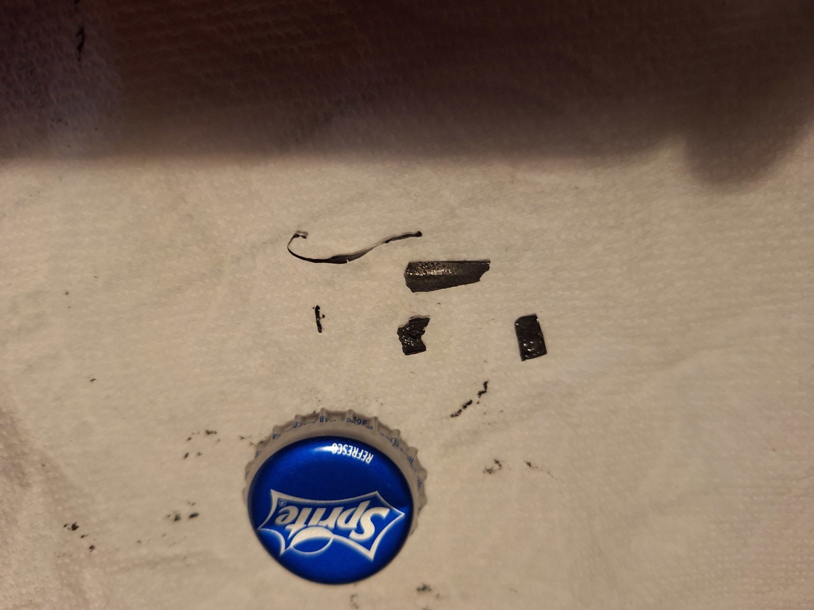

    Found this on the drain plug, probably been there since the start up break in period.
    Should I run thicker diff oil? or is this gonna be good enough?
