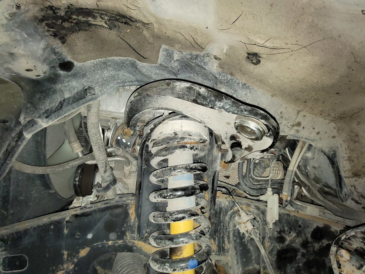

    Had a fight with a big log, log won. Now fixing everything with uniball uca's, toytec 2.5 Ultima lift kit and I cannot get the uca bolt out that took the most of the blow from the log. It's tweaked. I cut the end of the bolt off but I still can't get it to budge. Any ideas?

    Have access to a cutting torch?

    you're gunna have to cut all that out in pieces
    i hope the UCA mounts aren't bent too bad

    Torch would be the likely solution here.

    I m no mechanic, but I m thinking the coilover is keeping it tight. Maybe you could block up that corner of truck, and compress it somehow?

    try an angle grinder with cut off wheels if you dont have a torch

    Damn. Impressive. is the bolt bent or is it just the arm and bushings?

    What does your LCA and spindle look like?

    If you are replacing the UCA anyway I would just cut thru the UCA where the bolt goes through. Maybe like a 4” grinder with an abrasive blade. That rubber bushing is going to suck. Might be easiest to cut the arm off the part where the bushing mounts so you can get a better angle.
    Just an idea.

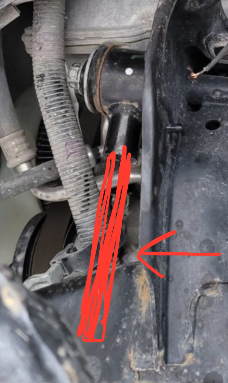

    I've already cut most of the uca out. The bolt just won't budge. I can't get it to move an inch. We're out of oxy acet also but I'm not sure what I can safely cut out.
    What about welding up a right angle punch? 2 or 3 inches long and if it works and I make progress, add a few more inches to it as I go? Space is a factor obviously.

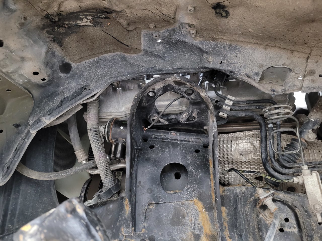

    Here's the other side btw
  12. Jan 29, 2021 at 5:22 PM
    Blownmtr
    Blownmtr [OP] New Member
    Jun 13, 2020
    #47920
    14
    John
    2017 Tundra TRD Pro
    Everything cut

    Can you post a current pic so that we can get a better idea of where you are at currently?

    The bolt won't turn or budge at all currently? Is that a broken sensor wire as well? Can you get a pry bar under the head or behind the washer?

    No it won't turn and that's putting every tool in this shop we have at our disposal.
    Pry bar not working either.
    The bolt is insanely hard too. Like some sort of Japanese mithril or something. One idea is just cutting the center tube out in the coil pocket but I just don't think I have a way to get a straight cut in each side so I'm able to weld the tube back in with the new bolt for alignment.

    I know it’s tight you can’t fit a bolt in the other side and tap and then use bigger bolt and bigger. Or try to pry in between the part of the UCA that’s still there?

    Honestly, looking at the pics and skimming what you wrote about a 90* drift to bang it out, another thought (unlikely to work IMO) is a pneumatic chipper with a modified bit to try and pound it out. I'd want to leave that bolt head and have someone trying to turn while banging on the other end. If you get the last bit of UCA cut out you may be able to try and bang the bolt back to straight enough to remove?

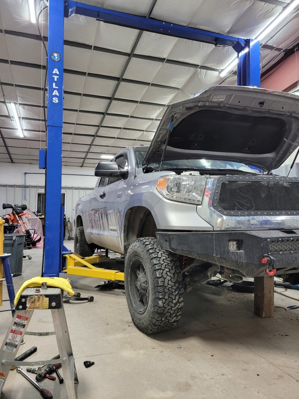

    Waiting on my buddy to get here. Gonna try something along the lines of that.
    Rear done and left side done. Might need bigger tires. Nice looking lift..

    Warren’s was bent good but came out and went back in easy. Maybe soak it down with pb blaster or something and try a pickle fork/wedge/pry tool between uca and bolt head to get it moving.

    Just got it out with an extra set of hands, a 22mm wrench and a 4ft pry bar
    Woohoo. New Bolt and abs sensor delivered tomorrow so with any luck it will drive. Just need an alignment.
