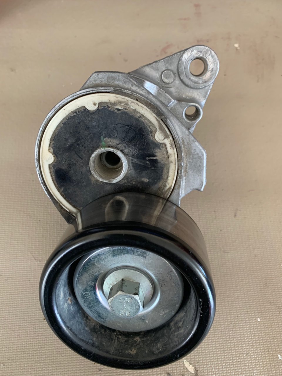

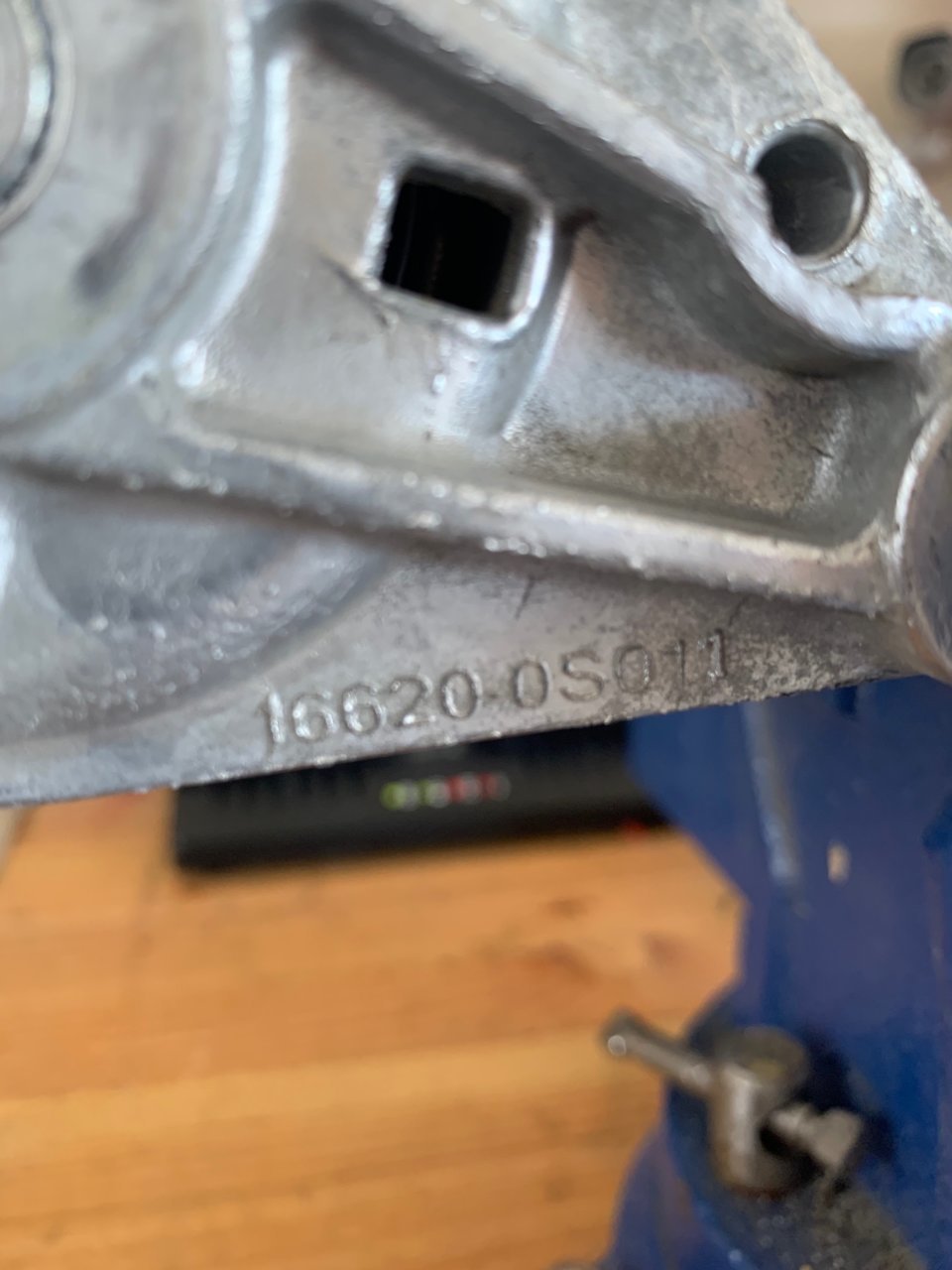

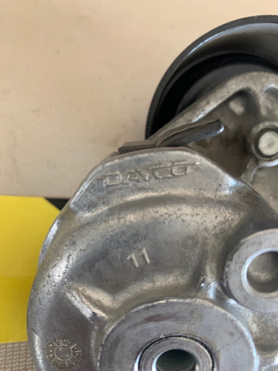

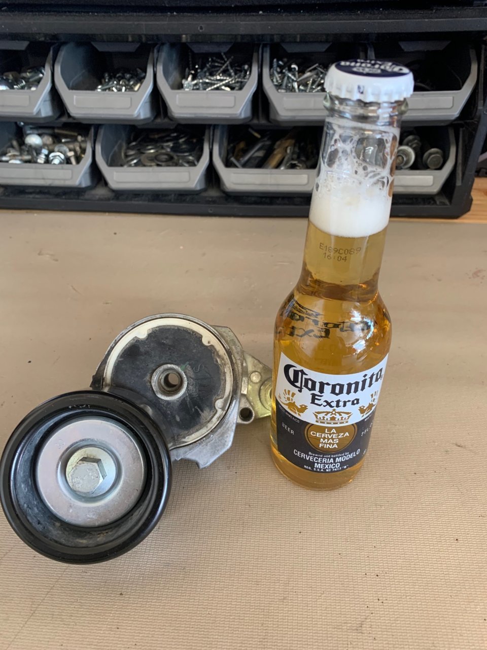

  10. Aug 21, 2019 at 2:31 PM
    jeremyd
    jeremyd [OP] 2014 Crewmax SR5
    May 9, 2016
    #3336
    1,469
    NV
    2014 SR5 CM 4X4
    ProComp 7" 35/12.50/18 -11
    WOW ! what a difference ! super quiet. No squeaking or rattling with or without the AC. I believe the AC clutch helped me diagnose the pulley due to the AC clutch engaging and putting more of a load on the already bad tensioner. I put the old tensioner on the vice and was able to feel some play on the pulley. A good day and a mini Corona to top it off. Lol

  12. Aug 21, 2019 at 4:59 PM
    jeremyd
    May 9, 2016
    #3336
    1,469
    NV
    2014 SR5 CM 4X4
    Was surprised to see Dayco as the OEM part.
