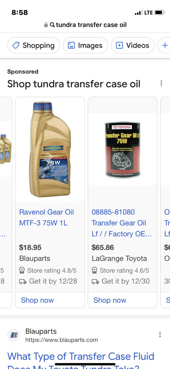

    30F4A1A2-5CC0-431B-982B-B33673BB4543.jpg Let me clarify.
    The Ravenol 75wMTF-3 is a Manual Transmision Fluid. That is absolutely correctamundo.
    The part number for “Toyota’s brand” of Tundra T/C oil is #08885-81080 which is listed on the Ravenol bottle.
    There are two other Toyota oil part numbers on the bottle as well. I called Blauparts in Michigan who sell this German made oil. They confirmed not once but twice that this is the oil for my transfer case.
    Im also looking at the bottle as I write this.

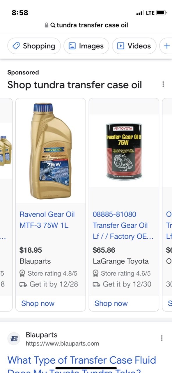

    Downloaded image twice. Oooops.
  27. Dec 18, 2022 at 8:15 AM

  28. Dec 18, 2022 at 4:42 PM
    #28

    Im sure that it works just fine since I haven't seen any negative reports from people who have used it, I almost bought it myself. Whats funny though is that the Toyota part numbers that it lists are not interchangeable and completely different oils, one for a manual gear box and one for a transfer case. There are oil analysis out there that show the Ravenol is much different that the Toyota TC oil. For how often Ill be changing the TC oil, I decided to spend the extra money on the Toyota stuff to err on the side of caution and its been working just like new with it in there. Its good for 30k which is about 3 years for me so to spend a little more spread out of that time frame is negligible. Now if it were like motor oil and changed every 5k and the price was that different Id definitely opt for the Ravenol.

    I hear what you’re saying. After my looking into this oil I had to think why would an oil company advertise an oils compatibility if it weren’t compatible especially a company that’s partnered with Toyota over there? That’s asking for some serious legal problems not to mention loss of market share. I respect what you said but I’m sticking to my guns.

    Completely understand and I would never hate on what oil someone runs in thier truck. There is clearly even tons of trucks out there running 75w90 without an issue as well considering it seems that what dealers put in from accounts I've read on here. I only suggested changing his oil to the OP since it sounds like it works when the fluid is warmed up. I have some 75w left over and tons of 75w90, if I have some spare time I'm going to try to be an amateur Project Farm and stick some in the freezer and do a pour test. I read one account of someone that said they called Borg Warner and they said 75w90 is fine and even someone that posted an email from Toyota who said it's fine also.
