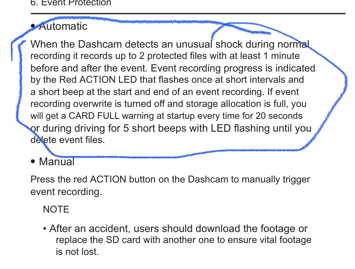

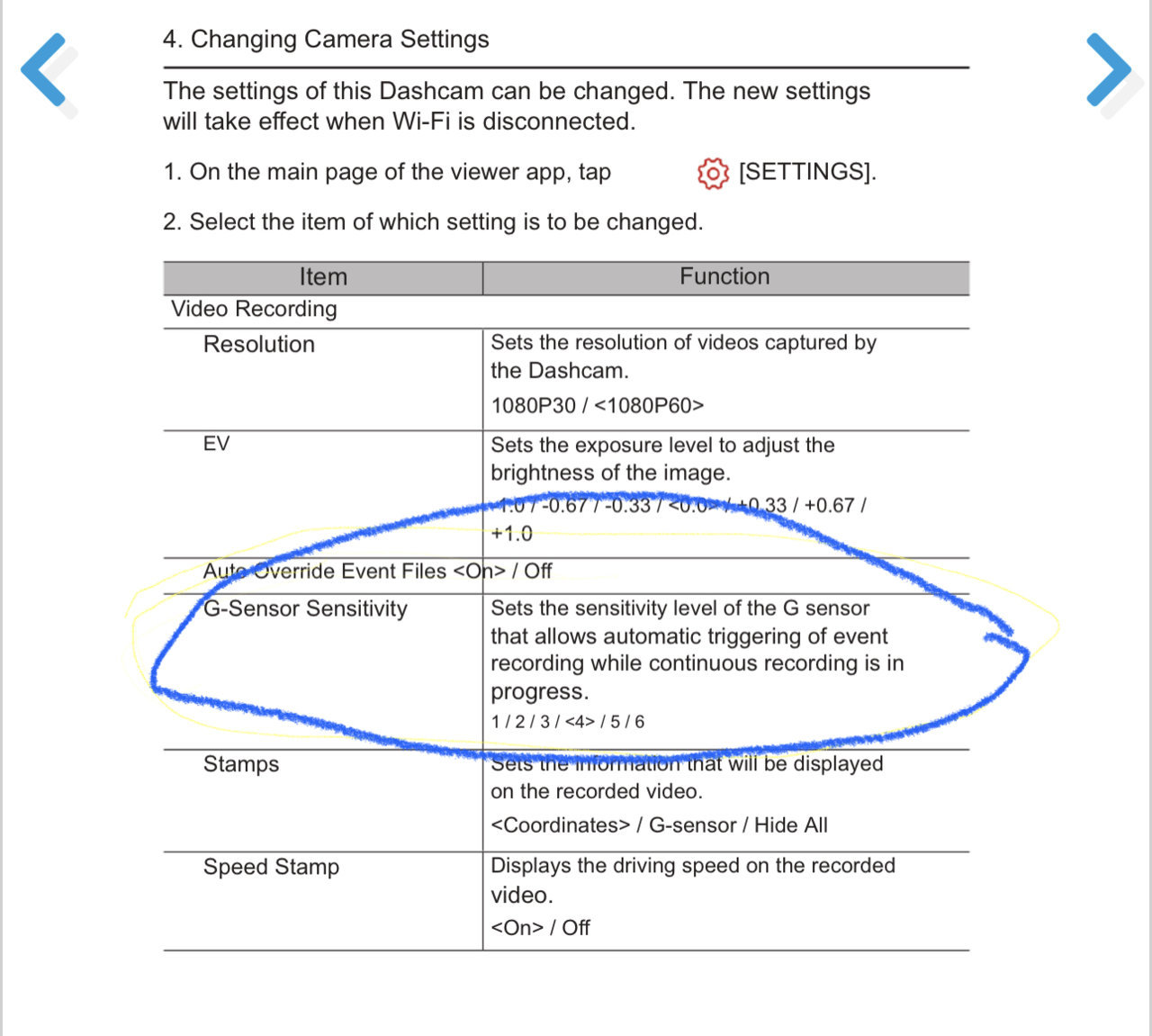

    You can also adjust the g sensor for the camera. You can make it more or less sensitive to the g shock.
    Taikowaza[OP] likes this.
  5. Mar 25, 2023 at 3:07 PM
    Taikowaza
    Taikowaza [OP] New Member
    Oct 20, 2021
    #69581
    577
    bigjuice likes this.
