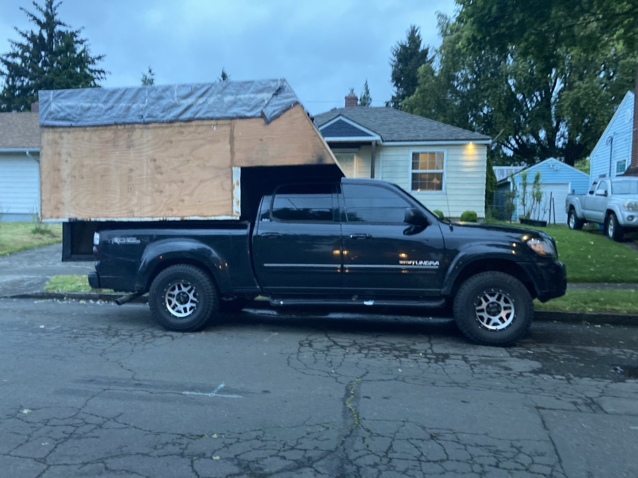

    Heres the camper on my truck before painting
    The tub is 99" long and the roof is abouy 6'9" off the bed. Probably too big. I was trying to get as much space as possible.

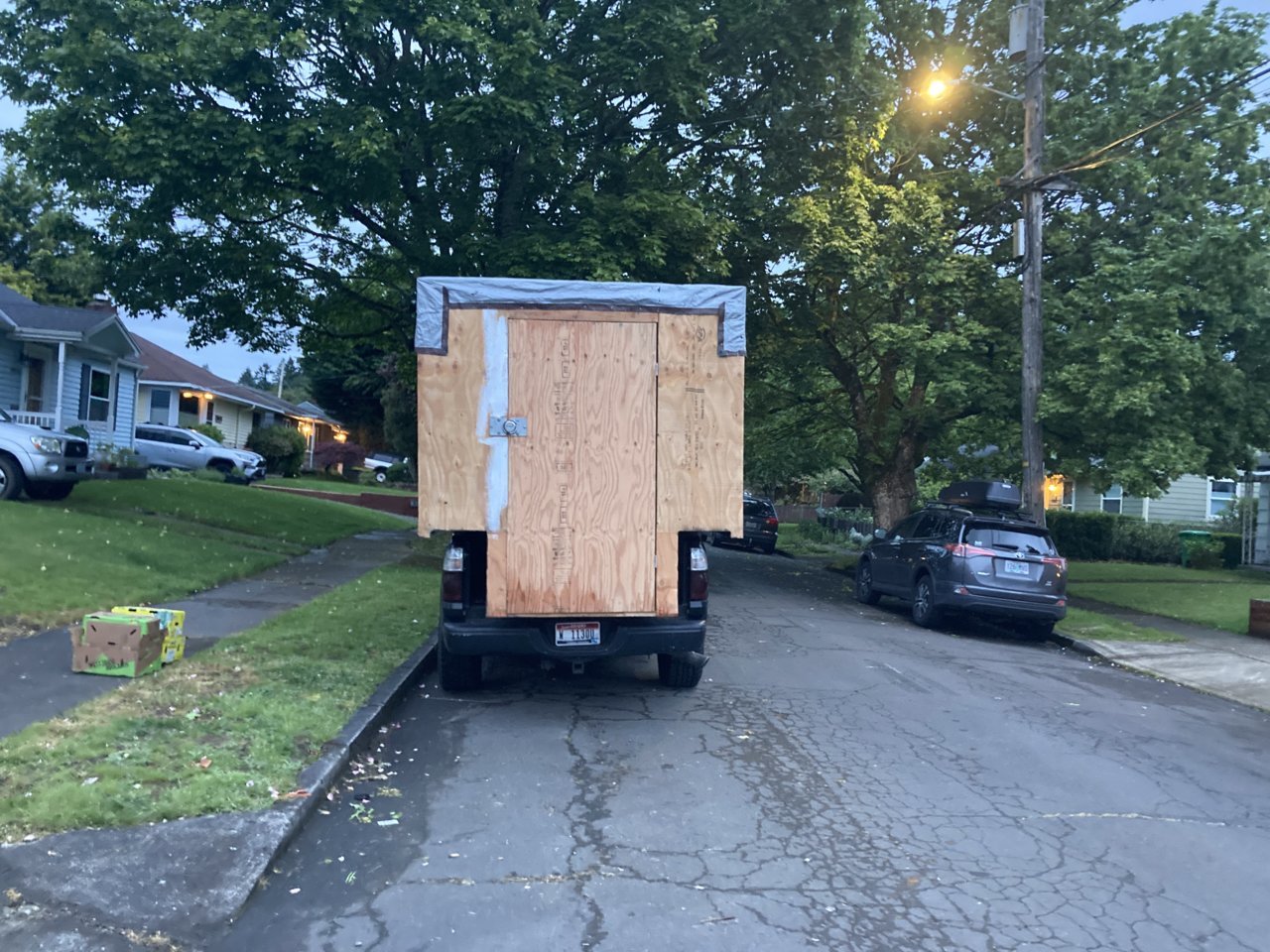

    2006 Tudra TRD

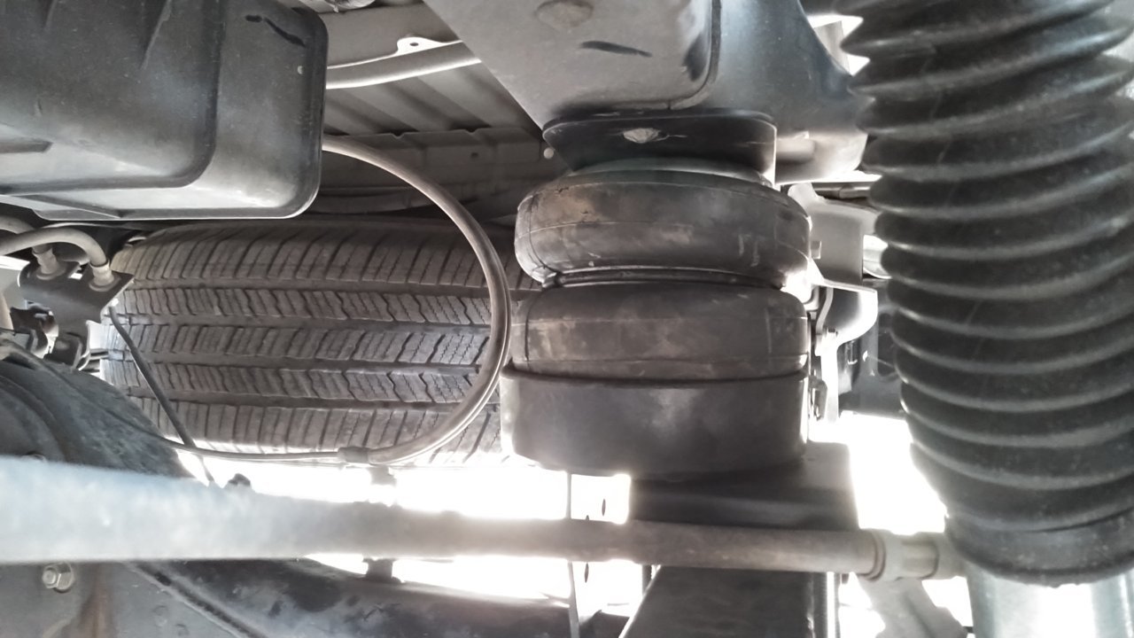

    I put air bags and cradles on a couple of weeks ago. 2 hour job, biggest hassle was removing bump stops.KIMG0518.jpg

    You can run an air compressor but I just use the supplied valve stem and add air as needed. You do not need to take off the camper, just jack up the rear and then put it on jack stands. You'll need take off the wheels.

    You’re way over payload and have a really high center of gravity with this setup. The definition of Sketch. I would rethink this setup and go with a trailer or smaller canopy contraption. After the accident is a bad time to reconsider.

    You want to add 1800lbs with a center of gravity about the height of the cab roof? I think you will be grossly overloaded and will tip the entire rig over the first time you hit a tight radius exit ramp above 15mph.

    Buy a trailer for it instead of putting yourself and others at risk. I don't see how you'd ever be under GVWR with this setup plus the 1000lbs of supplies you mentioned. No matter what upgrades you do to the suspension, the GVWR on your door and what DOT recognizes will not change.

    you possibly have built the center mass too high. That thing being so wide and heavy is not wise

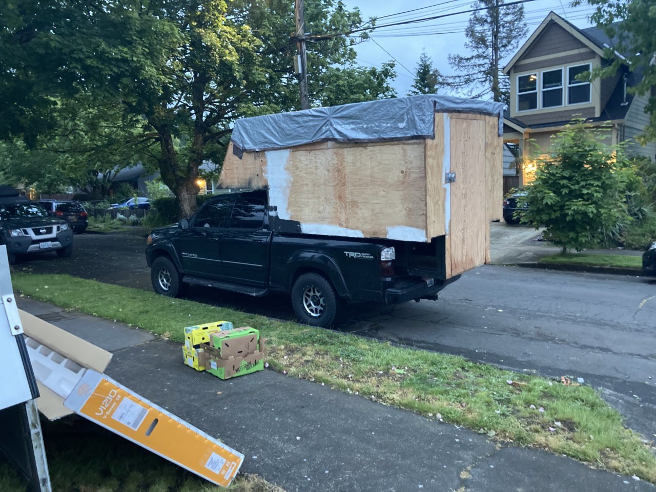

    Anyone catch the size of the tv box in first pic? Dear lord man you got an 80 inch tv and your makin a DIY truck camper?
