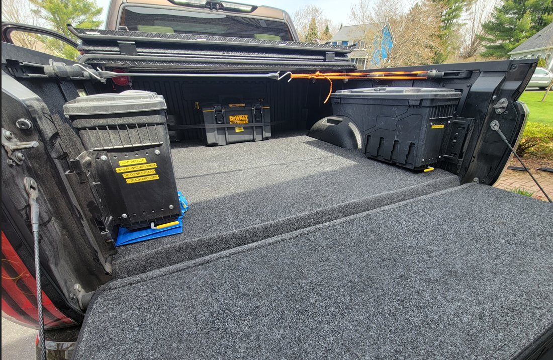

    Recently picked up a BedRug XLT for my 5.5 bed. No instructions. Part in the bed was obvious. Tailgate not so. Tailgate piece has two full length velcro strips. looking at the tailgate, it has a continuous ridge at bottom. I attempted to mount along the bottom ridge and top was at the bottom of the cap molding. No go as the fold is too large. If the fold is down, the gate will not close. I repositioned the tailgate carpet such that it was at the very top of the tailgate, this worked. The tailgate carpet now has velcro on the vertical ridges on the bottom and at very top of the tailgate, and closes.

    Yeah, you have to play with the position to get the tailgate portion high enough, but won't interfere with closing. Just below the top edge of the plastic trim seems to work just fine. Velcro gets put on where needed. This Velcro has the highest bond strength of any I have ever seen.

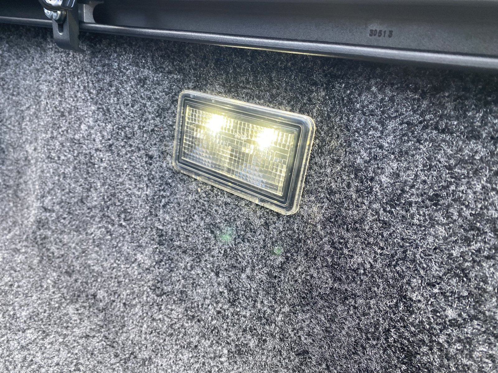

    When I installed mine the easiest way to make holes for the tie down system, 120V plug port and the side lights was to use a soldering iron. Put the bed mat in place and burn the holes in using the soldering iron. Makes for a neat install with no frayed edges or overcuts. The other thing I did was to get some edge trim from Amazon. I put it over the felt edging on the tailgate portion. Haven't had a problem with it moving or shifting at all and it protects that finished felt edge.

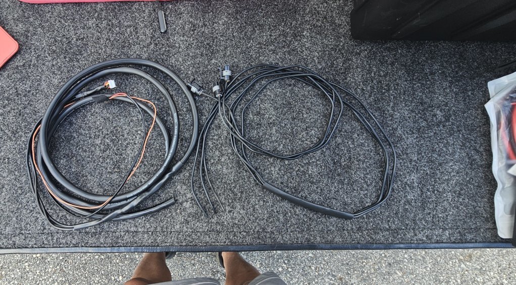

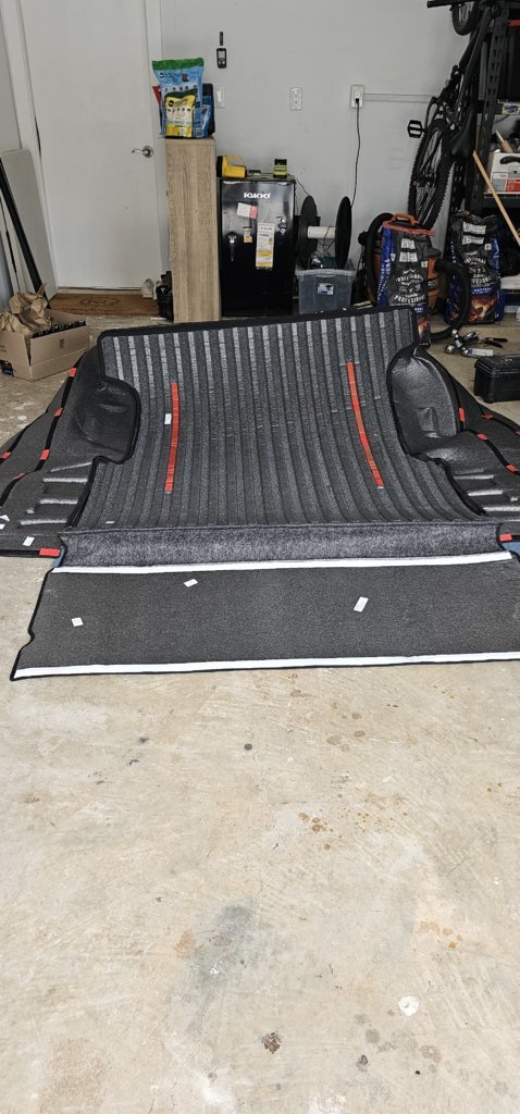

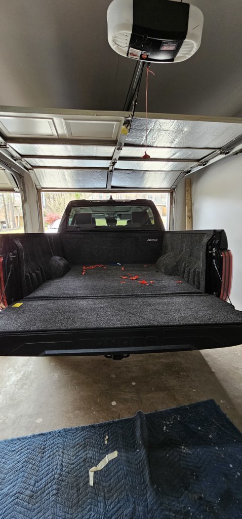

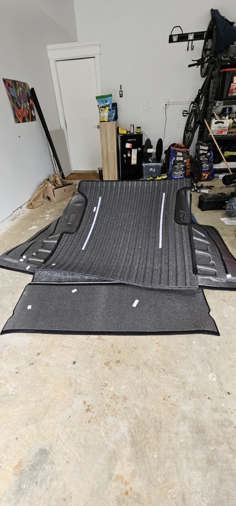

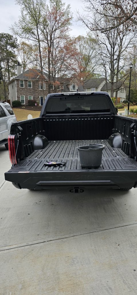

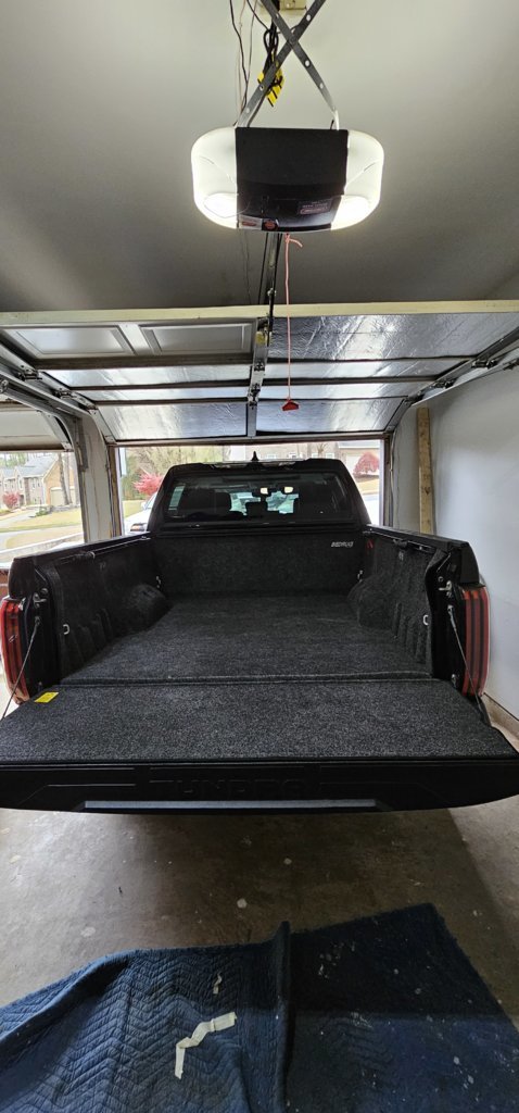

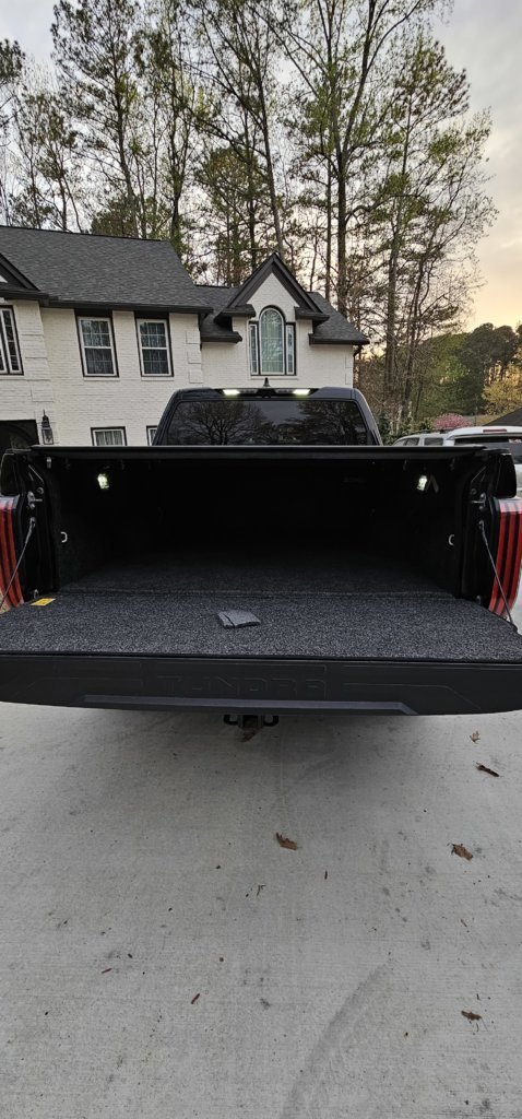

    Installed my bedrug today. About 5 hours of work.
    My best recommendation is to zipper it on the floor with botton side up. This will make you life easier.
    If you have a rollup tonneau, you might need thicker side seals since the clamps won't tight enough with the rails separated from the sides a good 1/8 or more.20250329_145316.jpg 20250329_152220.jpg 20250329_154222.jpg 20250329_161735.jpg 20250329_181856.jpg 20250329_193544.jpg 20250329_145316.jpg 20250329_152220.jpg 20250329_154222.jpg 20250329_161735.jpg 20250329_181856.jpg 20250329_193544.jpg
