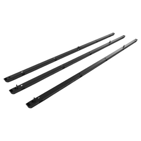

    Here’s my question, I looked with a fine tooth comb and there is no accessory rail nor any holes where one would go. I pushed around with my fingers to see if they were filled in or something before the bed liner went it and nothing. Does every tundra from that gen have these holes? Is this some drop in liner on the front side? I added a pic of this accessory rail so you can see. Every product I’ve found mentions the holes and or rail.

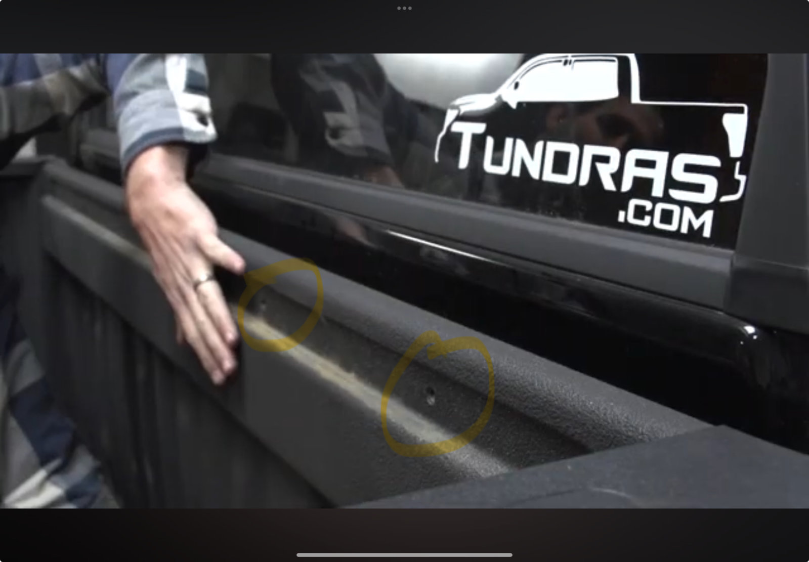

    You should have the holes. Sounds like they were covered up during the spray in bed liner application.

    The holes were probably filled with bedliner when it was sprayed on. Mine filled when it was applied.

    Those are threaded holes for the factory rail system. They can be cleaned out with a tap and electric drill.

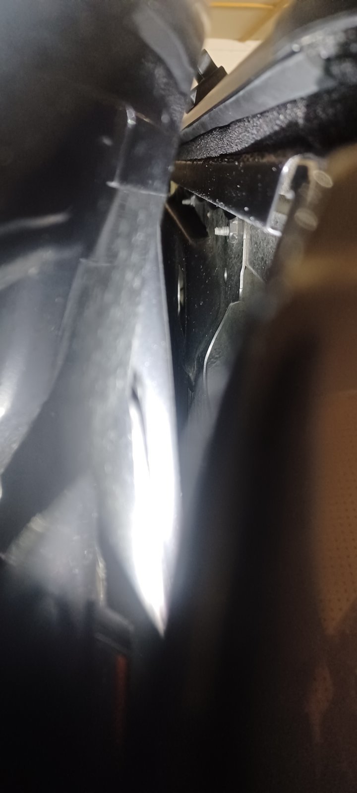

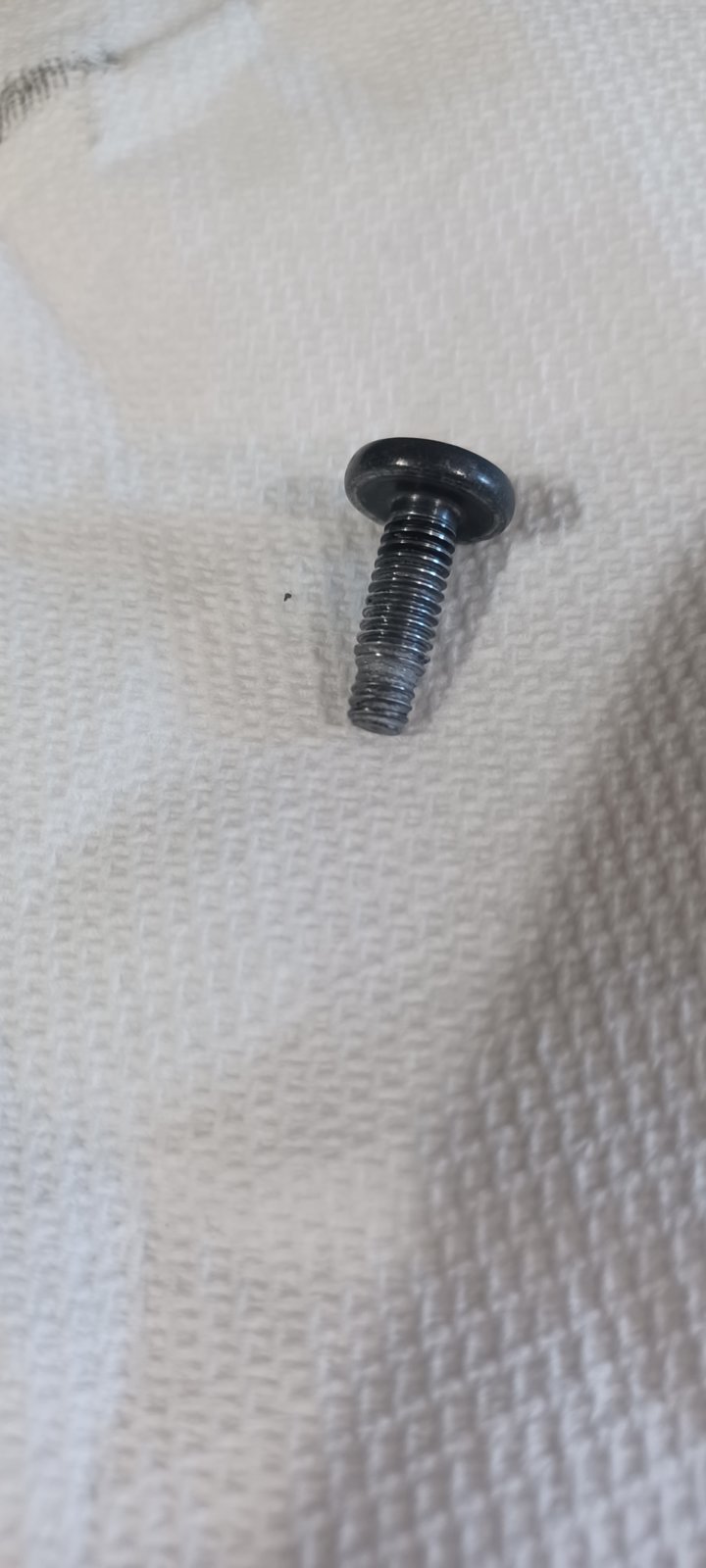

    No need to measure. Put you hand down between the box and cab and you can feel/see the nut heads. The bolts are 8mm x 1.25.
    NewImprovedRon likes this.

    Awesome, I’ll head out and take a look.
    Ruggybuggy[QUOTED] likes this.

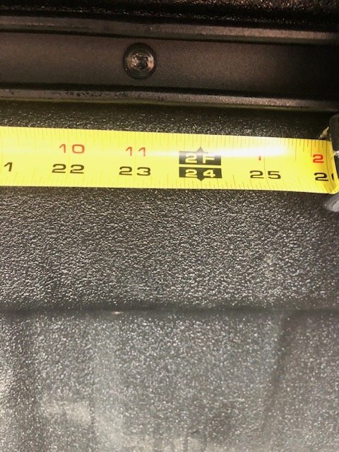

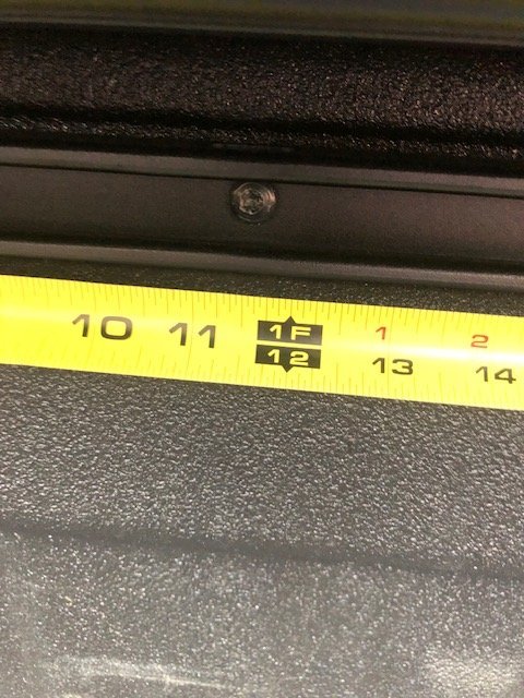

    ^ If that didn't help, the front rail is the top rail in the pic.
    There are 4 bolts, 2 on each side.
    Each side the bolt is around 11.5 apart.
    The 2 in the middle are around 23" apart.
    Ruggybuggy likes this.
