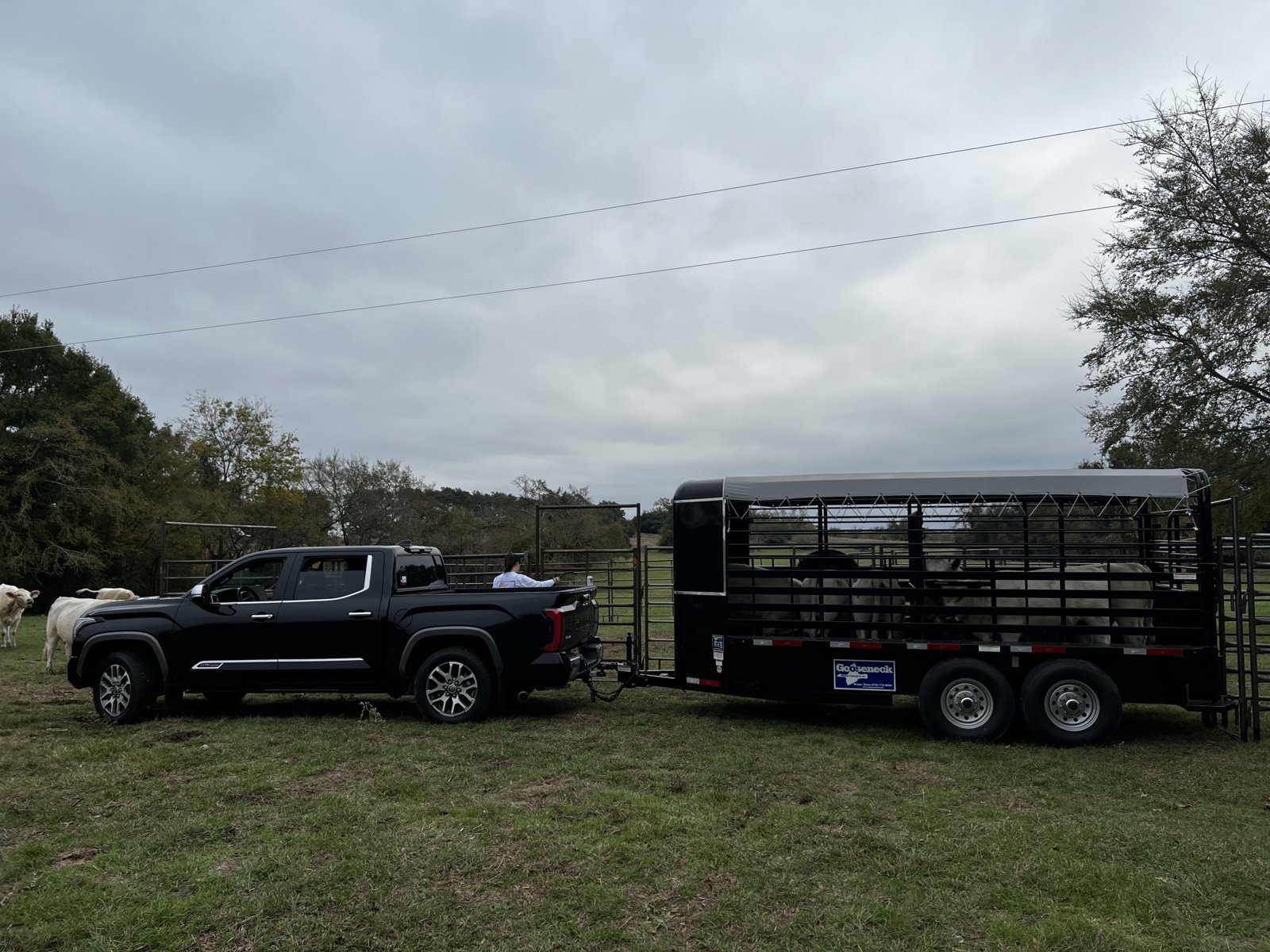

    1,719
    Picture says a 1000 words ......
