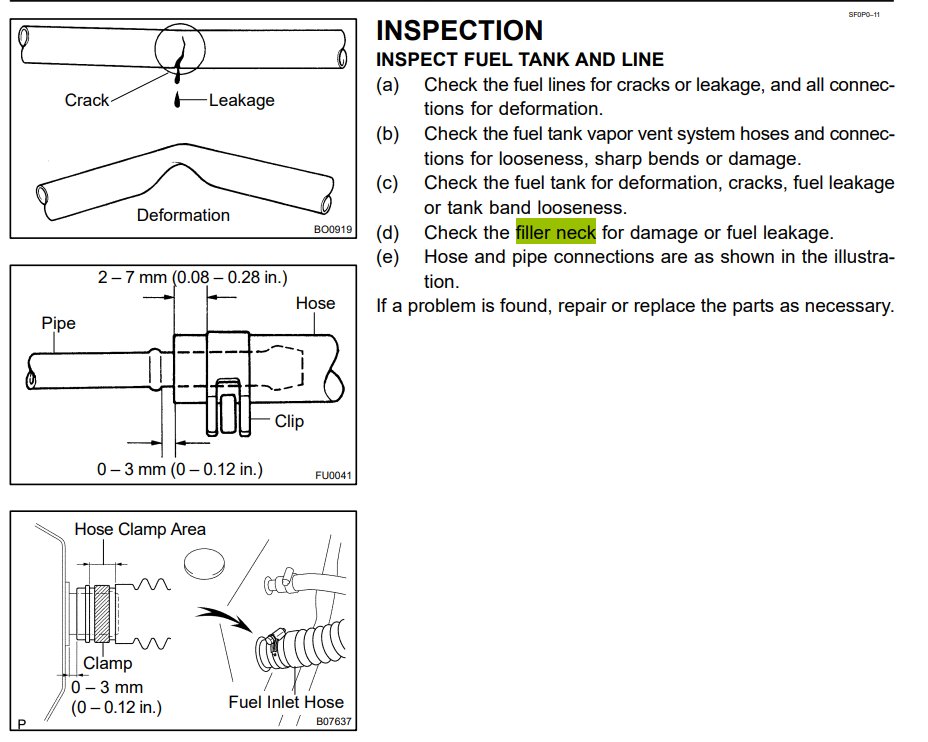

    I can't figure out process of unhooking at gas cap area to lift bed off. I watched a youtube videa but my 2005 does not remove that outer splash surround when removing the 4 screws? Can someone explain to me what needs done at gas cap area before lifting bed off? It is a 2005 4x4 sr5 AC

    This is from the 2003 FSM, but might give you some clarification

    Thanks on schematic.. must be some variation from 2003 and 2005. By filler neck is attached to the outer fuel inlet pipe shield.. I can't see how it separates from it? like it has a metal ring or clip keeping them together as one. I will try to unhook the vent line and the filler tube ..and mounting bracket underside and see if that filler assembly can get lifted with the bed.

    2004-2006

    Got it! Its sitting on saw horses. Thanks everyone for all your help on this..And other post. You all are the best here.
