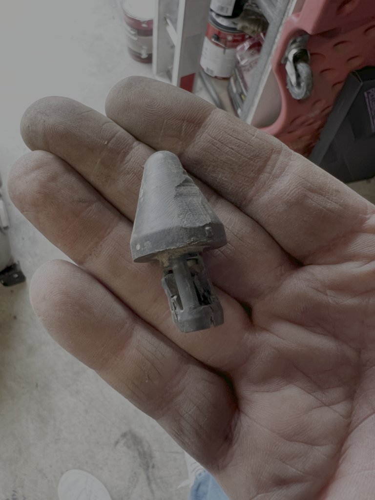

    Welp, I removed my bed this morning, (2004 Tundra Access Cab) and found 2 of these on the driveway. I've been looking online for a diagram, but nada. Any idea where they go?
    THANKS!

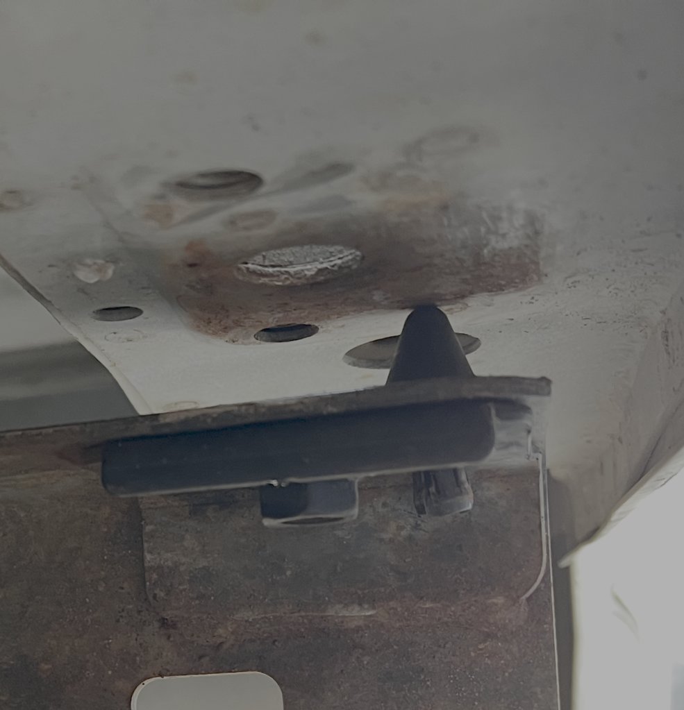

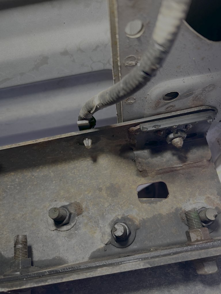

  7. May 2, 2025 at 12:23 PM
    2004Ton
    2004Ton [OP] New Member
    Tuesday
    #134213
    7
    I gotta be blind as a bat... I can't see how these things fit between the bed and the frame! I looked at both front and rear bolts, all of these areas seem paper thin tight... Crazy stuff.

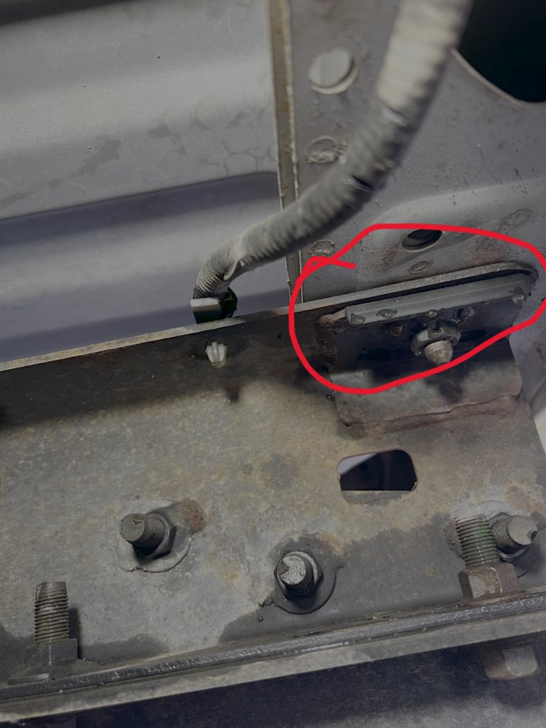

  8. May 2, 2025 at 1:50 PM
    Kimosabe
    Kimosabe Slacker
    Jul 28, 2020
    #50004
    1,161
    Sun Valley, Idaho
    06 Tundra DC TRD 4WD
    W.I.P - FOX 2.5 with DSC, SCS F5 wheels with MT Baja ATZ 285s
    There should be a hole on top of the frame in the area I circled in red. That's the end of the frame right?

  10. May 2, 2025 at 3:23 PM
    2004Ton
    Tuesday
    #134213
    7
    I jacked up the bed, looked between the frame. No hole besides the bolt hole, and one that when I put the damn spacer into it, it makes the bed sit 1/4 too tall. I'm about to just bolt her up. I can't see these being urgent...

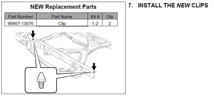

  12. May 2, 2025 at 4:51 PM
    BubbaW
    Aug 19, 2019
    #34845
    3,765
    Bubba
    Where Eagles Nest
    04 DC LTD 4X4 4.7 V8
    T150 Lover
    Agree and when it's come up before no reason was ever determined.
    The below pic is from an 04-06 LSC for CRC that came out in 2013.
    Whether at EPC or even Partsoug that I prefer, they both show driver side, fnt and back as the below drawing shows.
    shifty`, G_unit3000, abcinv and 2 others like this.
  13. May 2, 2025 at 4:58 PM
    whodatschrome
    whodatschrome New Member
    Sep 13, 2023
    #103882
    1,785
    North of North Plains, Oregon
    lots of dents
    The tapered locating dome dowls are exactly that, for locating the bed on the frame. There’s only two of them, and they’re both located on the driver side of the frame. Put’em back into place in order to help facilitate reinstalling the bed on the frame.
  14. May 2, 2025 at 5:08 PM
    2004Ton
    Tuesday
    #134213
    7
    Ah... drivers side only! I do see these holes. WTF! Thanks for the info guys. I was able to easily align the bolts without them, but may put them back because I'm anal. Sweet, thanks!!!
  15. May 2, 2025 at 5:25 PM
    whodatschrome
    Sep 13, 2023
    #103882
    1,785
    lots of dents
    I’m kinda suspecting they do two things. Obviously they make it super easy to line up the bed bolts in order to thread them into the frame. Perhaps since they’re only located on the left side, is that they slightly keep the bed elevated off the frame (if they aren’t indexed properly) so that the main wire harness doesn’t get crushed while trying to located the bed onto the frame? Just a theory there.
