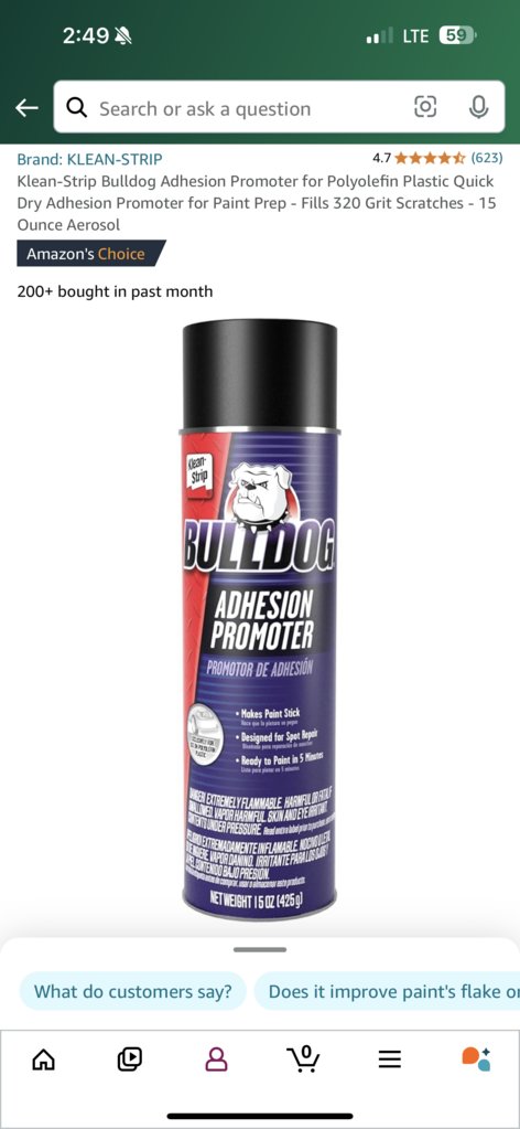

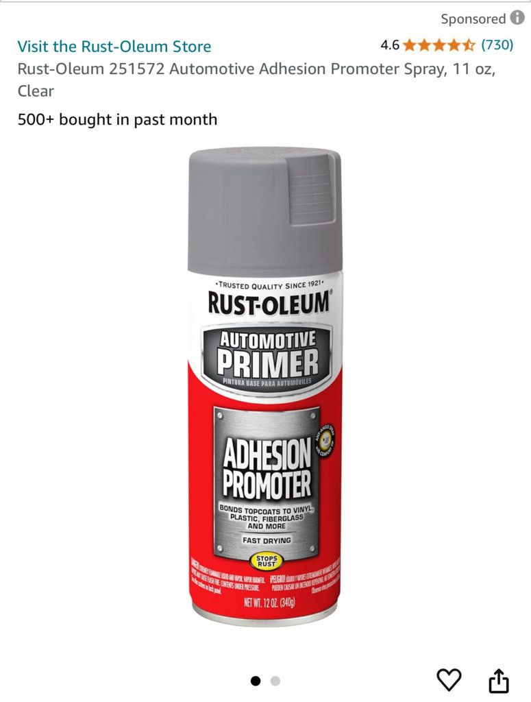

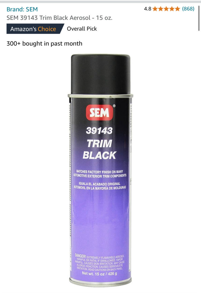

    For what its worth, I had no luck with the restoration products. I think mine were just too faded
    I repainted them using bulldog adhesion promoter and SEM trim black for about $16 a can. Color looked good as New. So far no issues with flaking or peeling and as I recall it was about 6 to 9 months ago
    I would not recommend the bulldog adhesion promoter now due to the cost. It was already expensive and now it's gone up to about $50 a can. The rust-oleum adhesion promoter is rated practically the same for roughly $10 a can
    so you can get them refreshed for about 30 bucks
    I believe I did 2-3 coats of the adhesion promoter and 2-3 coats of the trim black
