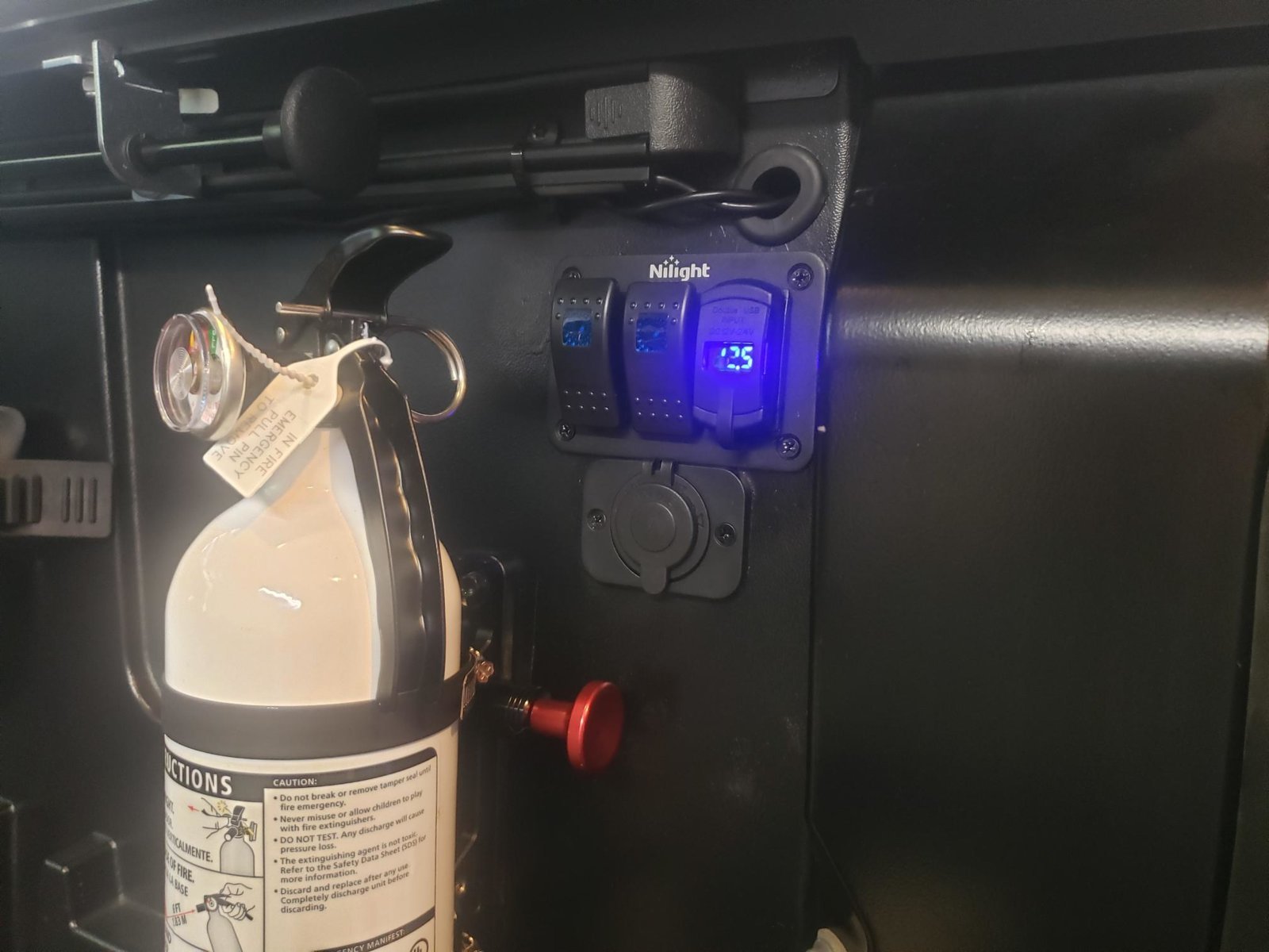

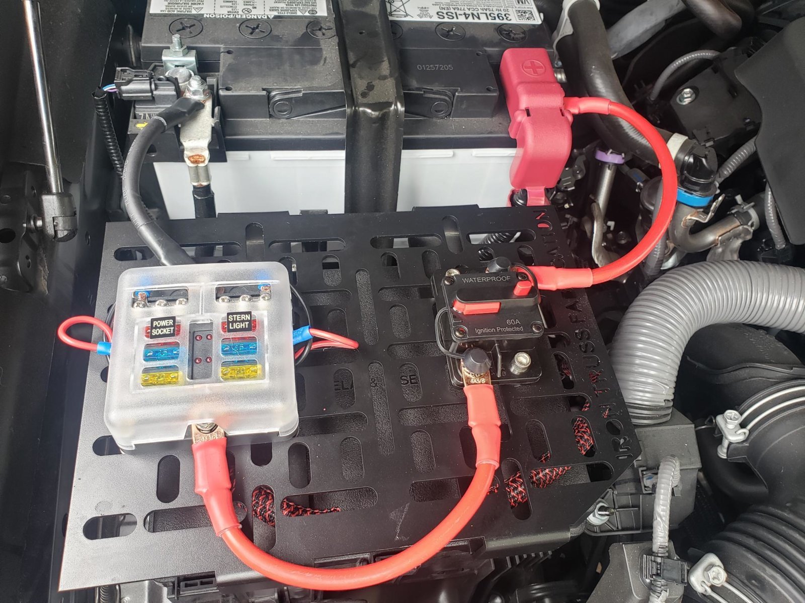

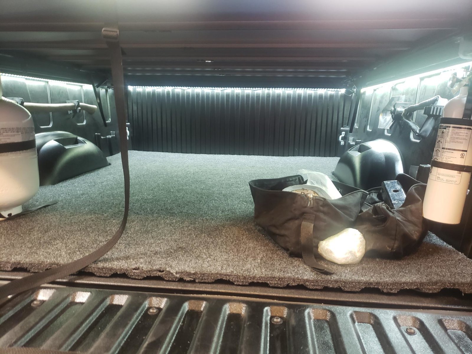

    I ran the same exact kit into my bed. I made a separate fuse panel under the hood and put a switch in the bed for them.

    Hey @chavey2, what kind of mat do you have on the bed? Looks like it is corrugated to match the bed? My dogs would appreciate that haha

    It's the BedRug from RealTruck. Yes, it's corrugated on the bottom to match the truck bed, precut for all the notches, and is pretty much chemical proof. You can hose it off with water hose, vacumn it, etc. I had one on my previous truck that I loved, so I IMMEDIATELY bought another when I bought the Tundra (had it in before I got the bed cover!). And it is pretty soft - enough you can take a nap on it.
