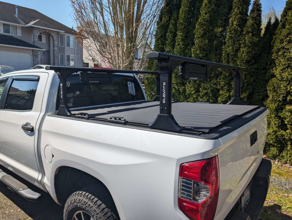

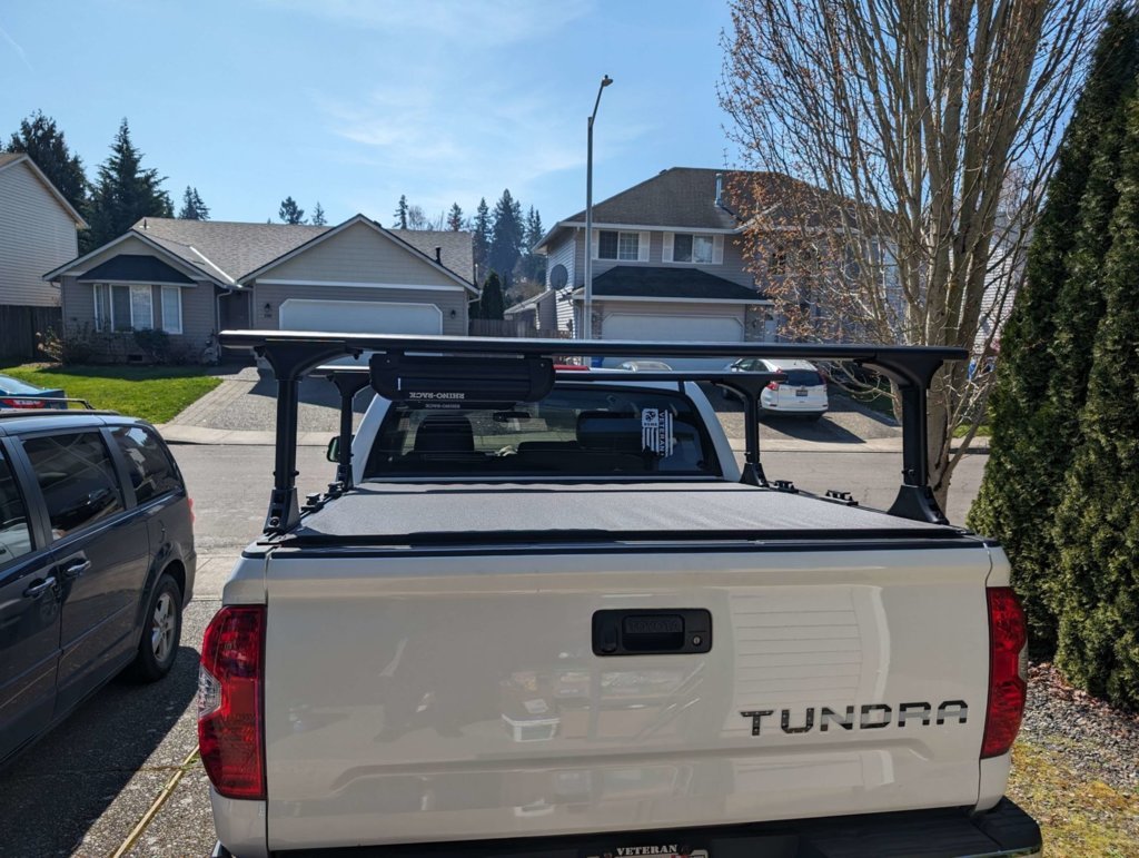

    Look at RealTruck. They have an option for the Elevate Rack. Several of us on the Forum have it...here's what mine looks like

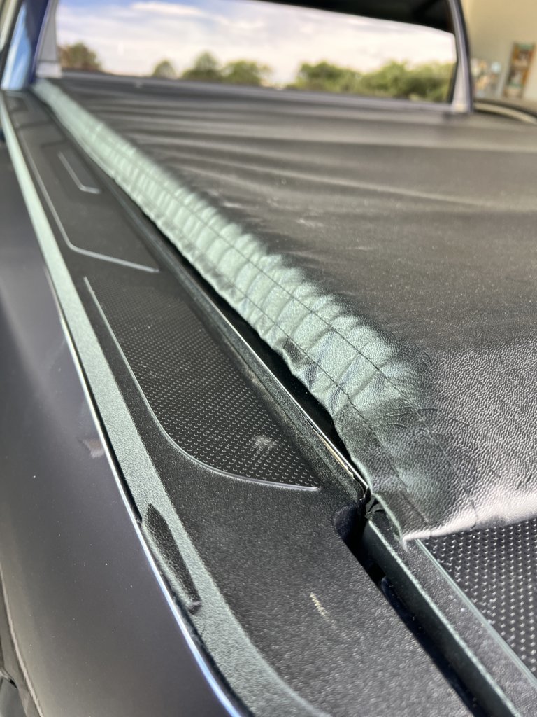

    If you could send me a photo of your truck's rail system using the Elevate Rack System, it would be great.
    Here is my truck's rail using the cover. Thank you!!!

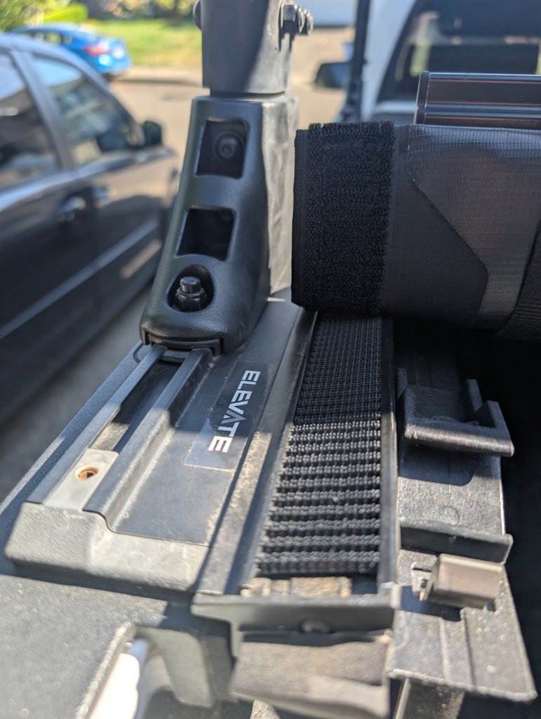

    Elevate uses T-slot rails that attach in conjunction with a tonneau.
    I can get some pictures of the inside later.

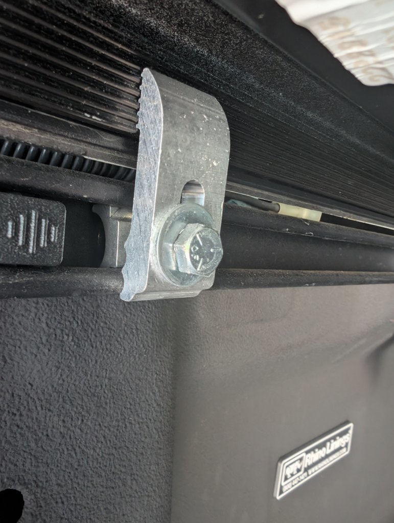

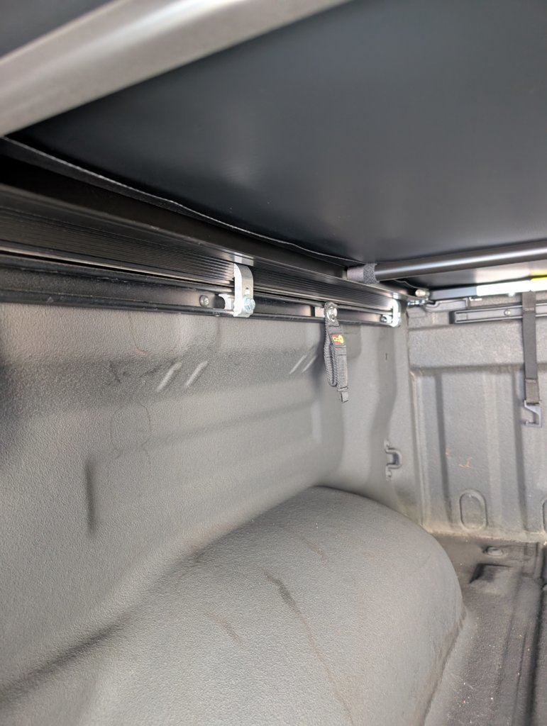

    Here ya go. The rails for the Elevate Rack are placed on the bed rail first, then the rails for the roll up cover is mating next to them. Held together with clamps using the Toyota bed rail system.
