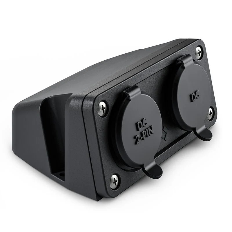

    Considered this as well for the truck bed portion of my Go Fast. Wiring a cigarette outlet from the battery or something similar was best I could come up with, like a dometic DC hardwire style to simultaneously power the Dometic in the back.
    …Ended up with USB rechargeable fans for the truck when my dogs were in there and a portable battery to run the dometic on solar.
