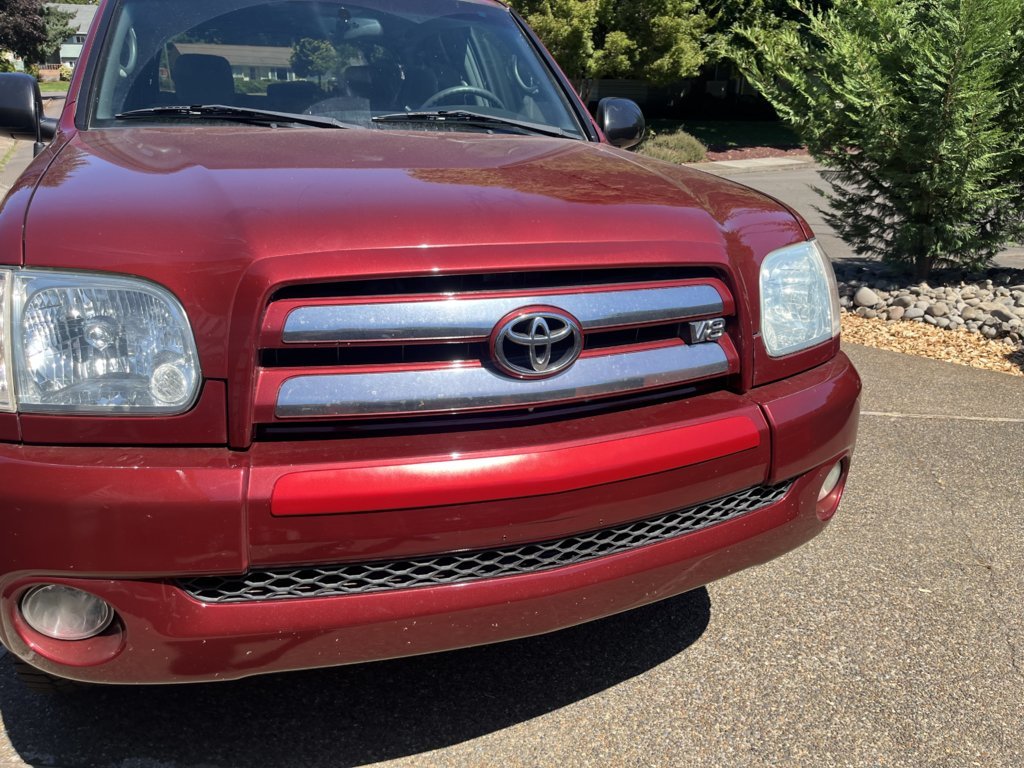

    IMG_3761.jpg I’m am full send on operation de chrome this girl. I opted to use dupli color match paint for the front bumper moulding piece. I think the quality of it turned out good but the color match is quite a bit off… am I just being picky or should I just paint it black? The other option I was thinking off would be to paint the entire lower bumper that wraps around the fog lights black. Looking for honest feedback? Thanks!

    I think the black would look good. Is the red that different in person?

    good effort, but it'll stick out like a bad repaint after a fender bender. I'm sure some won't notice, but it sounds like you will. Just my measly .02. Id go to a parts store that sells auto paint, they'll mix up spray cans in your color code, then use Y2K clear coat. Its a 2 part clear with hardener in the spray can you puncture and mix before you spray. It makes spray painting look good. Check out You Tube University its pretty basic with excellent results.

    it’s about what you see in the picture.. it’s noticeable to me. I feel like just painting the moulding black would look like an odd mustache.

    Yeah, I think the black bumper would bother me more than the color matched paint being off.

    I can see it popping a little but that could also be the fact that it’s new paint on a 20 year old truck.
    I’ve seen a dark red truck in town that has the chrome painted black on the bumper and grill. I think it looks good.
    You could wrap the chrome in black or another color and it won’t be permanent. I did that on my truck and I’m happy with it.

    Sun faded color and new factory color is really hard to get matched up perfectly unless one is a well seasoned pro. Just paint the whole rig, accept a difference, or pay top $$ for some serious skills.

    Well thank you everybody for the feedback! I looked up my code and ordered a kit from automotive touch up. I’m not expecting it to be perfect but hoping I can get it a bit closer than the bright red lipstick I just put on it! Stay tuned for attempt 2.0!!

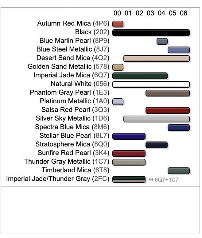

    Just in case you need it.

    thanks! I found this earlier and confirmed the color code on my door jamb sticker. Salsa red.

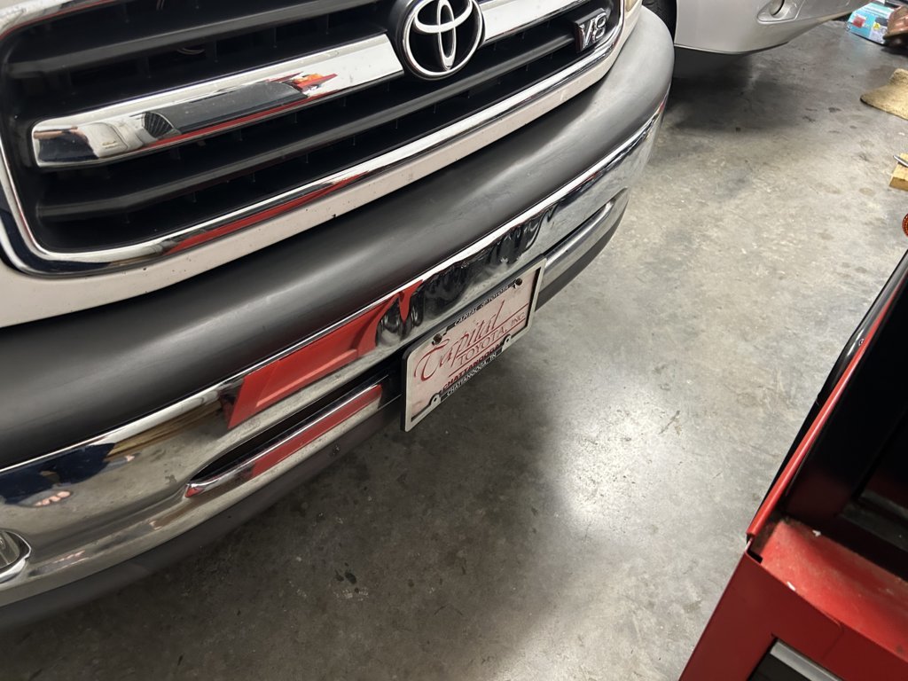

    I don't like the chrome accents either......especially don't like the chromed side mirrors and fuel tank door.
    I did get OEM and junkyard door handles....going from chromed to white. Hope to get those on this fall or over winter, assuming we clear enough space in the new garage to put the truck up for winter.

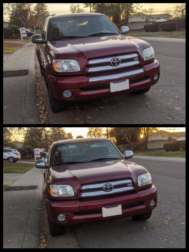

    I'm trying to think whether I've ever seen an Autumn Red Micah 1st gen before. I'm not sure I have. Looks like that and Platinum Metallic were both 1yr-only options.

    I just noticed on that list that 2003 did not have a blue option at all. Well, when I decide to get my own Tundra and not the one claimed by my daughter, if I want blue, it will be an 05 or 06 most likely. I do like the Jade green too. That's the color of my dad's Tacoma that he wrecked before buying the Tundra.
