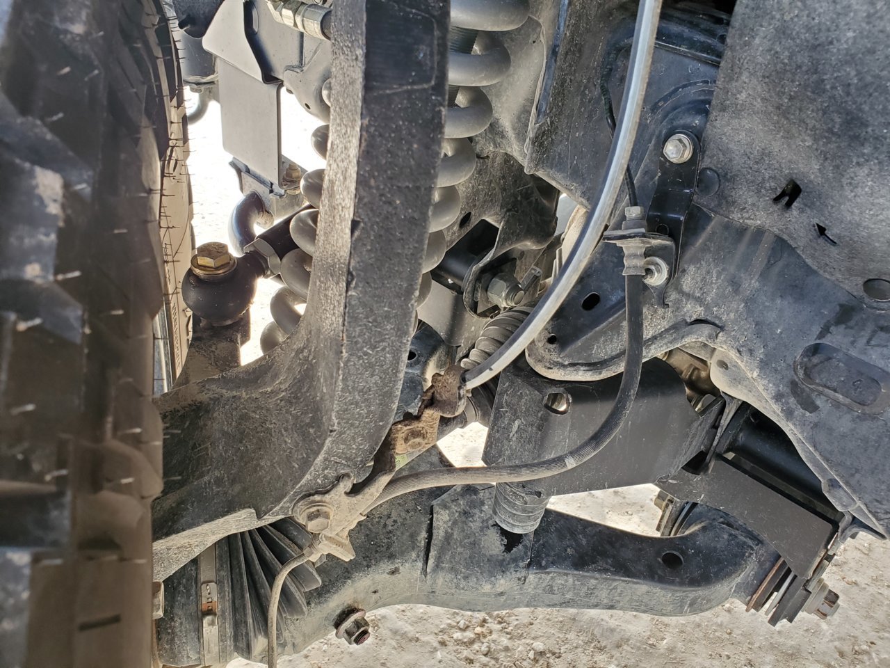

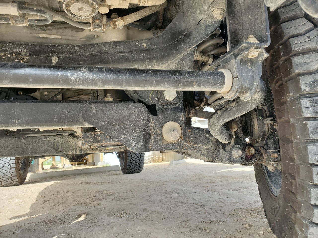

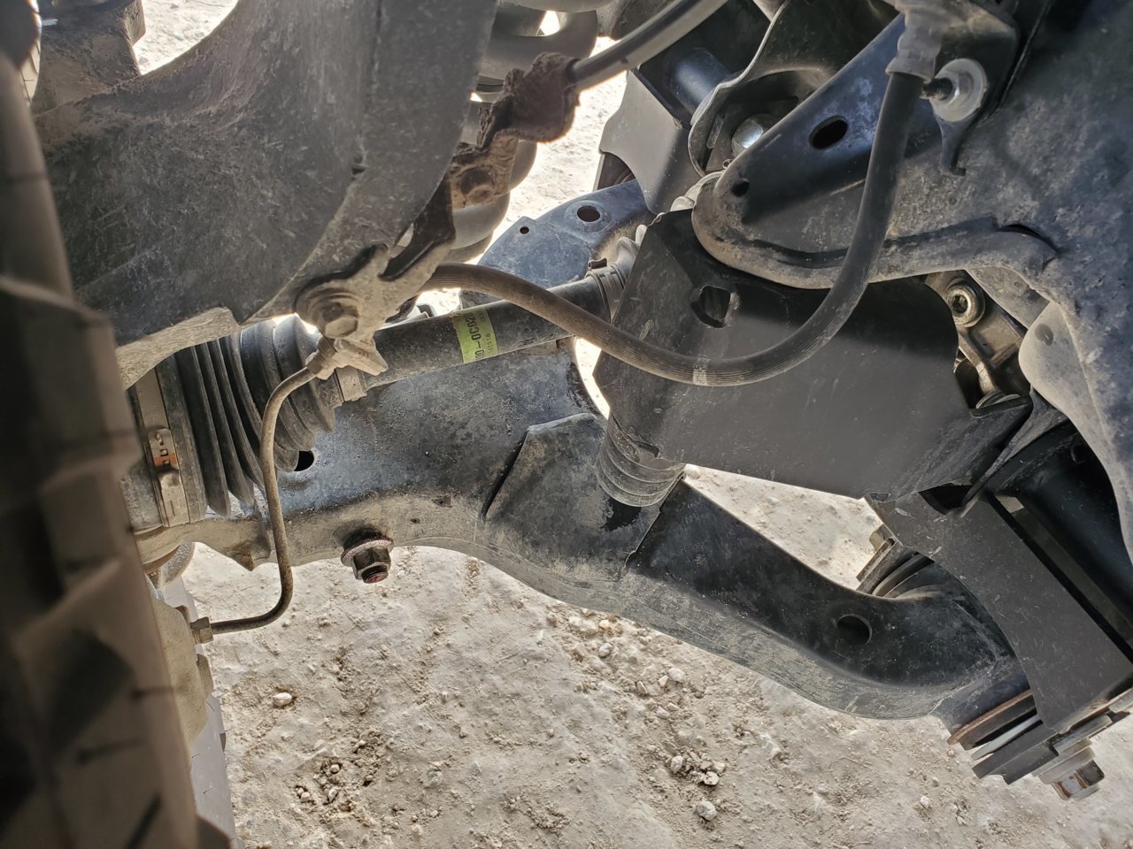

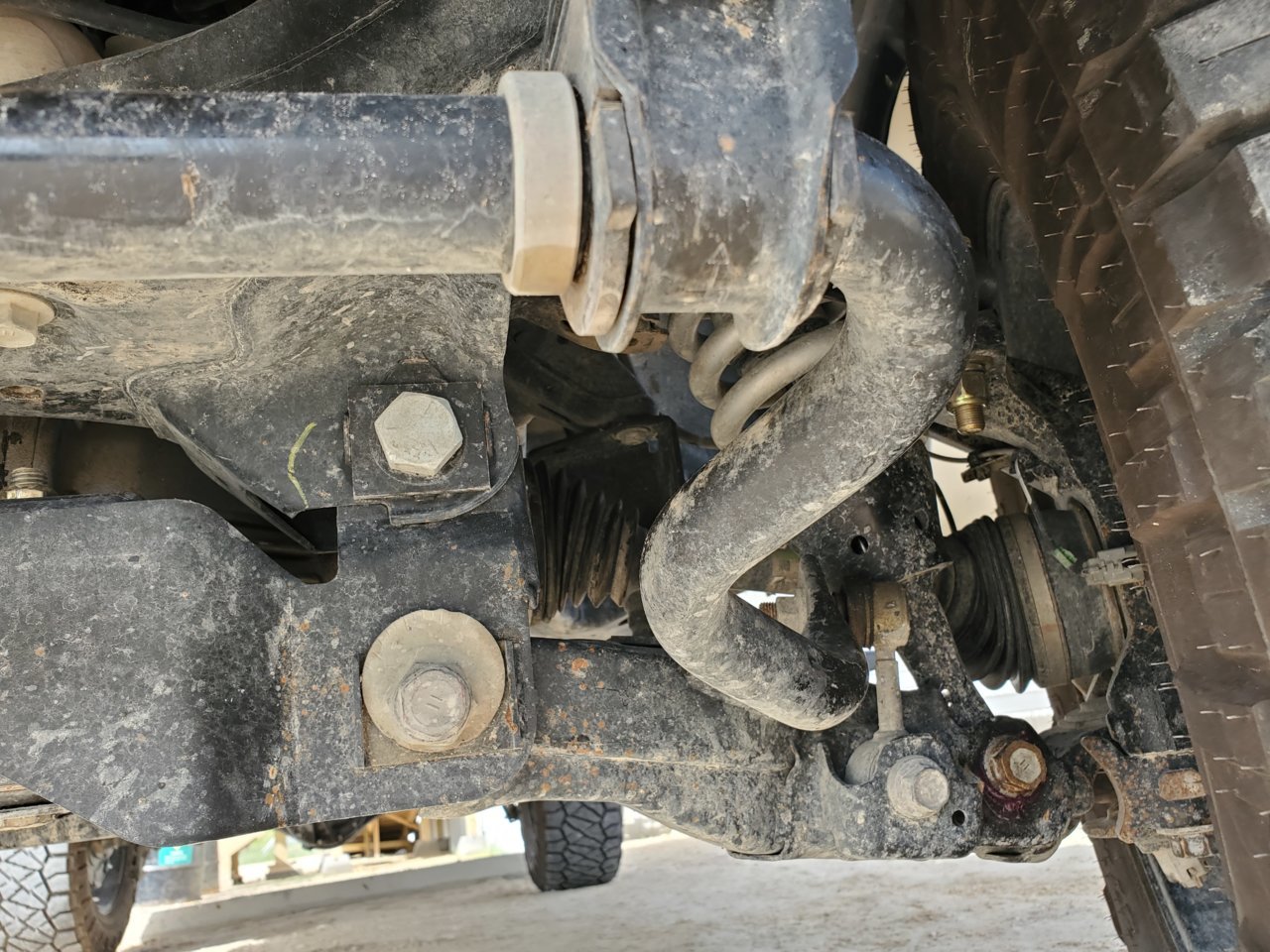

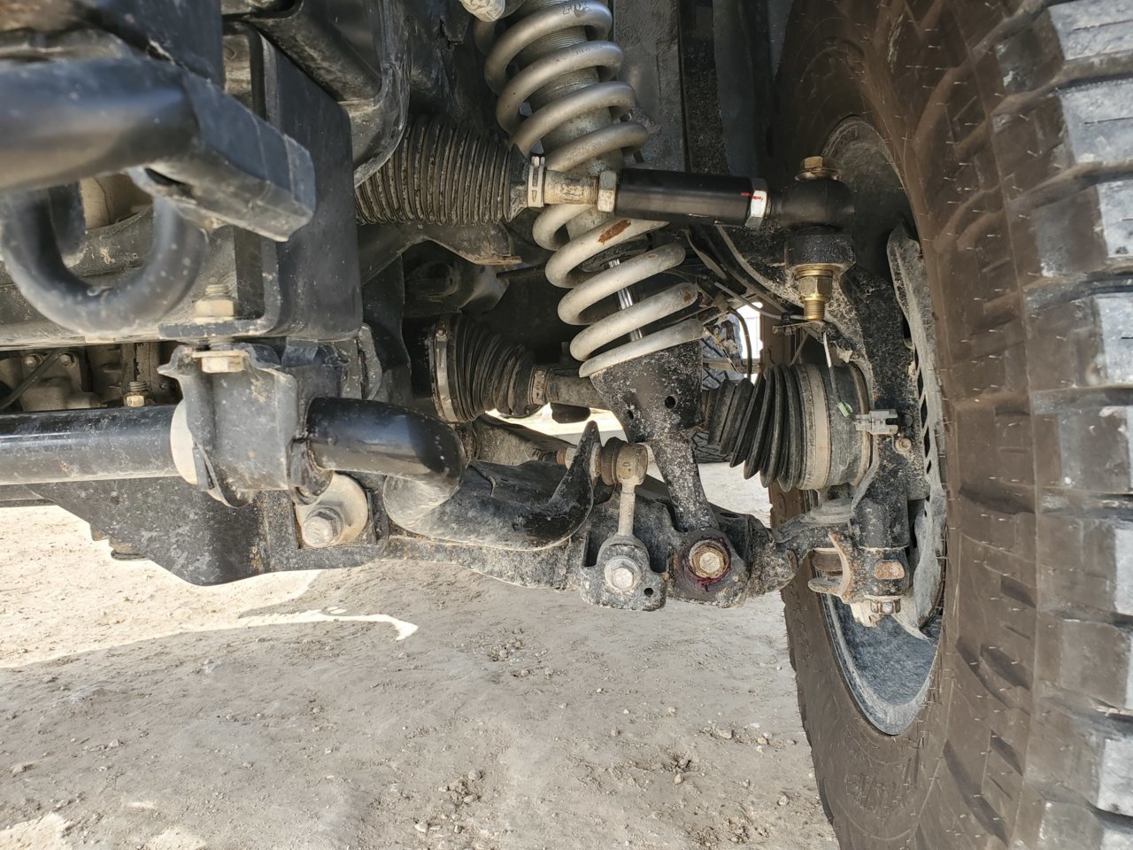

    20190629_093126.jpg 20190629_093135.jpg 20190629_093141.jpg 20190629_093147.jpg 20190629_093212.jpg 20190629_093217.jpg 20190629_093225.jpg 20190629_093239.jpg 20190629_093247.jpg Morning,
    I have an issue with my tie rods rubbing the spring on my coilovers. It's on both sides. I've had it realigned twice, added coach builder ends, still rubs at full turn.
    I'm running Fuel Crush wheels 20×10 w/ -18. Wrapped in Nitto Ridge Grapplers 37×13.50×20
    I read through all the posts I could find about this issue, and brought up every scenario to the shop that did the work. Nothing has fixed this problem, if anyone has info that would help it would be much appreciated.

    I believe this is a common issue with bds and fox coilovers. It’s a known design flaw from the new suspension components and where the shock mount is and the size of the coil. Don’t think there has ever been a fix other than swapping coil overs.

    Try moving your coils back as close to the axle as possible with an alignment. And swap back to stock tie rods.

    Problem with that is now you’re adding more positive castor. Most likely too much. Which will put added strain on the rack and pinion with the big wheels and tires. Too much cause and effect with trying to fix this setup in its current state.

    You’ll get less caster and it should be very little. And I’d rather have less caster than hit my coils.

    It’s not the coilovers. There’s nothing you can change on them other than putting on a smaller diameter coil. It’s the BDS kit.

    Procomp makes a redesigned tie rod that has a bend in it. Not sure if you can purchase it on its own or if it only comes with the kit. Give them a call. It might be what you need.

    Do you have the factory tie rods still? Try installing them on the opposite side aka left tie rod on right side and right tie rod on left side

    They swapped them at the shop the last time I was in there. And then added coach builders. Still no fix. I'm going to look into the pro comp ones, thanks for the info
