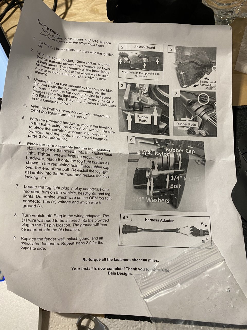

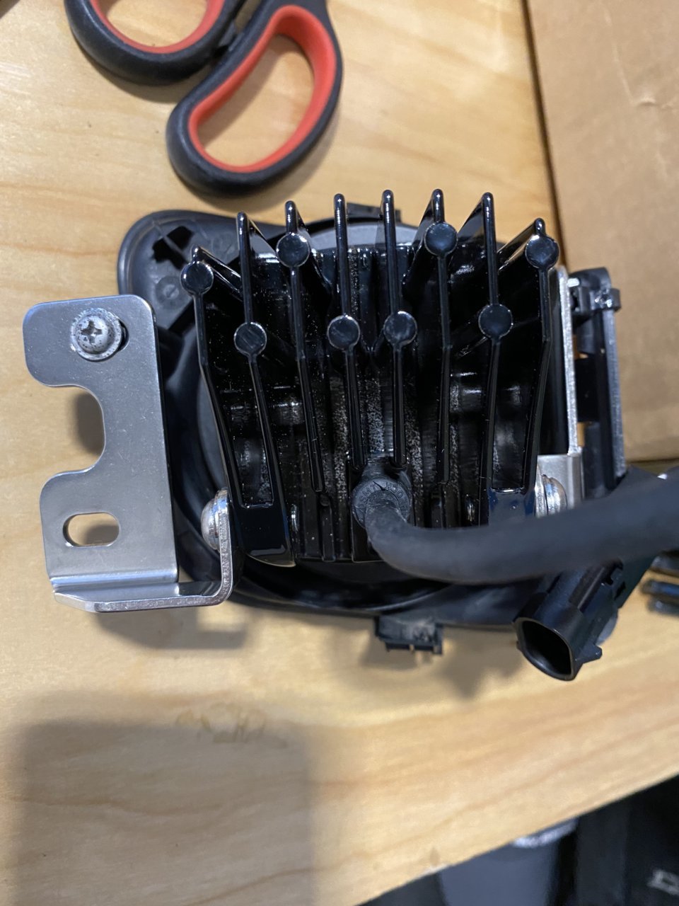

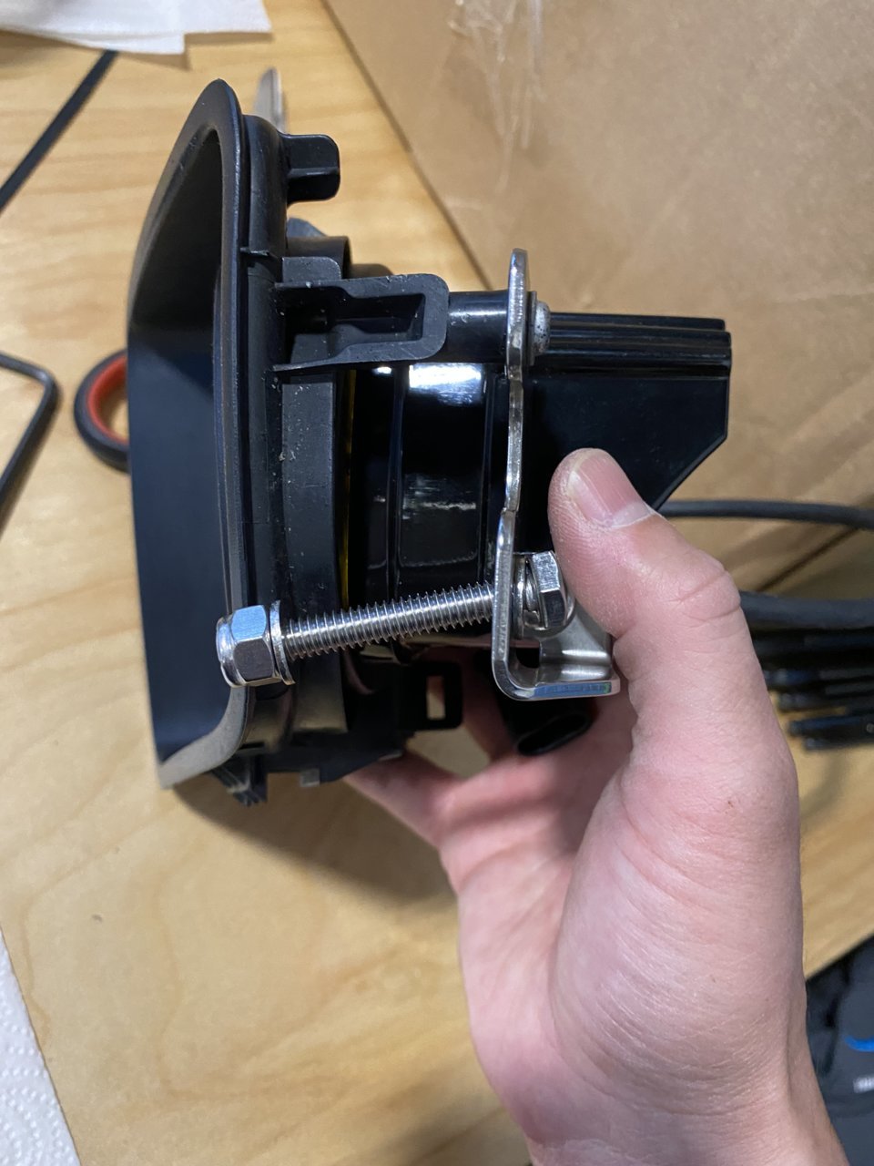

    Here’s what it looks like and the instructions… also they included the rubber pieces, but the fitment seems good?

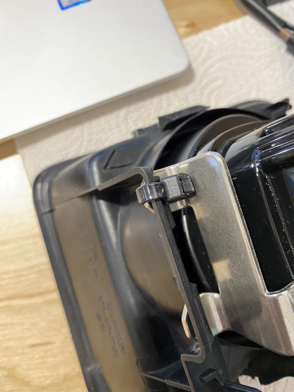

    So I took a zip tie to one of the tabs to keep it secured.

    I think the zip tie has been a required addition for BD fog lights in other gens as well.

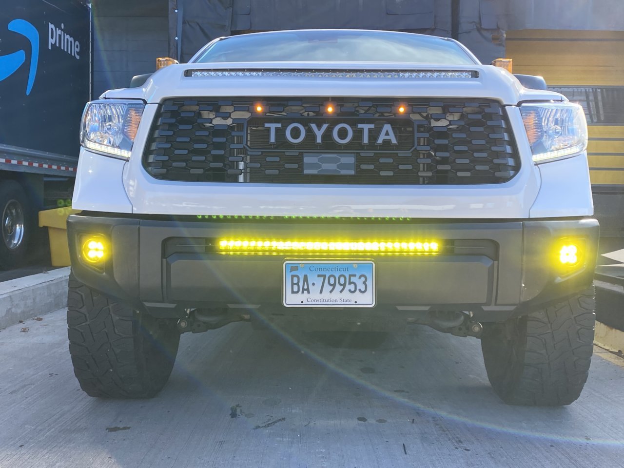

    Well got them installed without the extra 1/4 bolt and the rubbers.

    Hell ya. Looks great

    Is that the bajadesigns 30 inch light bar? Where did you locate the light switch inside?

    Actually I’m just running an Amazon amber light bar. But all my aux lighting is ran through my Auxbeam switch panel.

    nice! what light did you get? sqaudron sport? or SAE?
