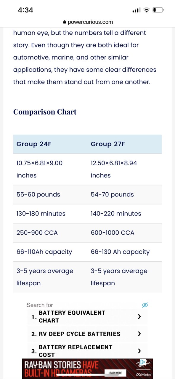

    I skimmed through 2 articles about the differences, but both seemed like they were written by doofuses. my battery tray will fit the 27, so the better deal would probably be whichever is cheaper?

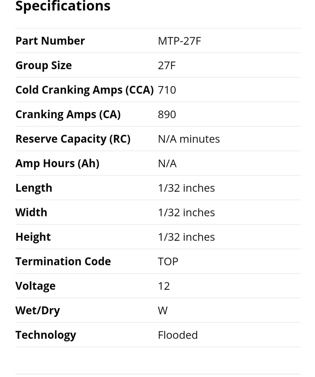

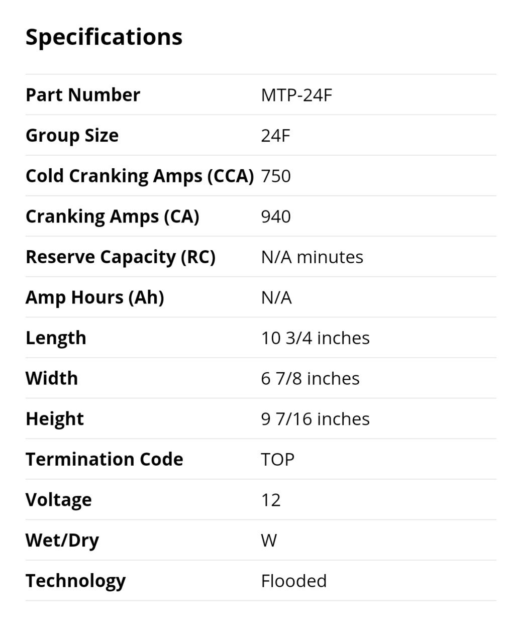

    What battery specs are those for as I see the 27F has higher numbers then the 24. The interstate is the opposite.

    27f seems to be the go-to for the towing package trucks according to toyotanation and tacoma world. I replaced mine with what was in there cause like 4 of my vehicles use 24f, and shuffled em around so i could trade in the oldest one.

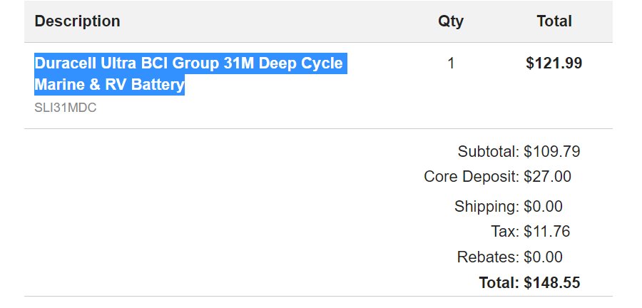

    I found the largest you can put in the stock tray, its tight but it fits. 31M
