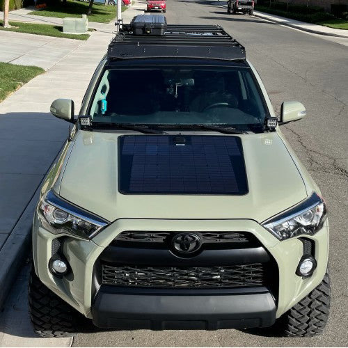

    Unfortunately the truck is parked in front of the house on a public parking space and I can’t pull an AC over the side walk… however, I read in a different forum about a small solar panel with a DC-DC charger, which might be a good option for my use case. I hooked it up to a charger for a few hours and all is well again. The battery was not completely dead, just not enough to crank but the car display showed around 9V prior charging. So, don’t expect a damage but I’ll be more careful in future.

    Living in the bay area, where I'm from BTW, I would be hesitant to buy a solar charger. First, it's cloudy a lot certain times of the year, and second, nowadays, it would probably get stolen.

    I hear you. Living in the Bay Area myself (on the peninsula). I’m not too concerned about the weather. We rarely get fog or overcast but for sure, you couldn’t leave it on the truck unsecured. I consider gluing a flexible one on my RTT though that I could also use for a dual or portable battery. Not sure yet which route to go. Using the truck once a week is probably the easiest option…

    There are low profile magnetic solar panels for trickle charging. Could put on the roof/hood/bed top in a semi permanent install and not likely to be messed with.

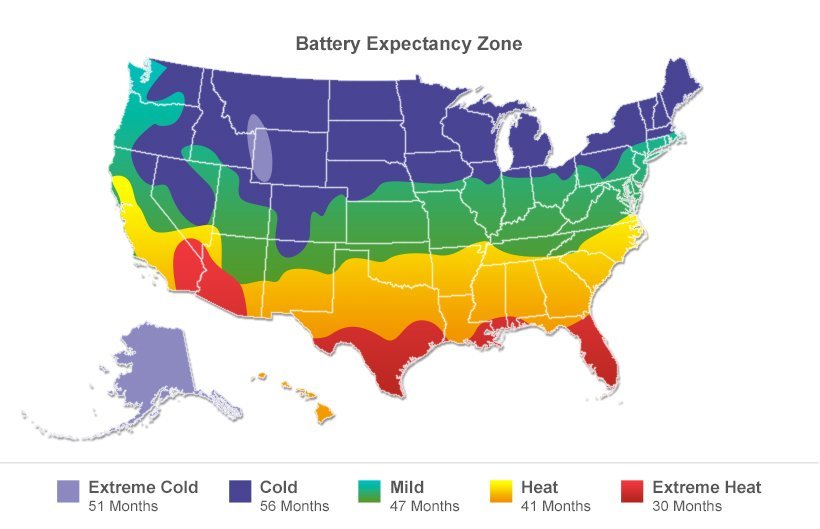

    Battery life is very dependent on average temperature, with the southern states batteries not often making 3 years while northern states, especially where I am we often get 6-7 years from the original battery, to the point most people have never replaced a battery as they sell the vehicle beforehand. But this all assumes daily drivers.

    Yeah, I’m in Phx. If we get 3 years out of a battery, it’s a win

    For sure. I think regular use to avoid deep discharges and the range of operating temperatures make a big difference in the life of a battery. I am in upstate NY so the weather is not exactly sunny and comfortable year round, but the batteries do seem to work out for me, providing they are quality units from a reputable manufacturer.

    That's kind of how it is in FL. If you buy a battery with a 3 year warranty, you'll never have to buy a battery again. It will most definitely be dead well before that, especially if you're parked outside.

    Mine usually last 5 to 7 years. If we have a summer of 100+, that always seemed to kill it after 3 years.
