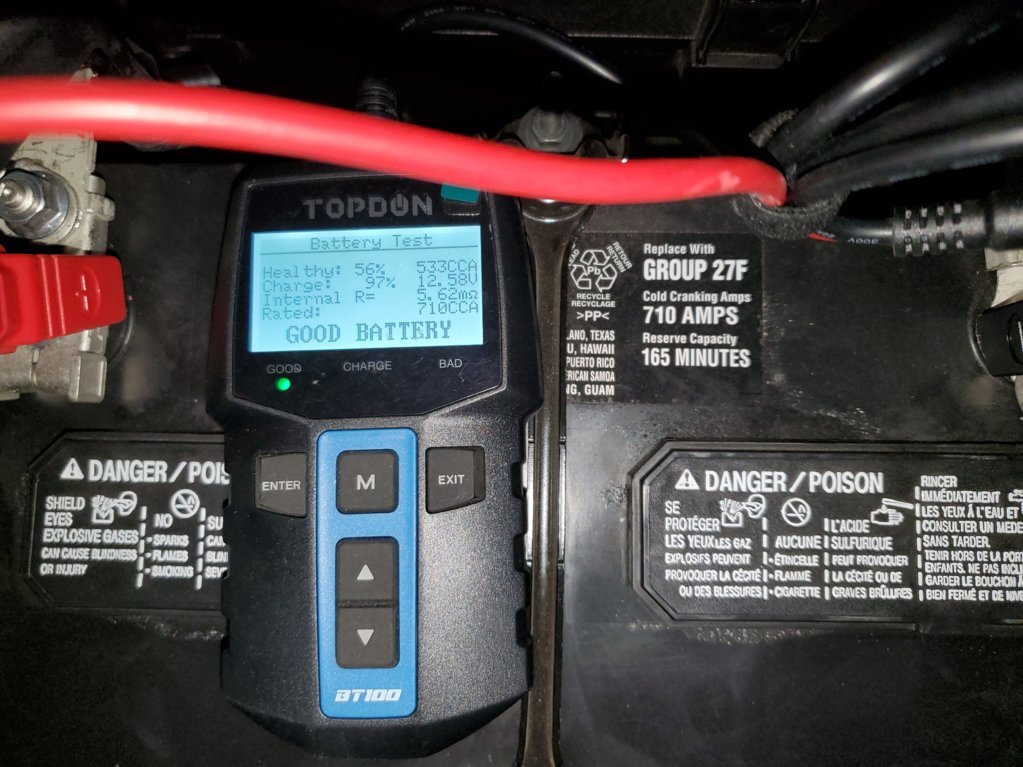

    I have a TopDon battery/starting/charging tester that seems to be pretty accurate, and I highly recommend having one around and also one of the Li-Ion jump starters, I have a NoCo GB40. My battery is nearing end of life (Manufacturing date 9/20, battery stamped 28/08/20, 8k miles). For my own batteries, it makes a big difference on battery life if the vehicle is garaged or sits outside and the biggest factor seems to be the cold. I have a lot of batteries to keep up with and normally just get mine at Sam's Club, Duracell brand when on sale, I'd go Costco if we had one. The AGM batteries in my F250 7.3 diesel had a sticker date of 11/13 (AutoCraft Platinum Grp 65, now DieHard) and just replaced them. I also recommend a battery tender but check the output voltage, return/exchange it if it's above 14.7v in use.

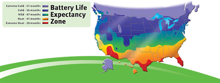

    My OEM kicked the bucket at 10 to 11 months. From what I have read heat is harder on batteries then cold temps.
