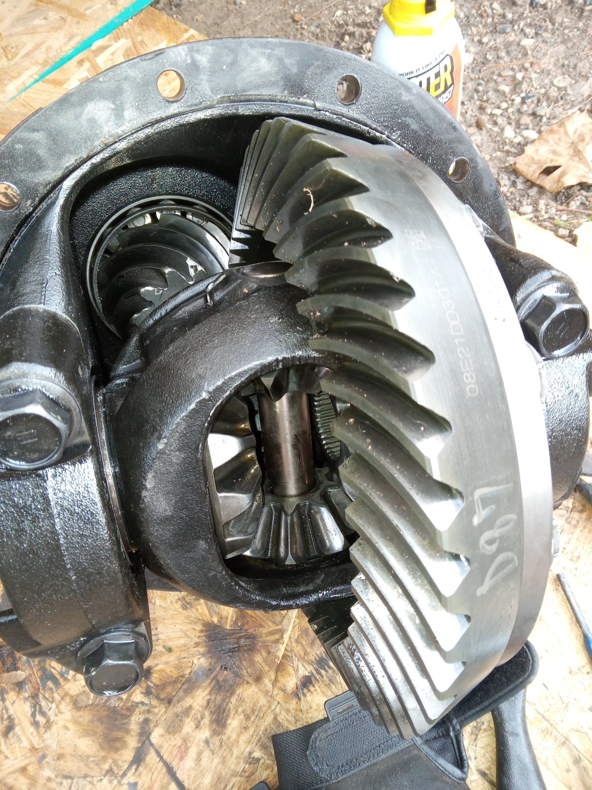

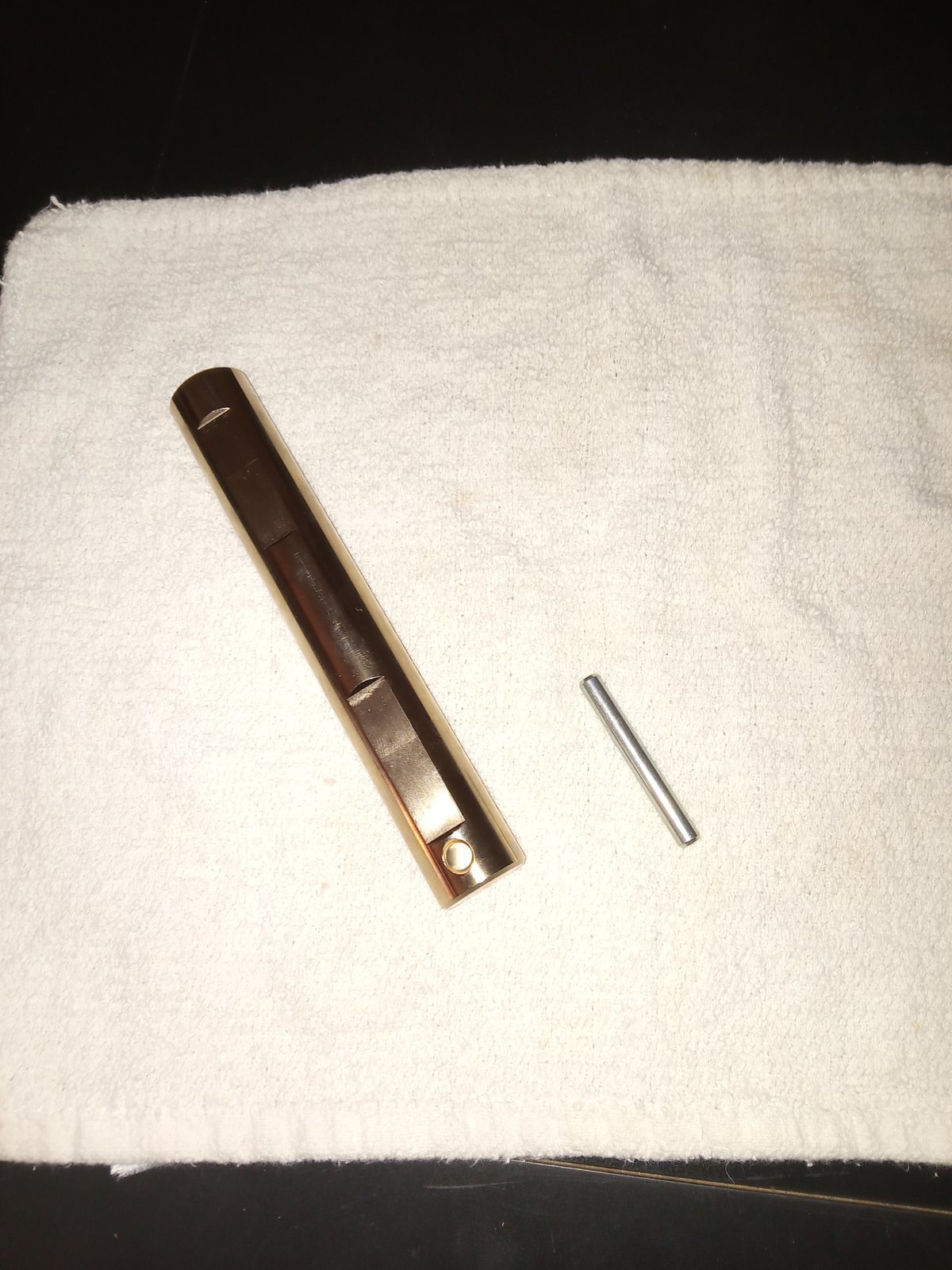

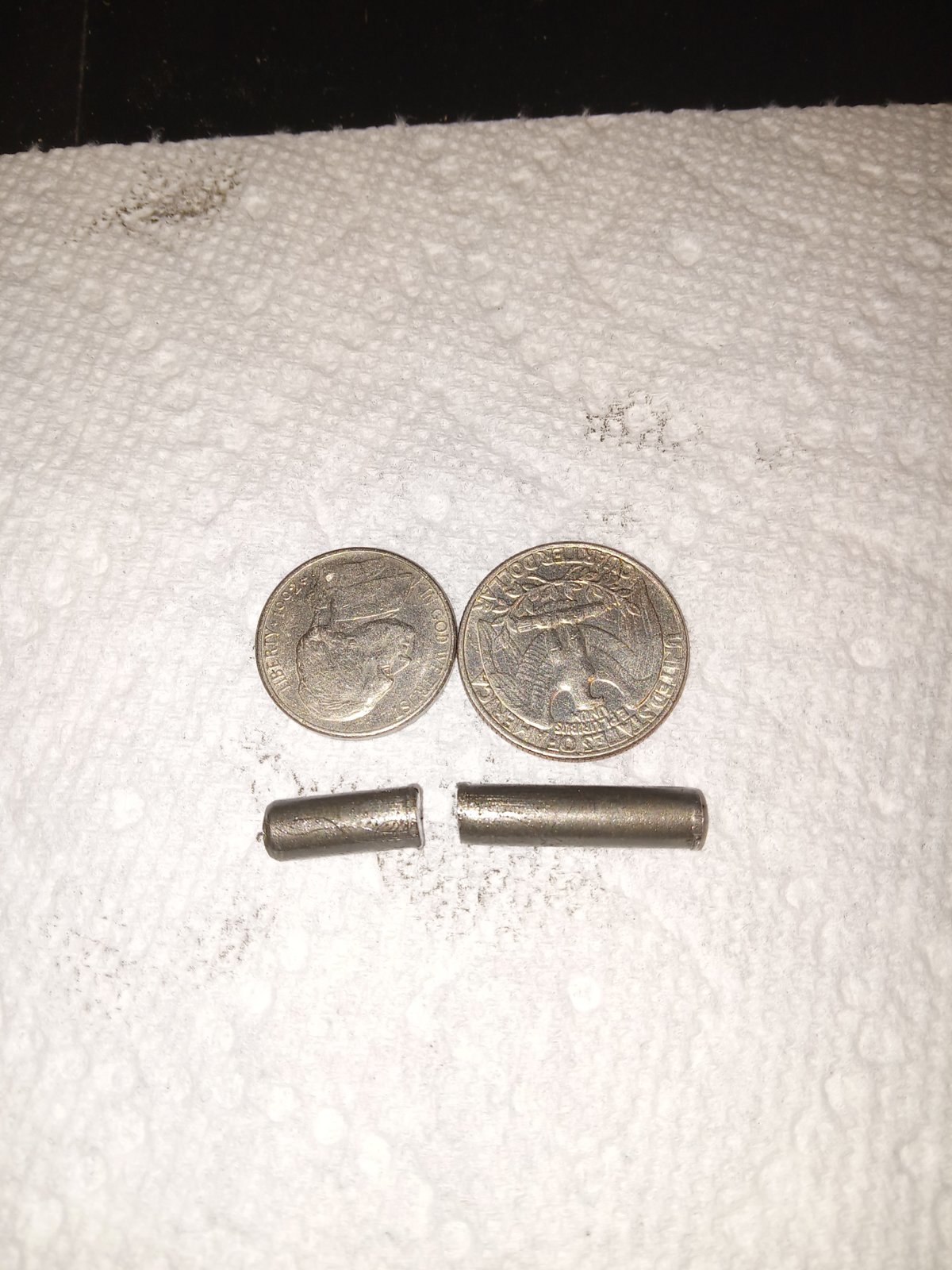

    Hey all. Here to tell you about a common tundra issue if you do a lot of heavy towing.for two months it sounds like someone beating on my frame with a hammer ⚒️ Everytime I let of the gas. Maybe one bang maybe ten..turns out after tearing the rear end apart it's the keeper pin for the spider gear pin..broke..lets the pin slide and hit the ring gear..hope this help someone with an unknown bang bang noise.both pins are 105$ from the dealership.

    Apparently this is a frequent, if not common failure on our trucks. My '07 w/160K had broken this pin but not spit anything out. If I didn't pull the 3rd for Zuk to install a LS, I'd have kept driving it and it had no symptoms. Ended with a little scuffing of the ring gear outside of the engagement area and still running it 15K later.

    Good to go now I hope..new pins a little machine work on the gears all in all with parts and fluids and such about a 300$ repair
