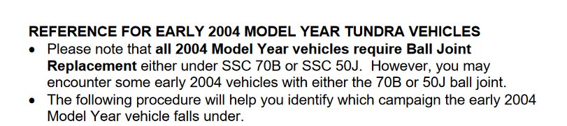

    I think the '04 model years produced prior to September 2003 have little ball joints, and those after do not. I can't recall ever seeing a DC with little ball joints, but doesn't mean they aren't out there.

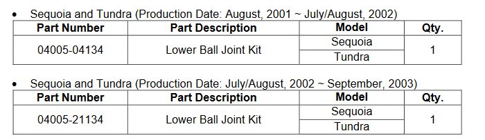

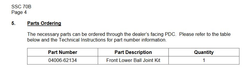

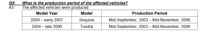

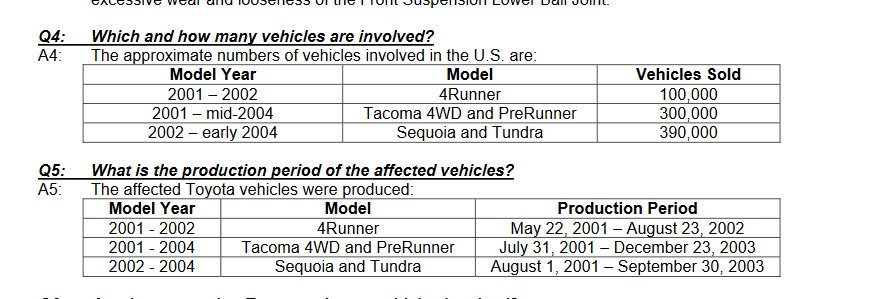

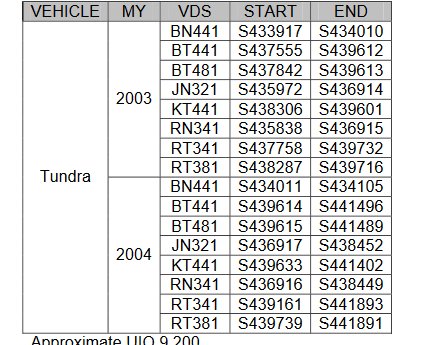

    Here's some snippets from the recalls --
    Little ball joints:
    Little ball joint VINs:
    Big ball joint recall info:

    des2mtn is correct in that the early 2004 tundras were a mixed bag of either 14mm or 17mm with 09/30/03 production date as reference cut-off. The SSC instructions for 04 were simple because Toyota could not separate out by VIN. Either the LBJ bolts were 14mm or 17mm upon visual inspection and were replaced under the SSC 50 (14mm) or SSC70B (17 mm recall campaigns, respectively. The spindles were also obviously different between the two.
    Subsequently, TMC acquired the VIN LBJ info by replacement campaign code data submitted by the dealerships during recall. Who knows if the data is incorporated into the new TMC online autoparts database because the new system is a crapshoot for 04 parts identification.
