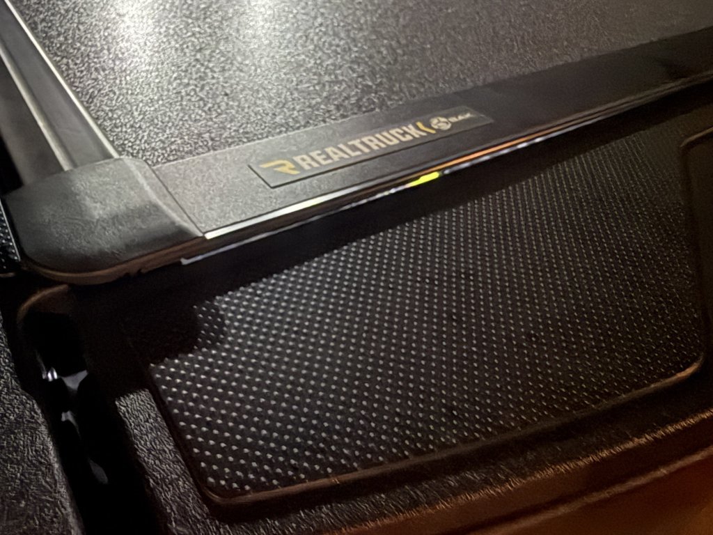

    Hey all! Picked up an MX4 that had been on someone else’s Tundra for about 6 months. Great condition, great deal, but when getting out of the truck tonight I noticed there’s quite a bit of a gap at the tailgate. The instructions say to push the cover up to the bulkhead as far as it will go, but perhaps I just need to pull it back a bit towards the tailgate?
    Just curious if anyone else has had this issue? I’m sure it will leak based on the amount of light that’s visible from the bed light that comes through. (Yes I know that no cover is really waterproof)
    Thoughts? Easy as just pulling it back? It seems to push up the tailgate when closing already so wasn’t sure if this would cause an issue with closing by pulling it back. Thanks!

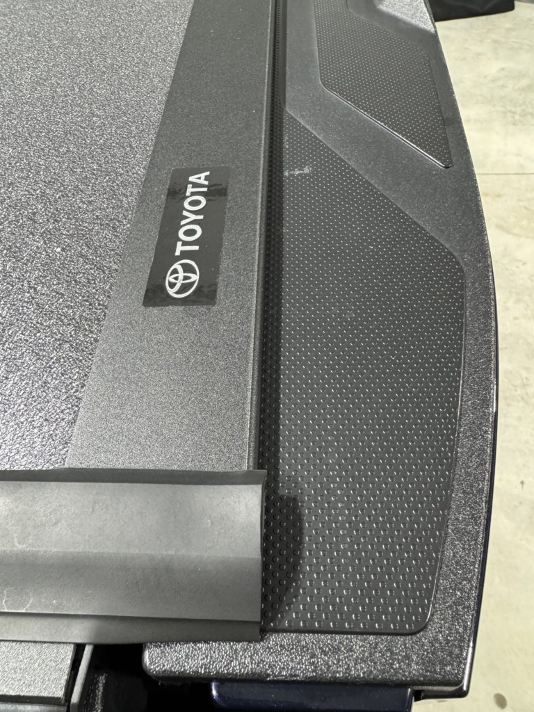

    Looks too far forward to me. Pictures of how mine is positioned in the front and the tail gate. Very happy with the bedcover.

    IIRC, the instructions say to push the forward mounting tab as far forward as possible. Then the cover is adjusted in the elongated slot fore-aft.

    yes. Perfectly. Even with the back panel latched. It's a very good fit. I have it positioned so the three wipe strips sit on the top of the tailgate.
