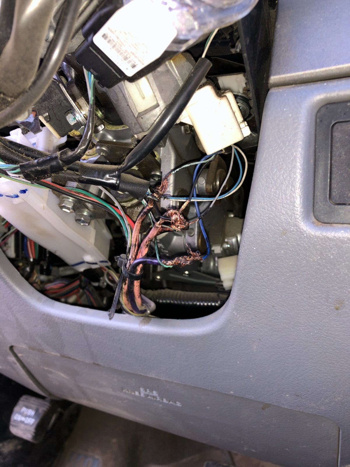

    We’ve got a winner 2mchfun! The short is in the steering column. When I retract the steering wheel everything comes back on. I’ll pull the wheel and cover, find the short and let you know. Thanks!

    Why would anyone do this?!

    Man seeing shit like that burns my ass! Then people either get paid for that or they pat themselves on the back for doing such a good job.
    Very good in finding that before things caught fire!

    His name was Bubba.

    Sorry but after seeing that I would be all through my dash looking for stupid shit

    Maybe trying to steal it:notsure:
