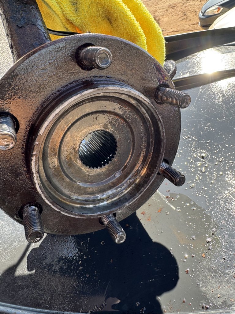

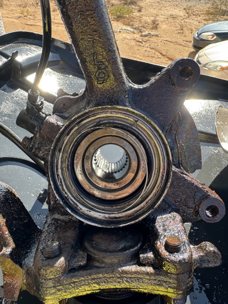

    Hello. I have a 2005 Toyota Tundra that needed a wheel bearing replacement and thought if I ordered a used knuckle with a good wheel bearing it would be an easy swap. I Got the used knuckle and it looks like the wheel bearing is also shot but I need your expertise. Picture 1 is the old wheel bearing/knuckle and 2/3 is what I got used from car parts direct with a rusted dust plate that I had to take off. What do you recommend?

    Thanks sirfive! Does the original look salvageable?

    I dont know, you’d have to get both inner bearing races off, and make sure nothing is chewed up. The ‘new’ one might just need a seal.
    maybe someone thats done it knows if there are ‘inner’ seals, since i see some of em are marked as ‘outer’ seals.

    You've gone to the expense and hassle of getting a new/used knuckle. You'd be crazy to install it without first replacing the bearing and seals -- it's so easy and economical to do with the knuckle off the truck. Are you planning to do the work yourself?

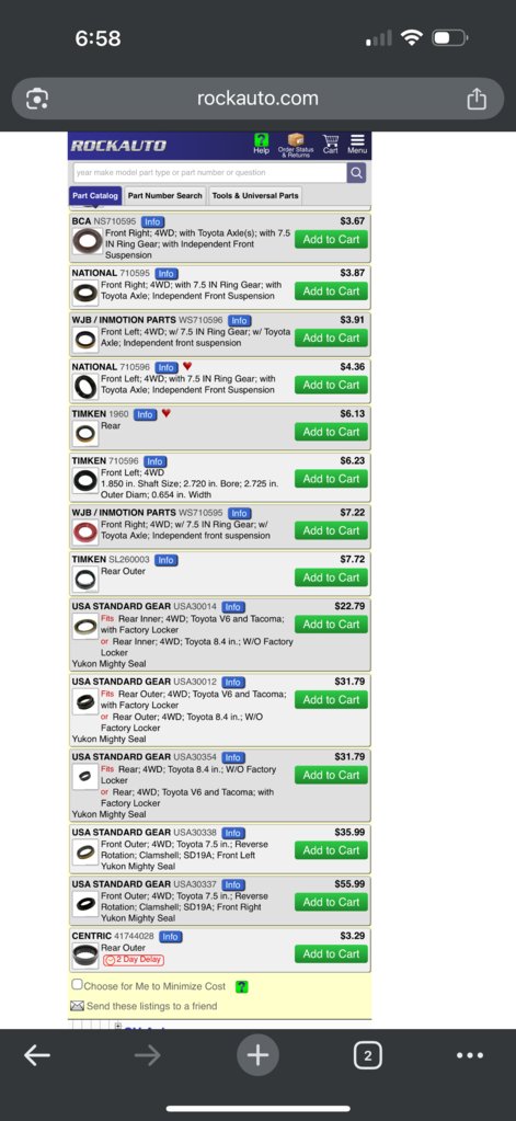

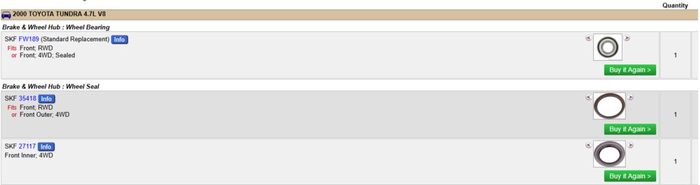

    Here are the parts for my 2000 AC. I don't know if they are different for your truck because you don't have your truck info in your profile. You need to add that info so people can better help you.
    Go to your profile and add the year, cab style (RC, AC, DC), trim package (SR5 or Limited), 4WD/2WD, and engine (V8 or V6)

    Rock Auto didn't have Koyo, so I went with SKF -- which is another quality bearing company. In fact, SKF is the OEM supplier for the rear axle bearings. I would feel comfortable with Koyo, SKF, or Timkin.
