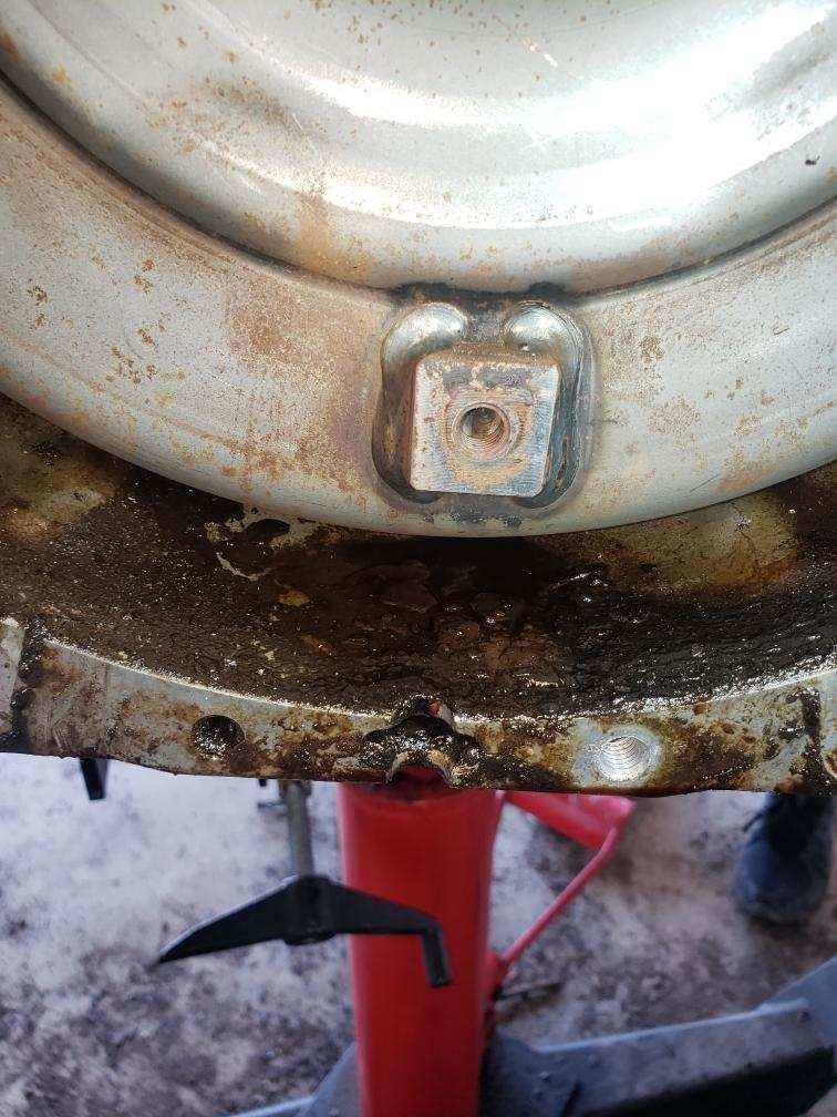

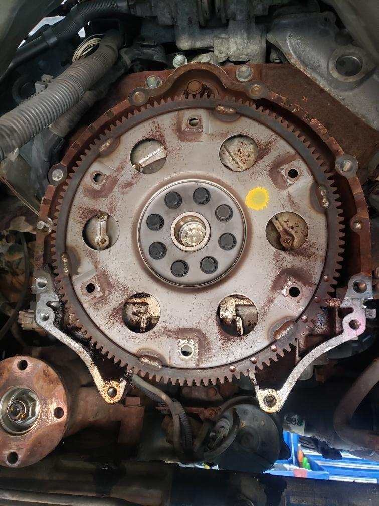

  11. Jun 16, 2021 at 5:12 AM
    gargra03
    gargra03 [OP] New Member
    Feb 12, 2021
    #58990
    23
    Gary
    2005 Tundra DC
    leveling kit MT Tires LED Camper Shell
  12. Jun 16, 2021 at 5:16 AM
    Professional Hand Model
    #14878
    14,993
    Fred
    Hand Protectors
    Thanks for the pics. Looks like you’re tracking things back to the Transmission being the leak?
  13. Jun 16, 2021 at 5:24 AM
    gargra03
    Feb 12, 2021
    #58990
    23
    Gary
    2005 Tundra DC
    yes sir, at this point it looks to be more of a transmission leak and the flywheel is coming out today. Should know more once that happens.
