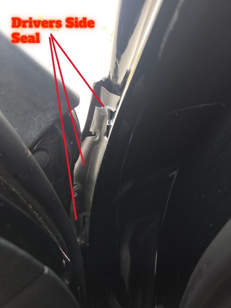

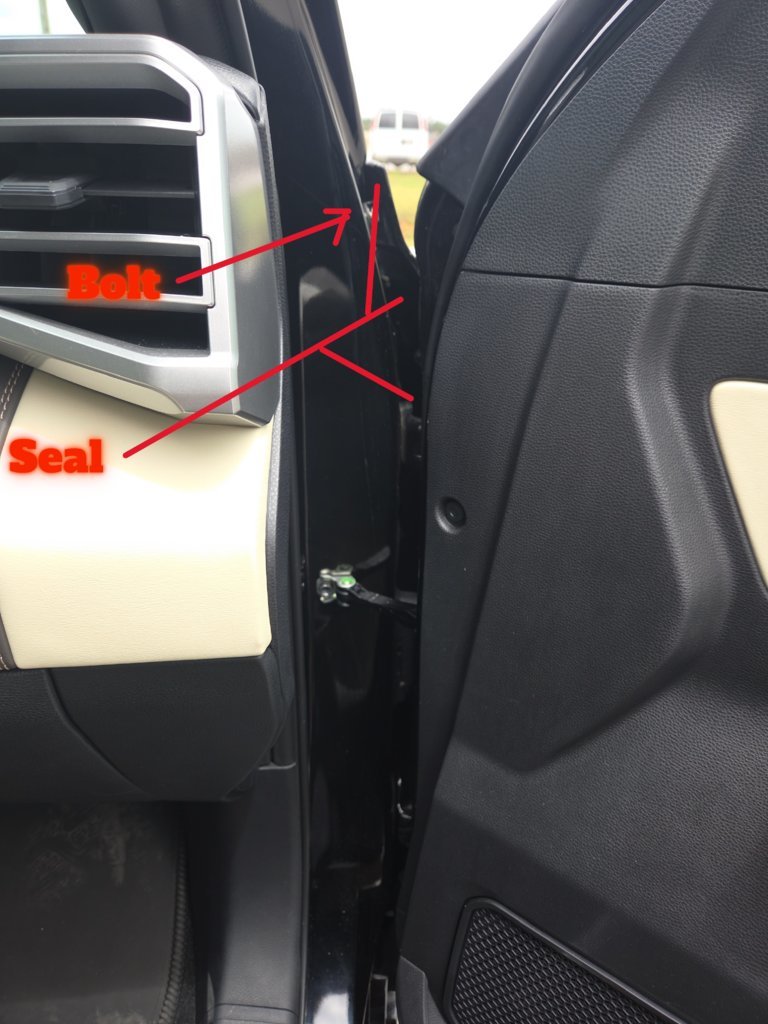

    35 years of Ford and just bought 23 1794 at 18K miles. It had some RH front end work done from previous accident. I thought I thoroughly checked but just did not look far enough into the door jam. Also had sales rep in car when I went for test drive and did not hear it. While driving it on interstate, wife heard wind noise like window was down but I could not hear it from driver seat. After researching found seal for front edge of door was just sitting there and I reattached at the 4 points. Then right below window in same area was a loose bolt that I could turn with hand. Lastly another seal just forward of the door on truck body not installed. Only way to see it was to look thru door area when opened. Took back to dealer today and dropping it off tomorrow. Here's hoping they fix it but if not, my own fault but I will leave a review about the experience. I also hope this is not a sign like the Super Duties I just went thru - almost 60K in warranty/out of pocket repairs since 2011 (2005 F250, 2011 F350 and 2015 F250). Oh yeah, also got a cracked windshield after 3 days....1f632_978335252ed1bf0ab1cd0df2afc95489f3352403.png1f62d_dd19f9f950fc62683b802097fb3a818945d1dc1a.png
