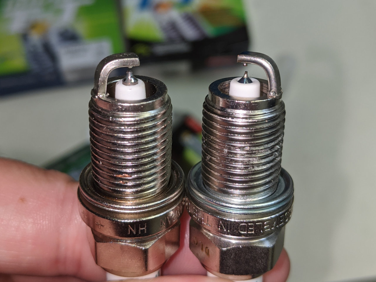

    Get some good pics and I could probably tell.
    Here were my ebay sets vs real.
    1st fake (fake on left, real on right)
    2nd fake (same)
  24. Aug 18, 2021 at 9:14 PM

    This is critical, I would address this before going down any rabbit holes. I also received fake plugs, in a denso box, from a highly reputable Toyota parts seller on Ebay. Amazon and Ebay are pretty much off my shopping list these days for critical parts. They counterfeit everything. If you're new to maintenance, I would suggest a wire style gapper instead of the ramped coin style they sell at the auto parts counter.
