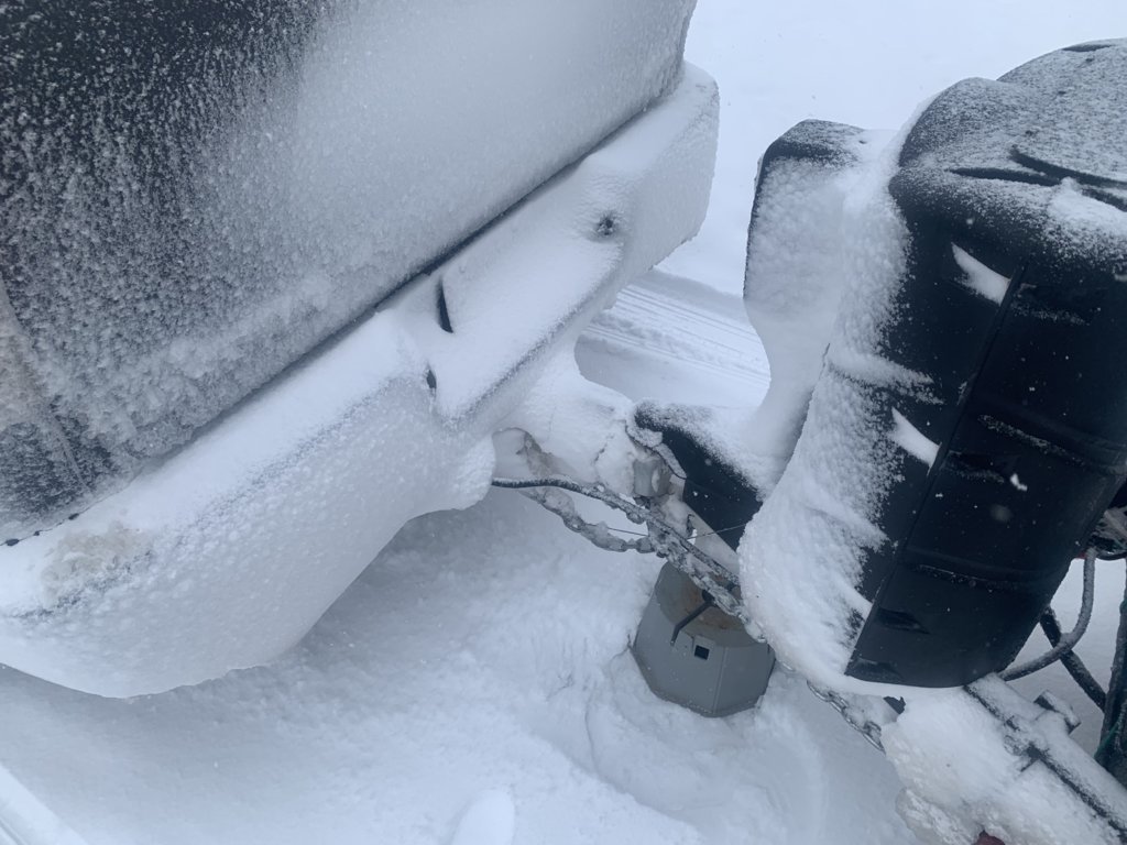

    The noise was strange - I’d been on the road for almost two hours and thought I was driving over the rumble strip and had some change or something rattling around in my cup holders. Considering I couldn’t actually see the road for most of the trip and was navigating by snow markers/reflectors, it made sense. But once I tried paying more attention, it was definitely coming from forward of and under my feet. I pulled over at the next pullout (and snapped that pic) to inspect. I didn’t smell anything or see fluid leaking so I soldiered on. Couldn’t really crawl under the truck with making a snow cave..

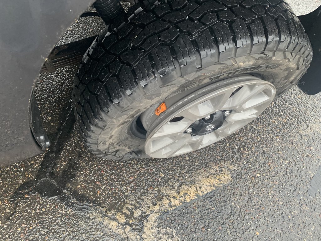

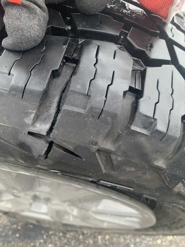

    And as of yesterday wasn’t fun enough, this happened this evening. After unhitching the camp trailer, I hitched up one of my enclosed trailers and drove around town. 3 miles after dropping that trailer, I was cruising down the road in town at 35 mph and ‘pssstt pssstt pssttt… vwomp vwooomp verromp’

    Ouch! That's a nice gash...

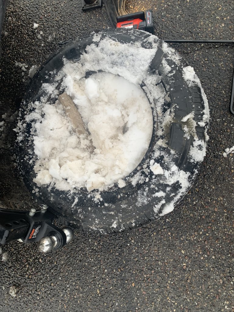

    Also, this would lend credence to the ice buildup theory..
    Yes, that’s the spare tire as I dropped it down. First time the truck has ever seen the spare come out and play.
    I planned on doing it at some point so that wouldn’t hurt my feelings.

    There's probably a ton of snowpack under your truck.
    My trip was one of the worst mountain pass blizzards I have ever driven. At one point, the tongue of the trailer was almost on the ground. It took us an hour to beat the ice off with hammers and shovels.

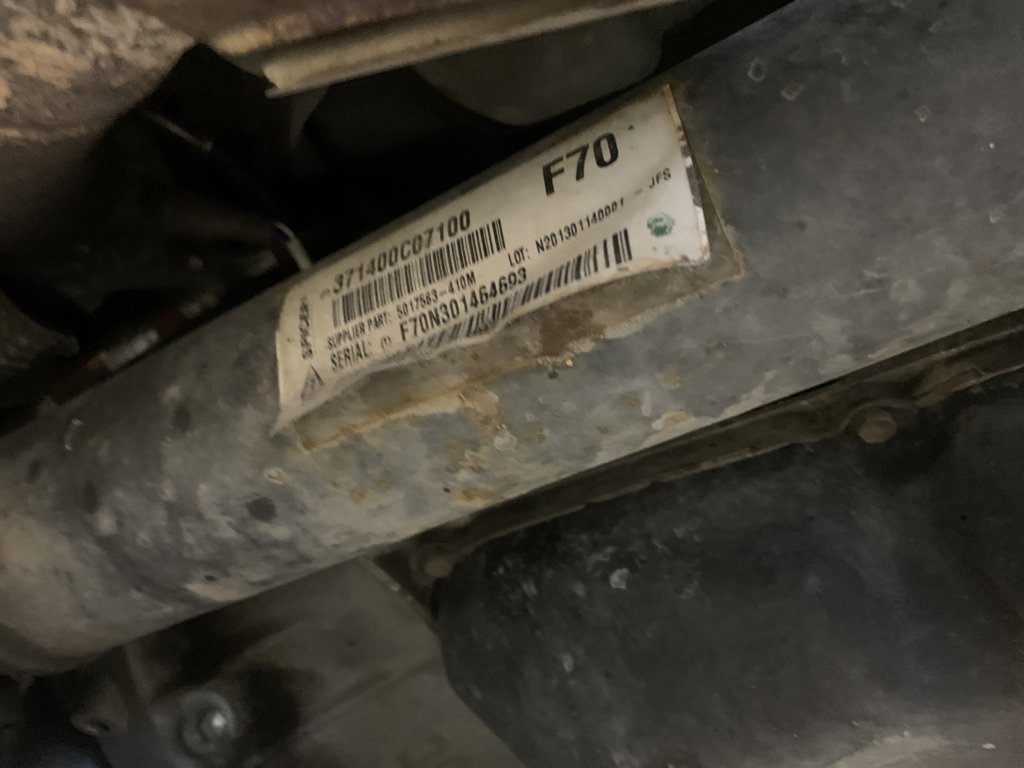

    Another clue… Stoopid sticker…
