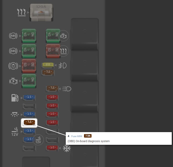

    After you check the fuse I'm about to point out, in the box next to the battery, if it looks OK, read this from @BubbaW and let's get to the bottom of whether the OBDII is correctly getting power, so we aren't flying blind: https://www.tundras.com/threads/obd-dead.131867/
    OBD power should be a 7.5A in the following location, I believe this is true for '00-'02:
