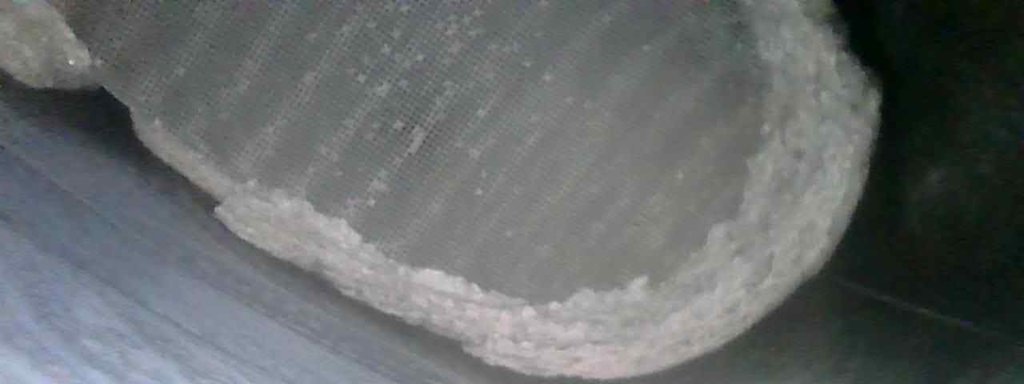

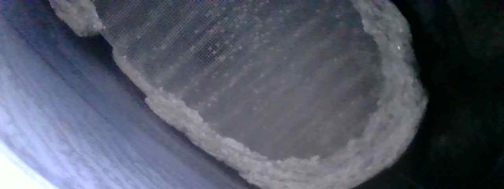

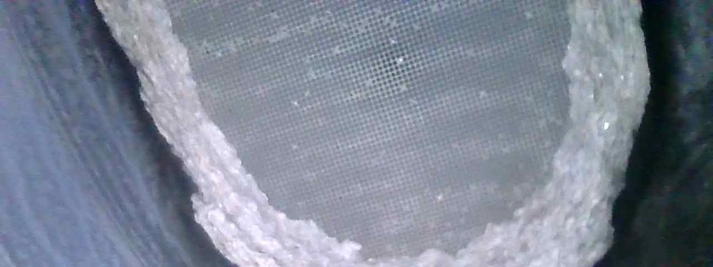

    Hey Im new here and was hoping for some advice on my catalytic converter. 2001 tundra 4.7 4wd. I am getting a rattling during acceleration which i believe is in the exhaust so i removed the the downstream 02 sensor (bank 1 sensor 2) and captured a few images inside the cat. The service card i got with the truck shows "both front cats" just under 60k miles ago, and it was welded onto the factory pipes so its aftermarket.
    I did this same test on the other cat thru Bank 2 Sensor 2 and the cat is hollow! No honeycomb, which is why i am getting the P0430 there.
    I am not getting a P0420, and my B1S2 reading are relatively stable but......any advise? Is that material buildup around the honeycomb normal, or is it melted, loose and boucing around in there causing the rattle i'm hearing?
    Thank you

    What makes you think it’s hollow? I see the screen mesh that’s supposedly the honeycomb or did you not post that pic?
    The white stuff I believe is the fiberglass mat. See video below as an example.
    https://youtu.be/bEiWcNrypxw?feature=shared

    the pictures i posted were from the driver side cat, bank 1. No codes coming from that side, just the odd rattle during acceleration which seems to change with rmp's.
    Since i was getting the P0430 i removed the bank 2 cat first because i was planning on cleaning it overnight in soapy water, but after scoping it on the bench i realized it was empty...no honeycomb. So i put it back together for now, expecting that code to be recurring until i buy a new cat for that side.
    nice video! Thank you
