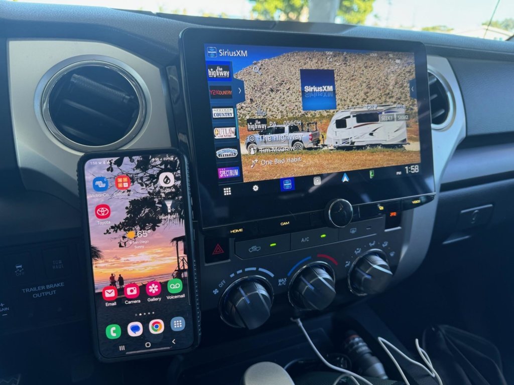

    Does it look like this?
    Mine did that for about 2 weeks a few years ago.
    It seemed to fix itself and hasn't done it since.
    You might try cleaning the connector in and under the tailgate.
    Good luck.

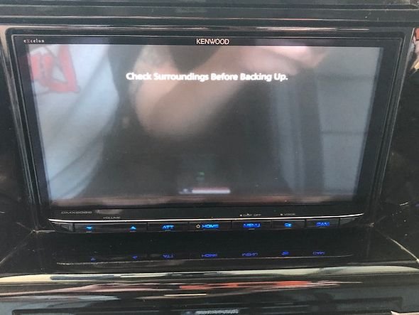

    Thanks for the reply. It's the stock standard screen (not Kenwwod) and is 100% black now. Got some pixelation after one attempt to clean the connector at the tailgate and then back to black it went. Might try a bit of dielectric silicone on the connector....
