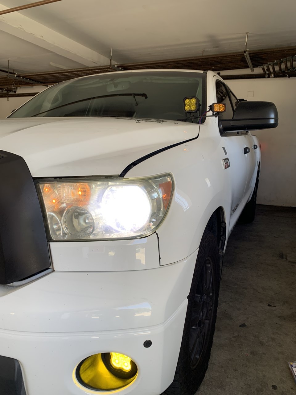

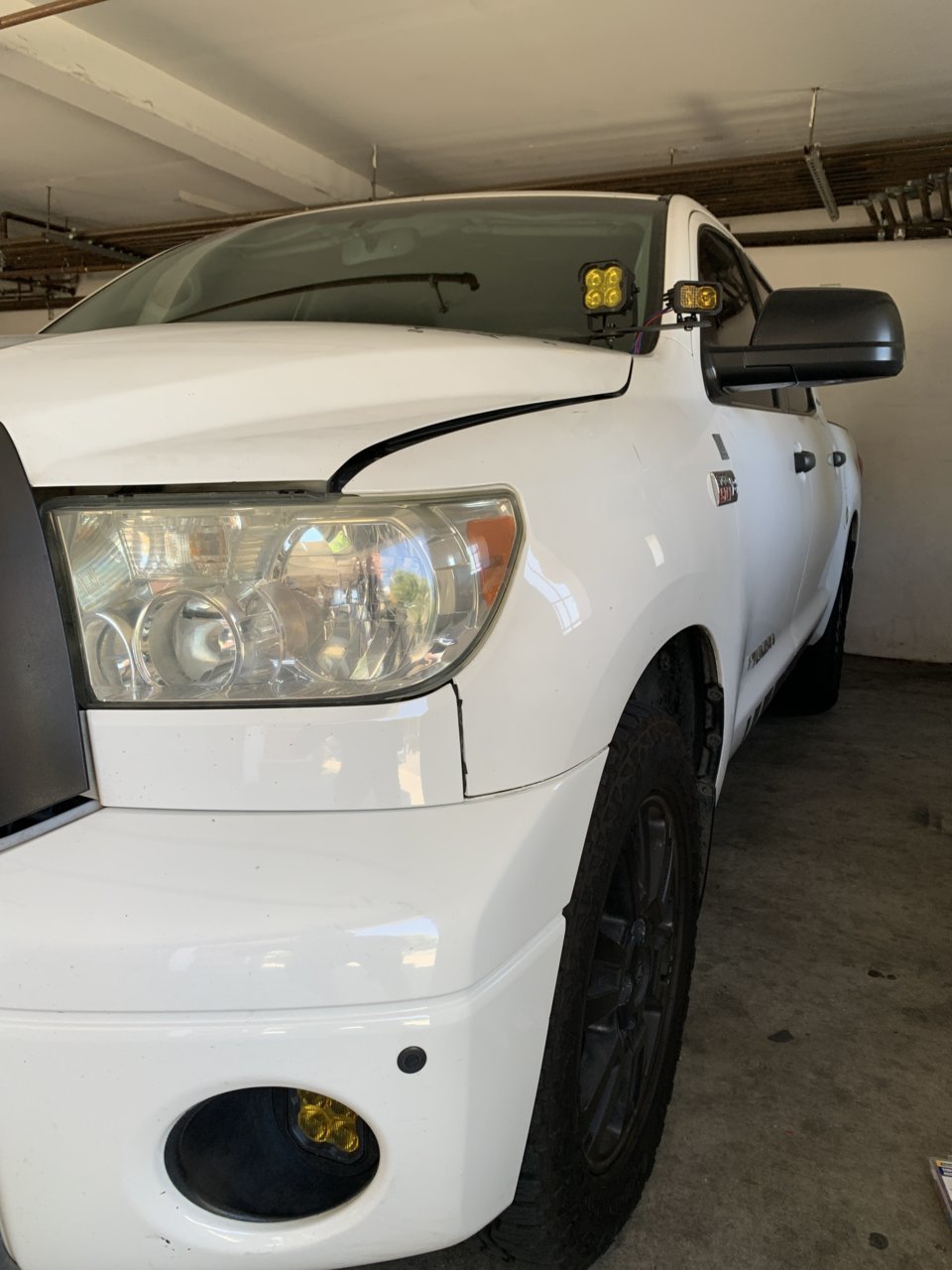

    Finally got around to installing diodes SSC2 and as suggested I hooked the lights to the headlight fuses with the add a fuse and the backlight works perfect!
    You guys are awesome! Thank you so much for the help!

    Looks awesome!
    Get some night shots too (If you can or want to*)
