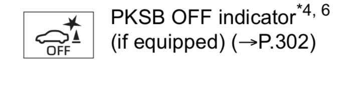

    Is this light on in your dash?
    If it’s not on, PKSB is still on. Maybe you’re pressing the PKSB off button but it could reset after cycling the ignition.

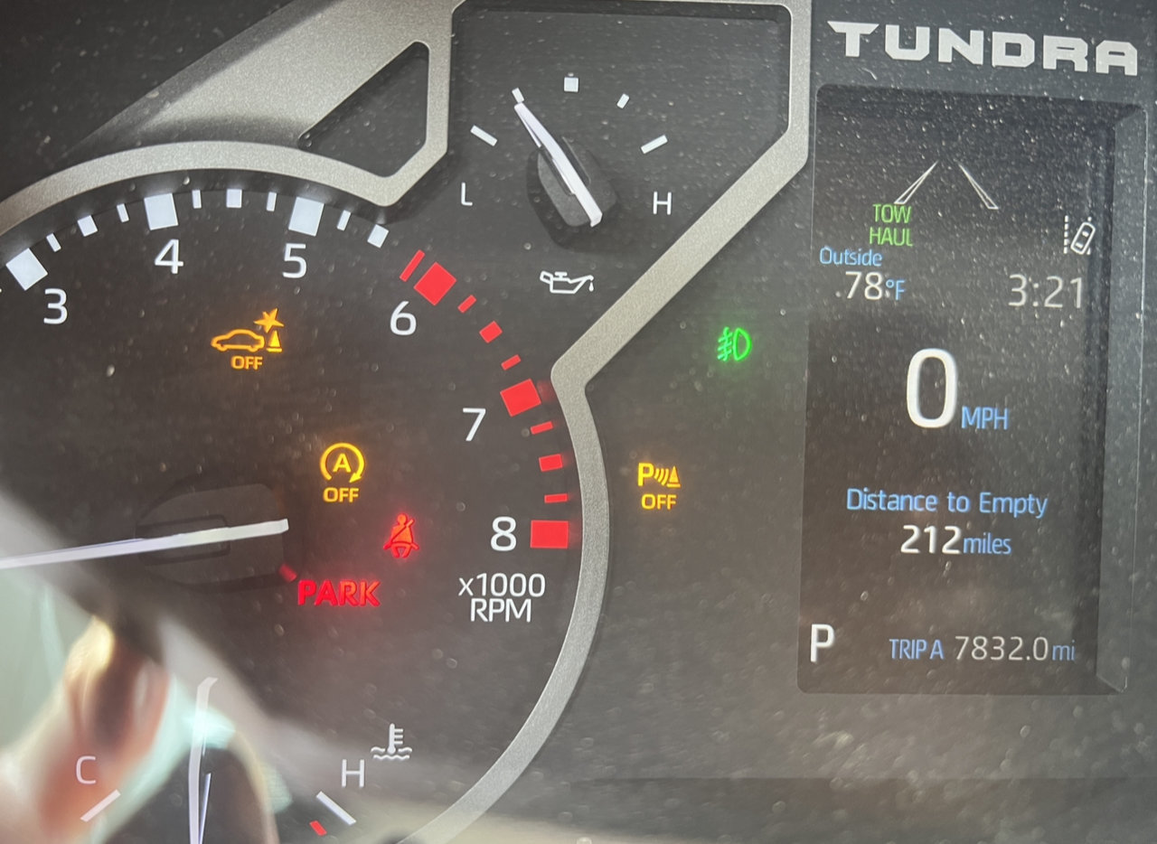

    Yeah, that light is on, among others…
    I’m feeling pretty confident that the test plug seven pin connector I just ordered from Amazon will hopefully work to 100% deactivate the rear sensors… I’ll definitely report back once I receive it on Wednesday…

    See below image…

    PKSB feature is definitely off and my truck slams on the brakes when backing my landscaping trailer ( using the 4 pin connector ), pretty startling to say the least; feels like hitting a stone wall. No problem whatsoever when backing my RV ( using the 7 pin connector ).
