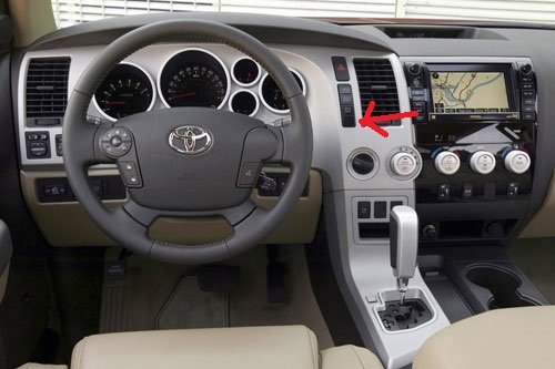

    There's a button on the dashboard on my Gen 2, the one on the bottom in the row of four buttons right of the gauge cluster. It's labeled "Sonar" it turns off the beeps from the front and rear proximity sensors.

    Right side of the steering wheel. Above the trailer brake whammy bar. Turn it off and you'll be good to go.
