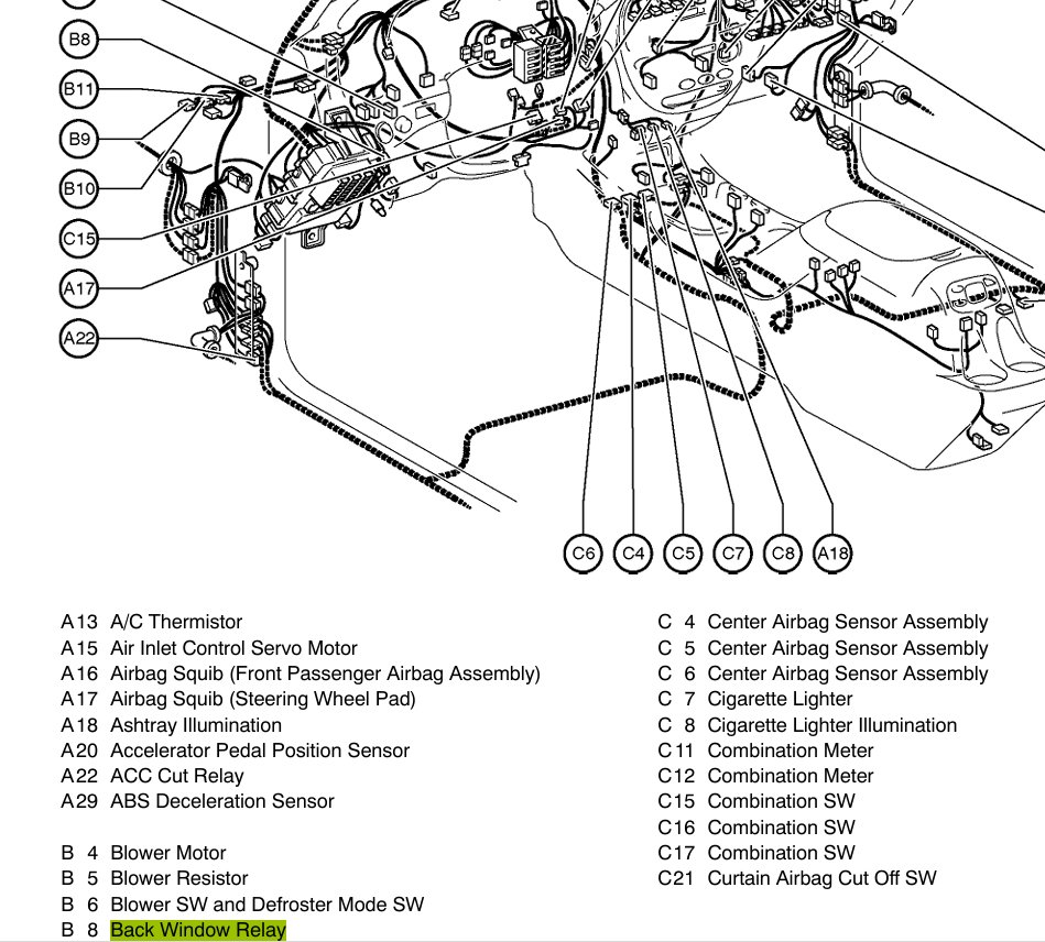

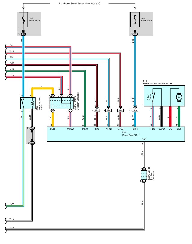

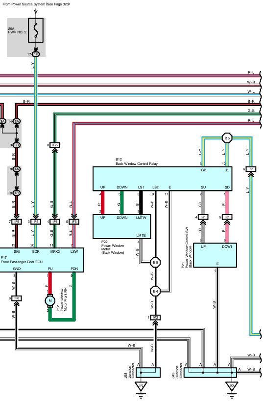

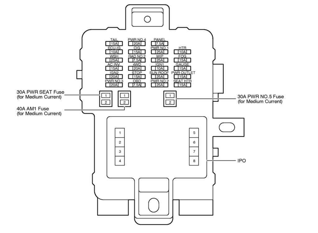

    Welcome to the forum..
    Wiring diagrams can be found here.
    Ultimate TUNDRA Wiring Diagrams Collection | Toyota Tundra Forum
    Check the PWR NO. 5 fuse, if it is good check the Back Window relay.
    Fuse, a big 30 AMP fuse, and relay will be in the underdash fuse box.

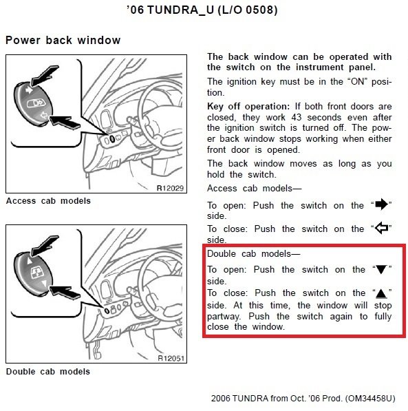

    For future reference year model, trim, and cab style were included.
    Only double cabs have a back window that goes down, but you knew that.

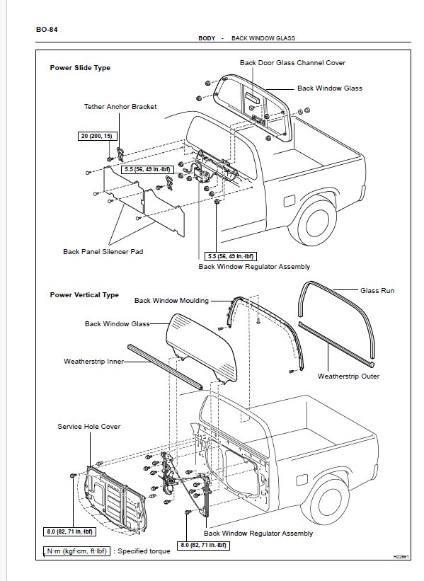

    I thought some AC 'side to side' sliders were powered? Not disagreeing with your general sentiment about being welcoming, but also not disagreeing with Black Mamba either. To me, the OP's post showed a sense of entitlement. Zero effort. Maybe I took it the wrong way too.

    I can’t answer OP’s question without knowing the cab type. AC had horizontal slider. DC had vertical. Process to troubleshoot is different on each. Also, knowing if other windows are dead may help too.
