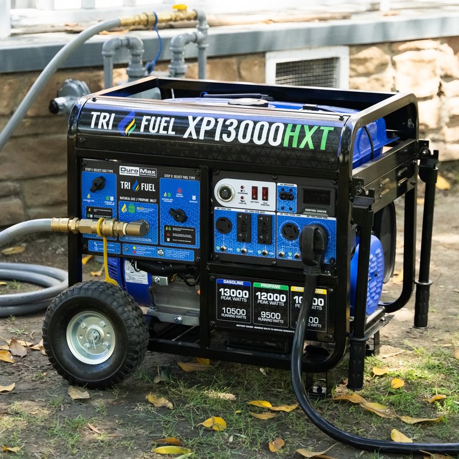

    With the frequent outages we've been experiencing, the wife and I are researching generator options. It's a hot blooded topic for me as our electricity provider is the only game in town so they don't mind killing us on rates while they do a piss poor job of maintaining their lines and equipment. That being said, I'm sick of pulling out our little portable and 4-5 extension cords everytime the power goes out.
    Generac has skyrocketed in price so that's not an option but I did have a nice chat with the salesman (fellow vet & metal music lover). The option most appealing to us is the semi-portable generator that can crank out 10-13k watts with a minor flip of a switch at the electrical box.
    We are looking at the Duromax line up and our electrician even recommended them to us. We would probably do the XP13000HXT as it is also natural gas friendly. We don't currently have NG but that'll be rectified soon (specifically for the generator). I plan to primarily run it on gasoline but in an extreme case, when gas is in short supply, it'll be nice to fall back on another ready fuel supply.
    Has anyone had first hand experience with them? TIA

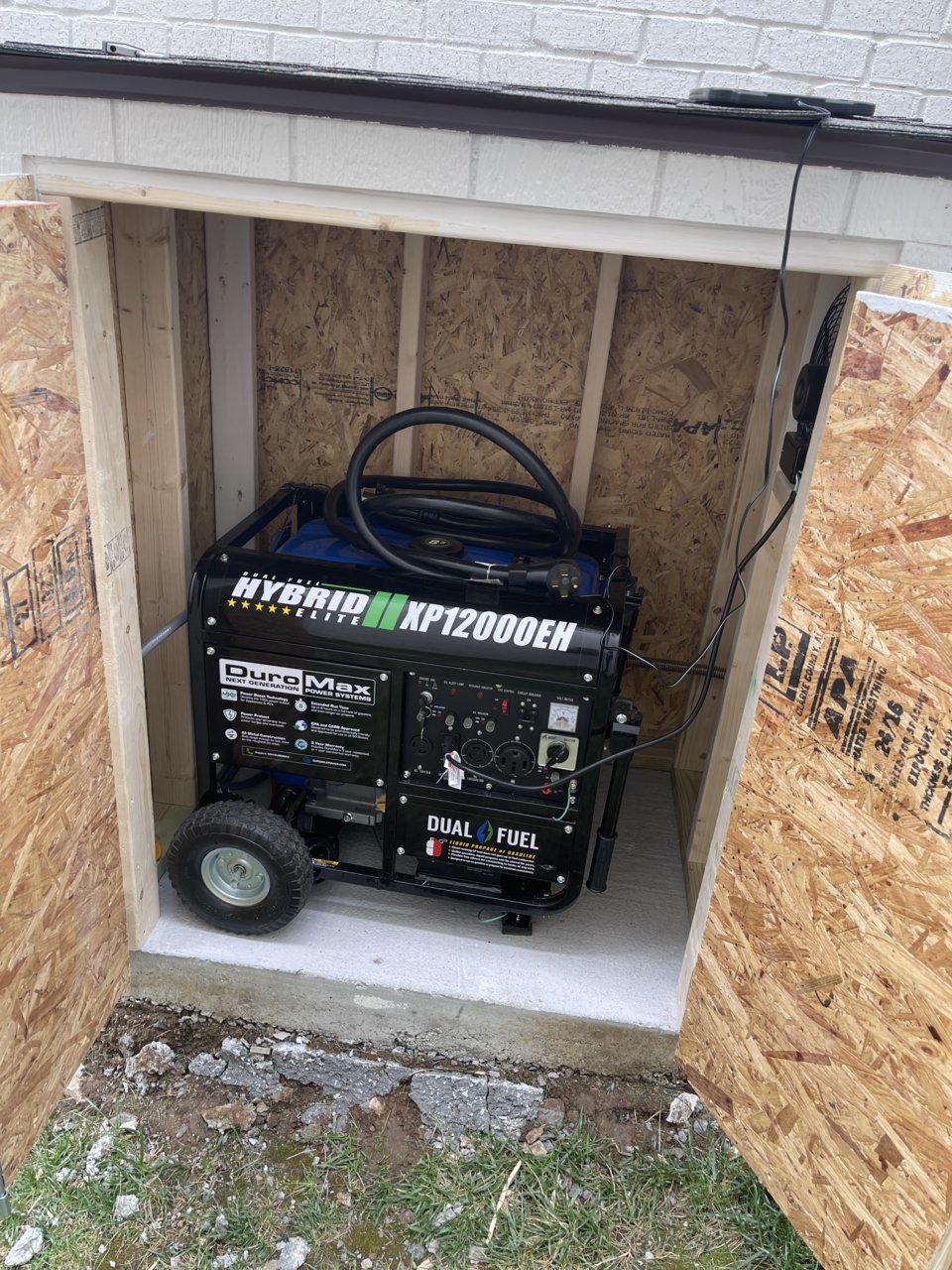

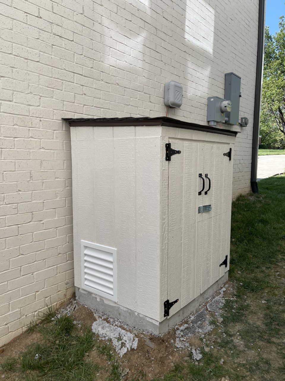

    2020 Tundra DC SR5 Barcelona
    Alot of them

  3. Sep 7, 2023 at 4:52 PM
