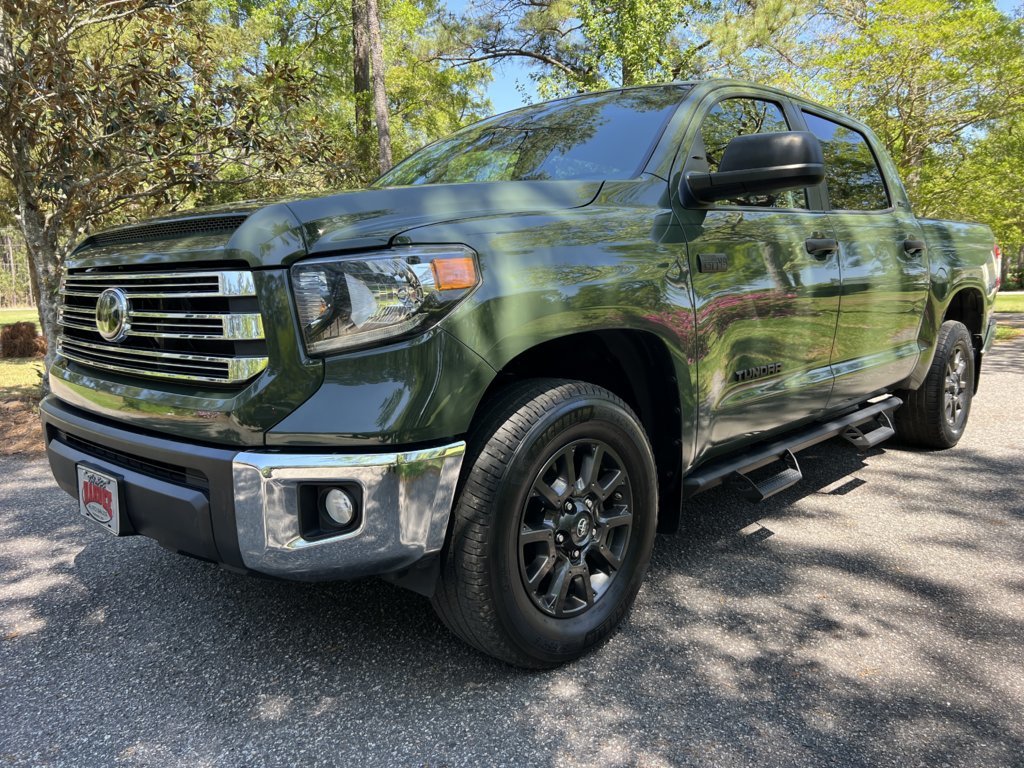

    I’m finally back in a Tundra after going from a Gen1 to Tacoma to 4Runner and now a 2021 CM SR-5 Trail Edition in Army Green.
    It’s good to be back. I’ve been searching this forum for weeks trying to determine my setup. No plans to get too far from stock but it does need a few upgrades on a tight budget.
    First off, I’m a photographer and I work daily out of a large Pelican case. I can see it’s gonna be a pain locking it in the cab multiple x a day but I haven’t found an convenient way to secure to bed and lock it. If I could I’d probably leave my bed open so I’m grudgingly looking it tonneaus to mainly to keep it out of sight and a little added security would be nice but I’ll be bringing it in with me every night or locking inside in higher crime environs.
    I think I’ve looked at every style in the market and I’m still going round/round as value/versatility is priority.
    I also know I’ll want a bed rack to haul kayaks, skybox, etc.
    For tonneaus I’m currently debating between the financial saving of going with a low profile soft rollup cover with t-slots like the Truxedo X15 Pro or a rolling hard cover like the BAK Revolver or Trux Sentry but all the moving parts I wonder how they hold up? Are they are really worth 2X the price for slightly more security?
    Any feedback about these covers or rack options I’m missing please let me know.

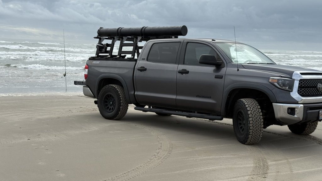

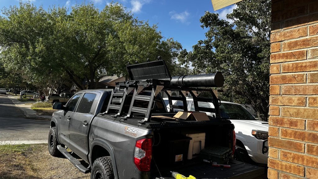

    I’ve had this Diamondback cover since 2017. I love it. A year or so ago I decided I needed a better way to haul my 2 kayaks. I ended up with a DYI solution and built my own bedrack using aluminum t-slot mounted to my bed over. Right now I’ve got an Apache case and a rod tube mounted on top and a mount for a propane tank on the side. The t-slot opens up a lot of options.

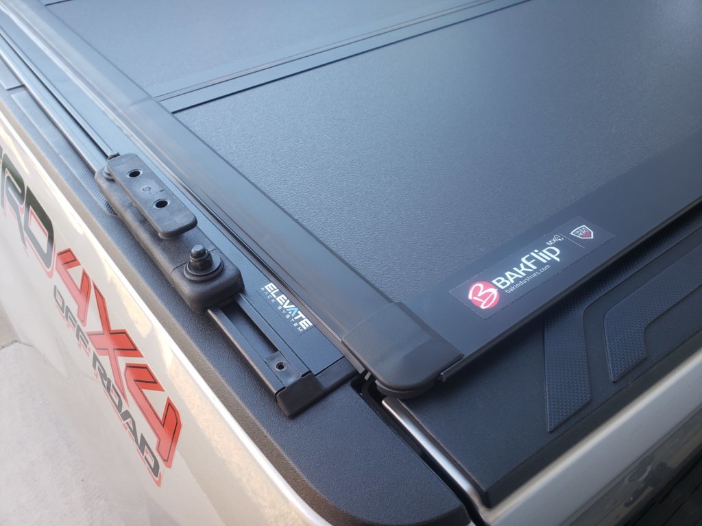

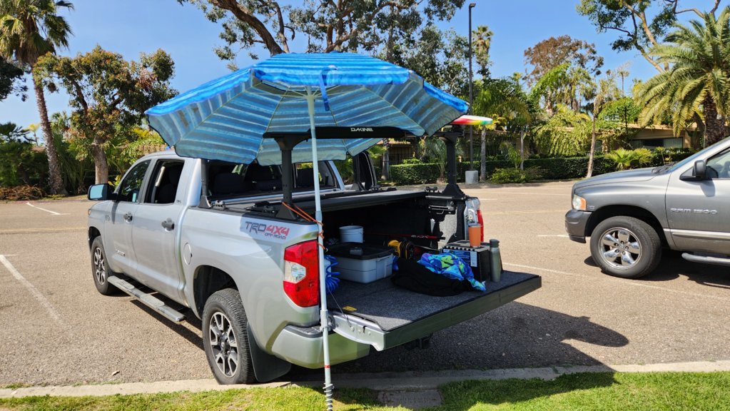

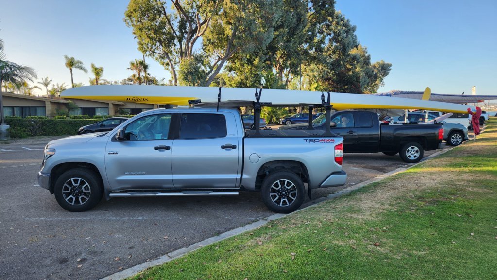

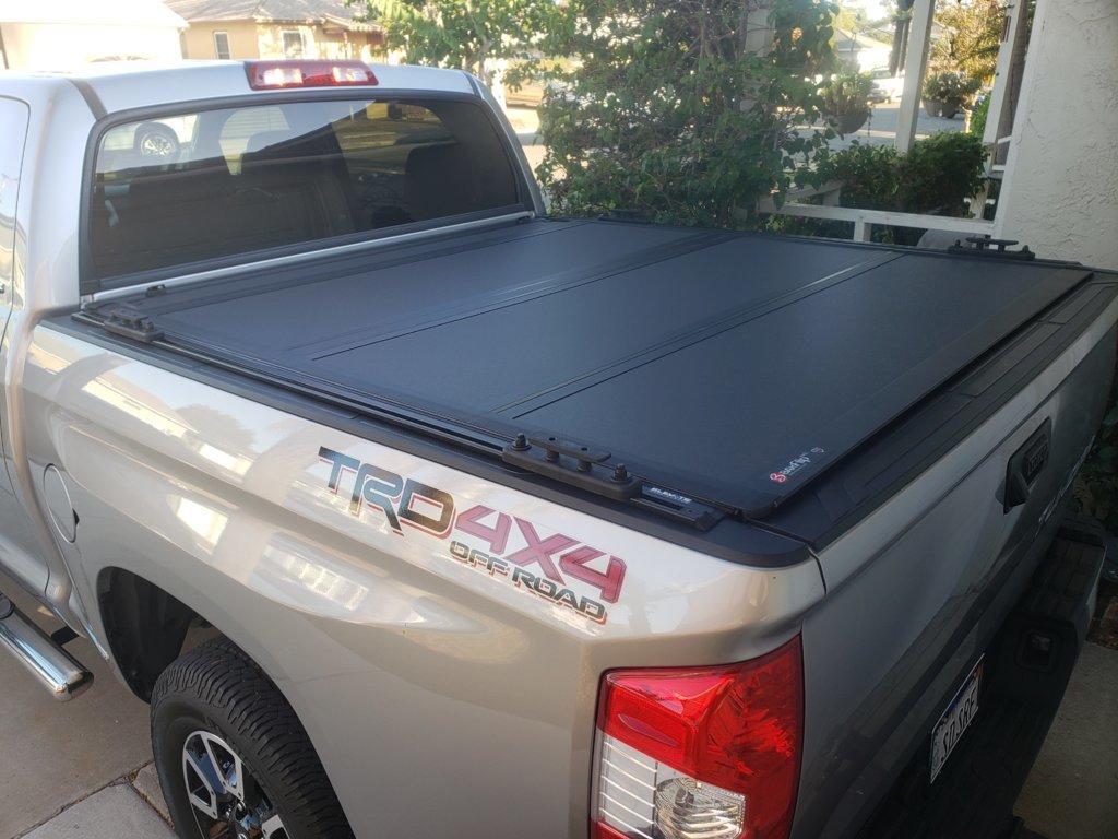

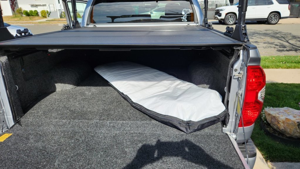

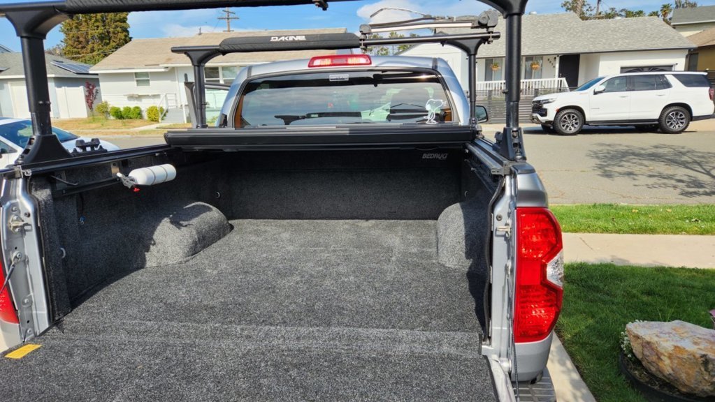

    It wasn't exactly cheap, but I'm VERY happy with my set-up of Bakflip MX4 and Elevate racks. I decided that I wanted a Tri-Fold rather than roll up or retractable, which greatly limited my options for running racks and being able to fold the tonneau.
    The Elevate T-Slot rails mount with the tonneau, and then the racks mount to the rails.
    Racks are rated for 750 lbs. static load, 500 lbs. driving, and 250 lbs. off road driving. I haven't put any serious weight on them... mostly water toys, but they're pretty stout.
    They come with HI/MED/LO holes
    Tonneau provides a little security to keep honest people honest, as with anything if a determined thief wants in, well... but at least it locks and nobody can walk by and see stuff in there.
    Between racks, tonneau, Bedrug, and lights, I'm stoked with how everything came together. Happy to answer any questions if you wanna' know more.

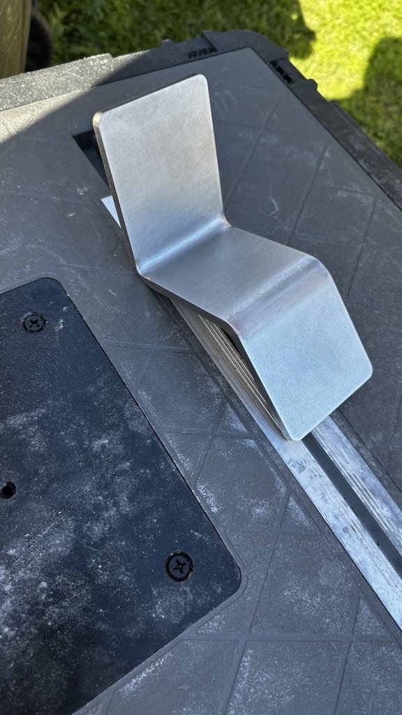

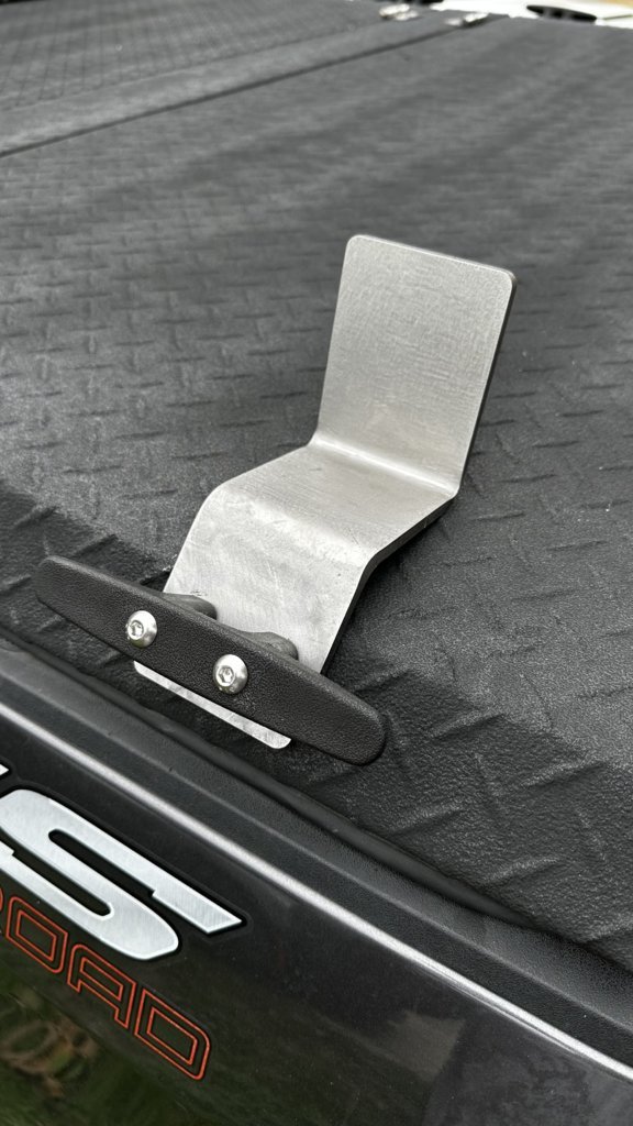

    That’s any impressive DIY setup. What t-slot tracks did you use. I’m leaning DB and debating whether I should go ahead and have them add the track that I’m not 100% I’ll utilize. I’d like to know it’s something I could do relatively easily later with less expensive options.

    100 lbs.?! :eek: Yikes. Yeah, that'd be a pain. Fishing Yak?
    Most of my toys, while cumbersome really aren't that heavy.
    The OC-2 outrigger is almost 28' long but the main hull (without the ama and iako's) is only a few lbs. more than my 14' SUP. I put slidy-sock things on the rear pads of it's V-Rack so I just get one end up there and then slide it forward.

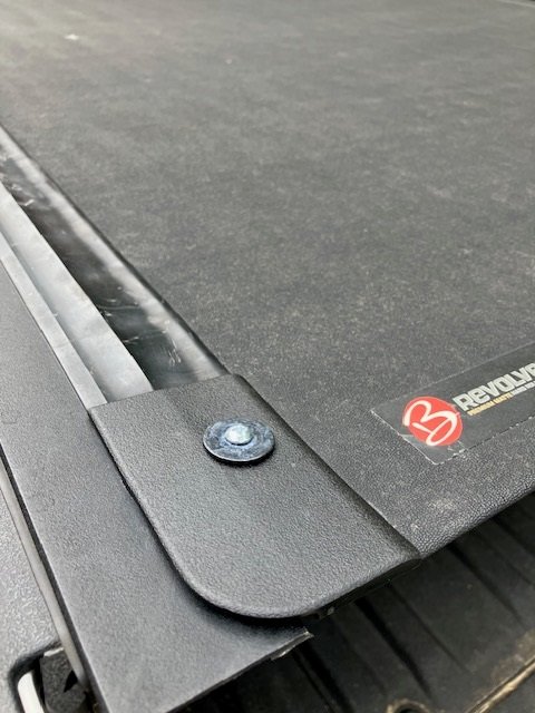

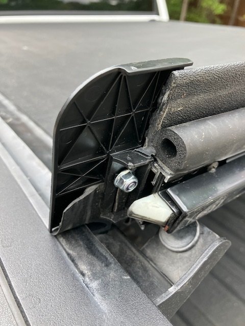

    I have the BAK Revolver. I cannot recommend it. The first one I received didn't sit flush and so they shipped me out a replacement (good customer service). The second one, the left latch has broken off. It leaks on the corners and the stupid corner pieces always break off. I modified mine by drilling a hole with bolts and washers just to keep the corner on. When I complained about the broken corners, they sent me like 8 of them, because they know it is an issue. Big design flaw.
    If I could go back in time, I'd get a Diamondback cover for sure.

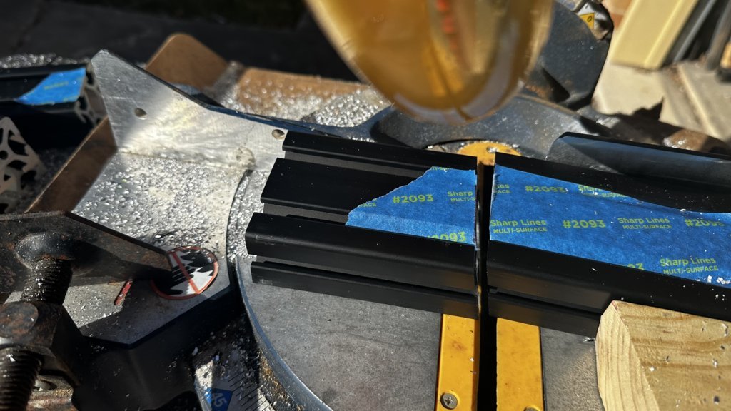

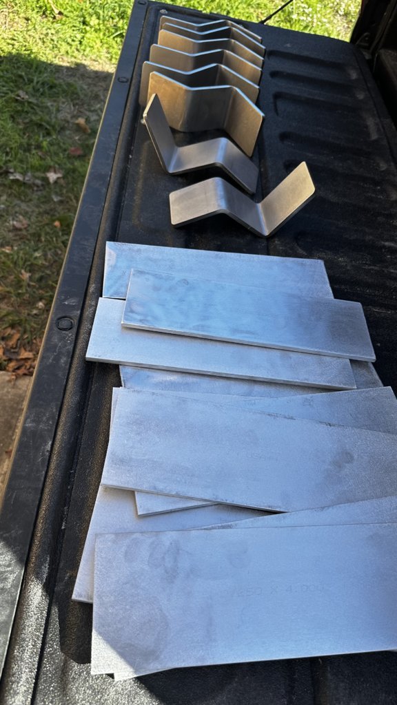

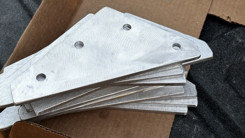

    The tslot is all 15 series extruded aluminum. Most from tnutz and some from 80/20. Hardware is all stainless. Brackets are mostly 1/4” aluminum. Some purchased and some I cut myself. I had some 1/4” stainless brackets made by SendCutSend and used those to mount to the cover.
    Test fitting the mount
