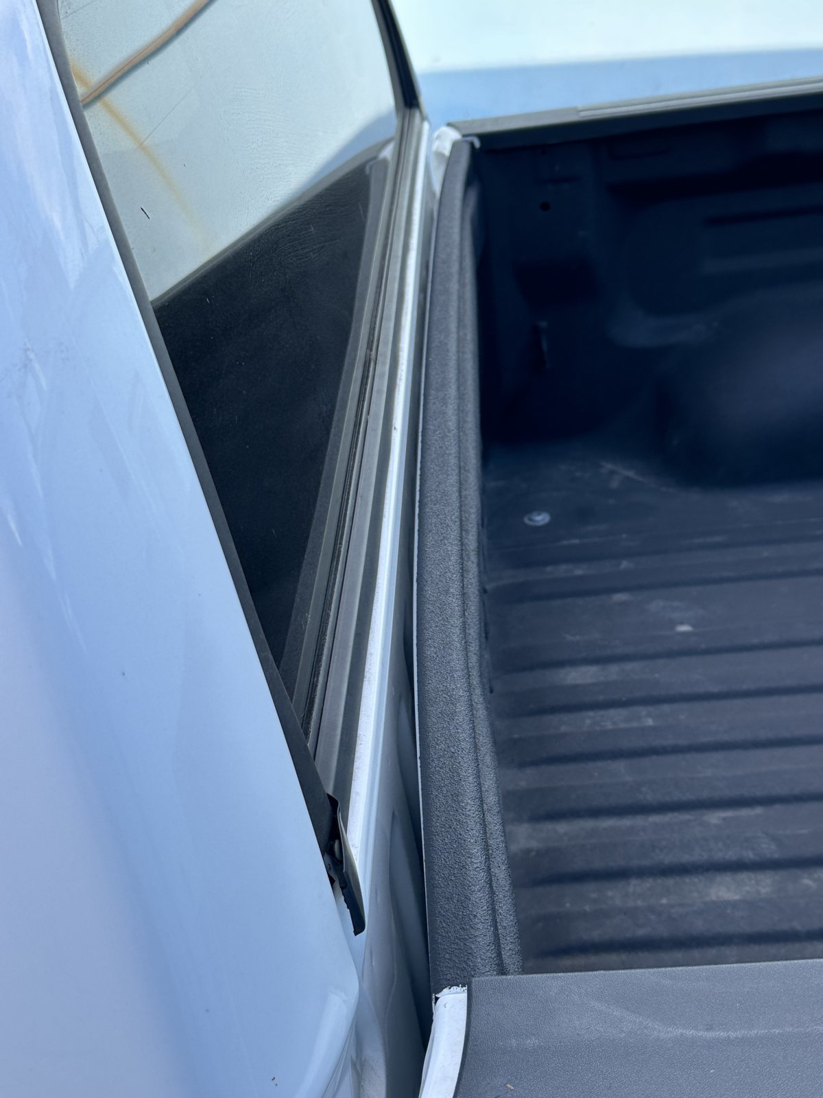

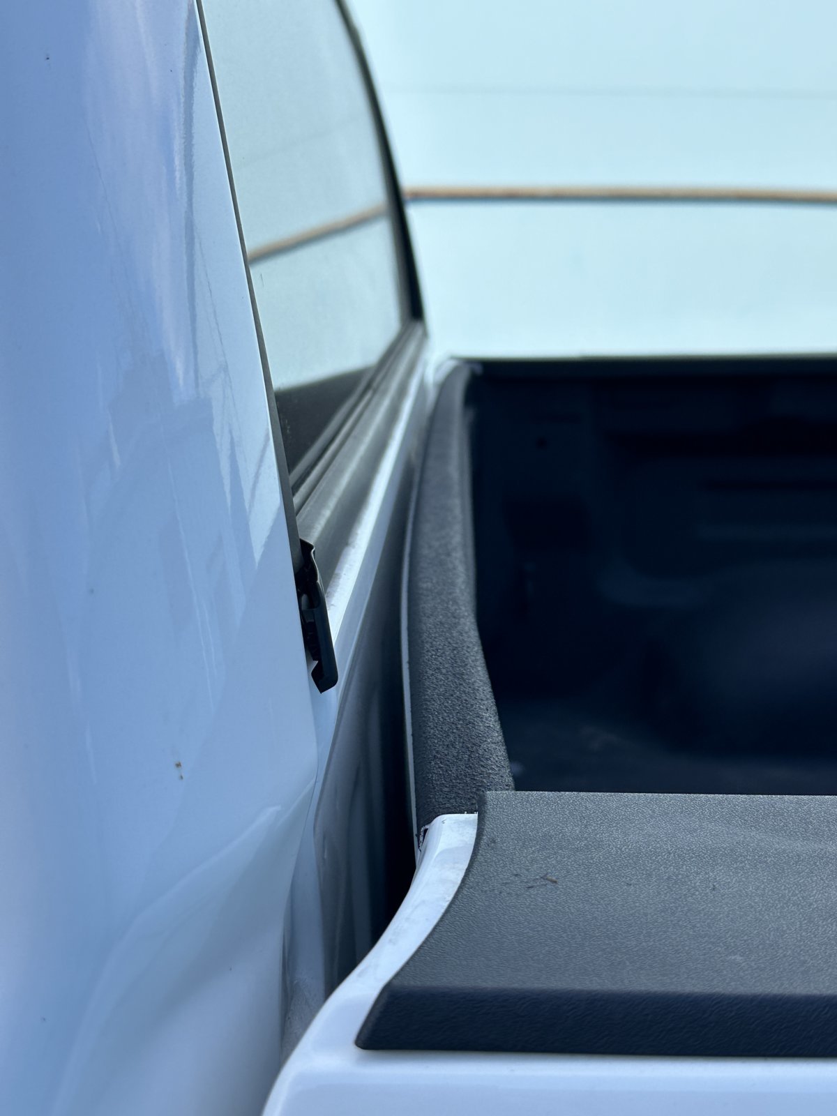

    Hello all. I am In The market to buy a new tonneau cover so I went out to measure my truck bed. I noticed that the back rail across the back cab has a bend in it. So my question is it supposed to be like that stock or did it get bent. I purchased this truck a week and a half ago and my first truck so I don’t know what to look for. I don’t want to buy a cover if it’s not going to fit properly. Thanks

    Yup, someone rammed an ATV or something hard against the front. Might be able to bend it back if you
    got creative without removing the box. To be honest, removing the floor bolts might allow you to slide the
    box back and get access to bend it back easier.

    Yep...definitely bent in 2 places.

    I think you can fix this yourself if you have a little HillBilly in you. You'll need a come along, some sturdy rope and two D ring tie downs.
    Fasten the two D rings on the rear most bed bolts and pull from them. Pop out the plastic plugs on the lower front bed. Drop the rope down between the cab and the bed and pull a foot or so through the hole where the plug was. Tie that end to something strong like a 6" piece if 1" dowel rod or a stick.
    Pull the other end with the come along tied to the D ring in the rear of the bed.

    My idea would be two pieces of angle on front and rear each upper edge and just about 4 C Clamps to
    pinch it back flat. Easy.

    Come to think of it a couple ratchet straps would do it.
