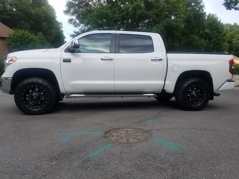

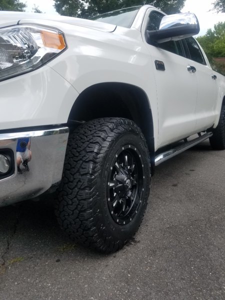

    Just finished. Damn truck dtill has the temp tag and i couldnt wait any longer. Thanks tundras.com. Billy 5100 all the way around. Fronts on the highest setting to level it. 18x9 Fuel Kranks wrapped in BFG A/T KO2s. 275/70/18s.(33in) Slight rub on the front mud flap which was removed and everything else clears perfect. It pulled some of the pep out of the truck compared to stock wheels and tires but I love the look and stance.

    Its level? Back end looks really low

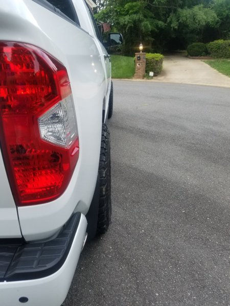

    Yeah those LT vs Pmetric are much heavier and stiffer.
    Hopefully there's no gravel or rocks in your daily path/travels. Those KO2's will be eager to introduce them to your wheel wells and doors. (Ask me how I know).
    The tires are worth it though. You'll be very satisfied. Looks great!

    That is exactly why I see a pair of RB20s in the not too distant future

    Probably just my camera phone... back fender (above tire) is 40" exactly. It was 39.25 before lift and tires. Rear fender is 8" above the top of the tire. Didn't use blocks or shackles. Front fender is 39.5" off the ground and sits 7-3/4" inches above the tire.
