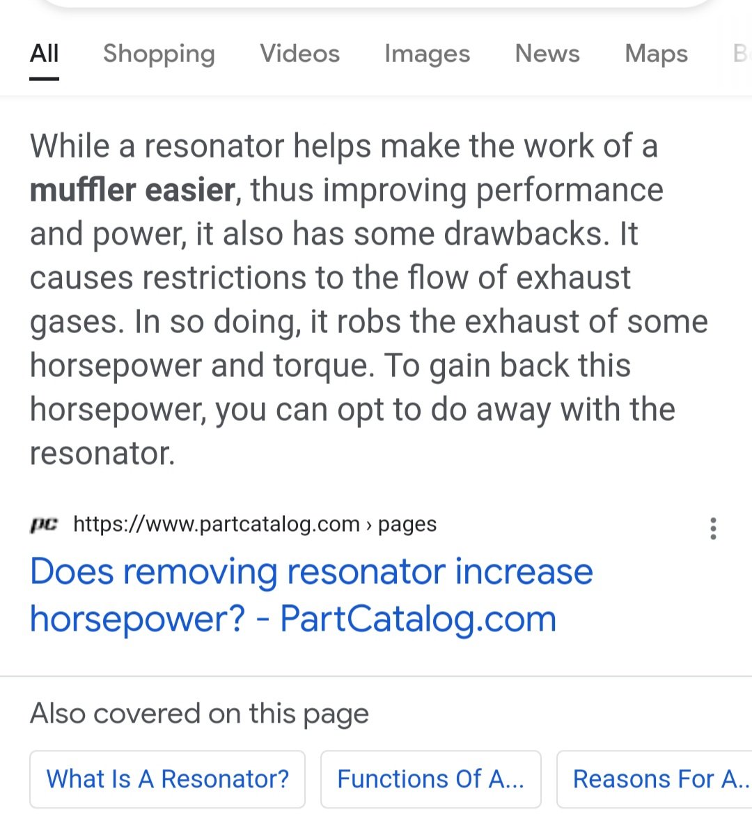

    Yea but who would want to restrict their exhaust flow and reduce hp/torque. I just didn't want a lot of cabin drone.

    This is entirely untrue. Most resonator do not restrict flow at all. Stock mufflers do, but a lot of high performance mufflers don’t, and almost no resonators restrict flow.
    Our Helmholtz resonator has 0 restriction. It only cancels 130hz. And does literally nothing else.
