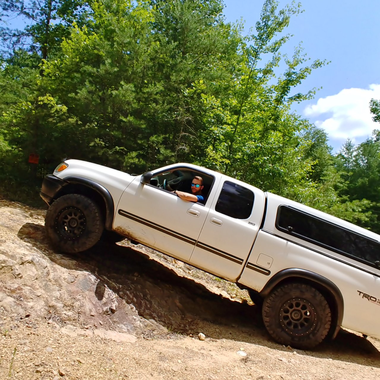

    1/5/2020

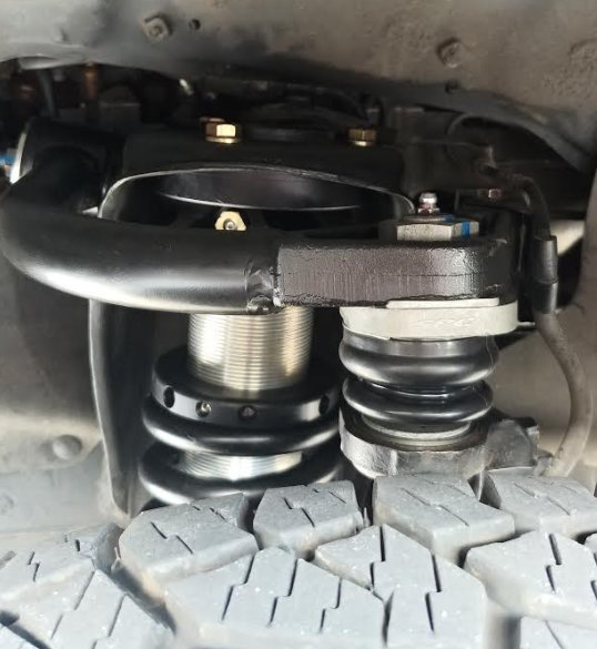

    Sorry Zac, I somehow missed this post. I've only had the SPC's a few weeks now but I don't have any complaints. I think a uniball option would be better for hard wheeling but these will suit my needs. These allow for proper alignment specs and the greasable ball joint will hopefully last a long time. If you're going to do the install yourself then you will either want to buy a proper ball joint press for our trucks or be prepared to remove the spindle. I wasn't prepared with the right tools and didn't want to remove the spindle. The ball joint kit you can rent from Autozone really isn't ideal for our trucks due to limited space.

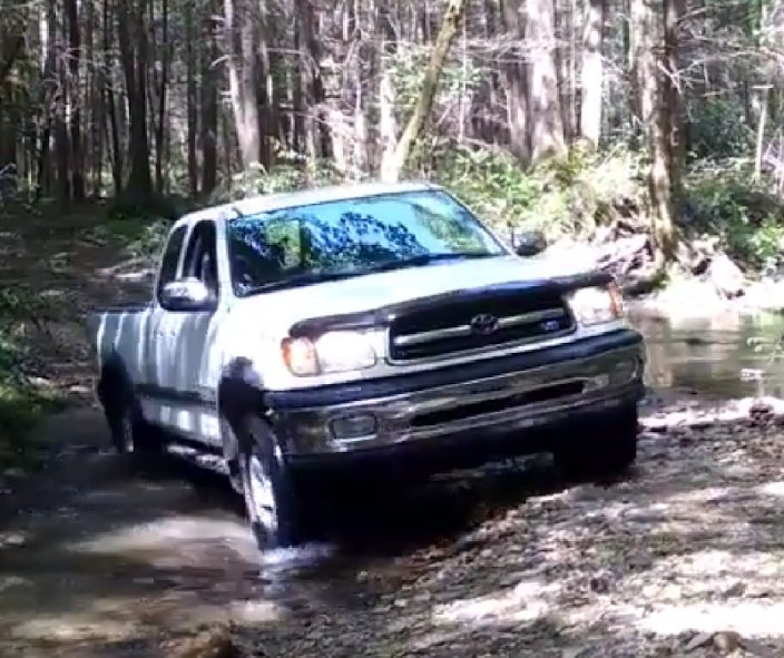

    My wife is great. We came up on a fallen tree and she jumped out and started pulling back branches so I could squeeze through. She's a solid co-pilot.

    I love the reverse water crossing pic!

    LOL. This is what happens when my wife forgets to hit record. I wasn't upset getting to go through it twice though. :D
