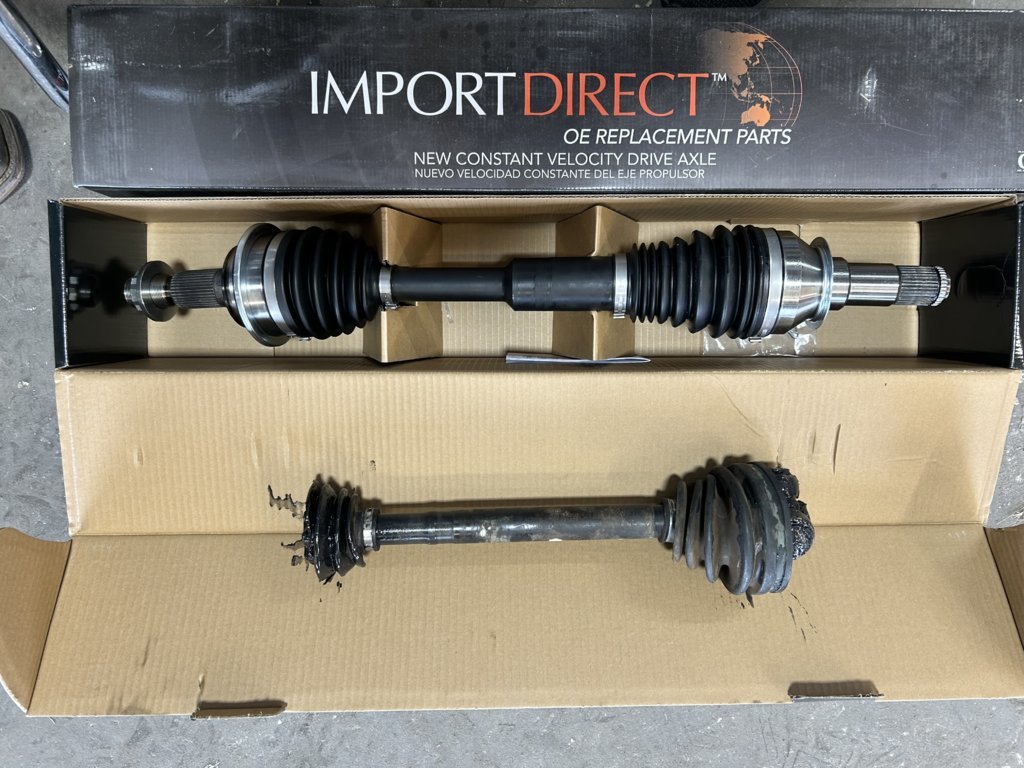

    Any idea why installing a new front axle would cause the hub to seize up? 6in RC lift has been on for a while. Front driver axle tapped out so tried to replace with an extended axle (Precision), but after tightening the axle nut, the hub seems locked up. It WILL drive but the hub heats up quick. Threw a brand new standard axle in and that locked up as well, so I have no idea what’s going on anymore. Any ideas?

    All of them, at first. Then tried doing the “right thing” and torqued to spec. Didn’t help.

    Did you install after market axles? The factory ones actually allow for a high degree of angle then aftermarket ones due to the joints they use.

    Tried extended CVs first. Then tried brand new stock. Both of them acted the same way.
