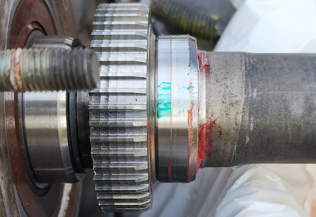

    I'm in the middle of a rear axle seal and bearing replacement on my 2002 Tundra SR5 Access Cab TRD, and I’ve run into what might be a damaged axle shaft. Hoping to get some input from folks here who've tackled this job before.

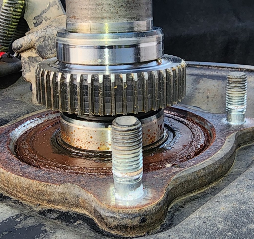

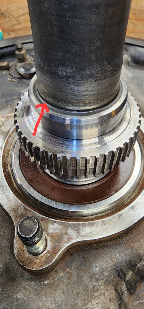

    • I realized that there is marring on the axle shaft from what looks like a previous bad repair job. It seems the previous attempt was done by cutting the bearing retainer with a grinder or something, and I suspect that marring on the axle shaft surface might be causing the press to bind. More importantly, is the axle still good?
    Here's a photo of the shaft with the visible damage:
    >> Click here for full-size image <<
    Questions for the community:
    • Is the axle still usable given the visible marring?
    • Could this interfere with bearing fitment or tone ring alignment?
    • Does this area affect sealing or long-term reliability?
    • Has anyone seen repeated loud pressure pops like this while using Duane’s tool and a 20-ton press?
    • Would light cleanup (sanding, emery cloth) be enough — or is this a replace-it situation?
    Any guidance or real-world feedback would be greatly appreciated. I’d love to avoid sourcing a replacement axle if I don’t have to, but I also don’t want to risk doing the job twice.

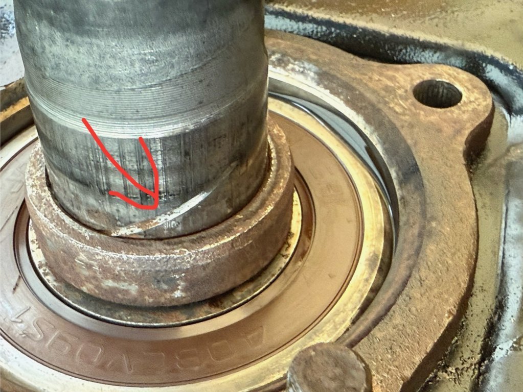

    Well it does look like the tone ring was cut off and the axle scored. How deep is the cut?
    Have heard of oil seepage under the inner retainer from scoring like it appears may exist lengthwise on that axle, but also heard of it being solved using like #2 permatex where the retainer mates to the axle shaft.
    The outer retainer looks rusty and extremly pitted (meaning it's been exposed to moisture). Was the axle shaft pitted and rusty there too? Perhaps that is causing friction so making it hard to remove.
    Here's what a 2023 OE axle with 200k+ miles looked like before disassembly. The outer retainer and axle shaft was not pitted with rust.
    Could consider applying some penetrating oil at the mating surface of the axle/retainer before retrying to disassemble. Once apart could fully access condition of the axle.
    If decide to replace and can't find a good OE axle, seem to recall someone replacing their axle recently with aftermarket, so maybe they can share more info.

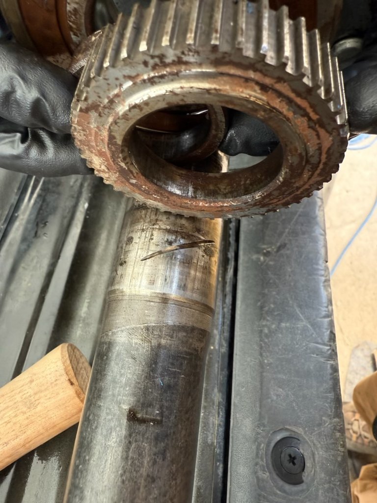

    When i helped @bmf4069 with his axle, i’m pretty sure the retainer popped, then came off smoothly. Maybe a file and some sanding would help yours, but i’m not sure i’d be comfortable running an axle with a stress riser like that. I’d find a whole axle housing from a jy and swap it (as long as its not caked in grease) instead of buying just an axle shaft, i think frank got his for $150 or so.

    I think you're probably correct that the binding is being caused by inconsistency on the shaft surface, but wouldn't be at all concerned about it. Keep pressing. When you get it off, inspect the surface for any high spots. How far is the end of the groove from the end of the machined edge?

    Seems it's a few mm deep. I can measure in the morning and share.

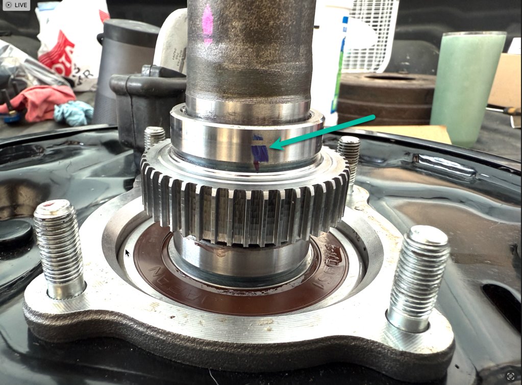

    It looks like the inner retainer in the picture is installed too far outward not within like 3-5mm of the machined edge, but it's just a picture so maybe it's actually setup correctly. Might be able to reposition the retainer if needed. Don't know what bearing they use.

    I don't think you need to replace the axle. (as long as the groove doesn't extend to the edge/past the edge of the ABS retainer)
